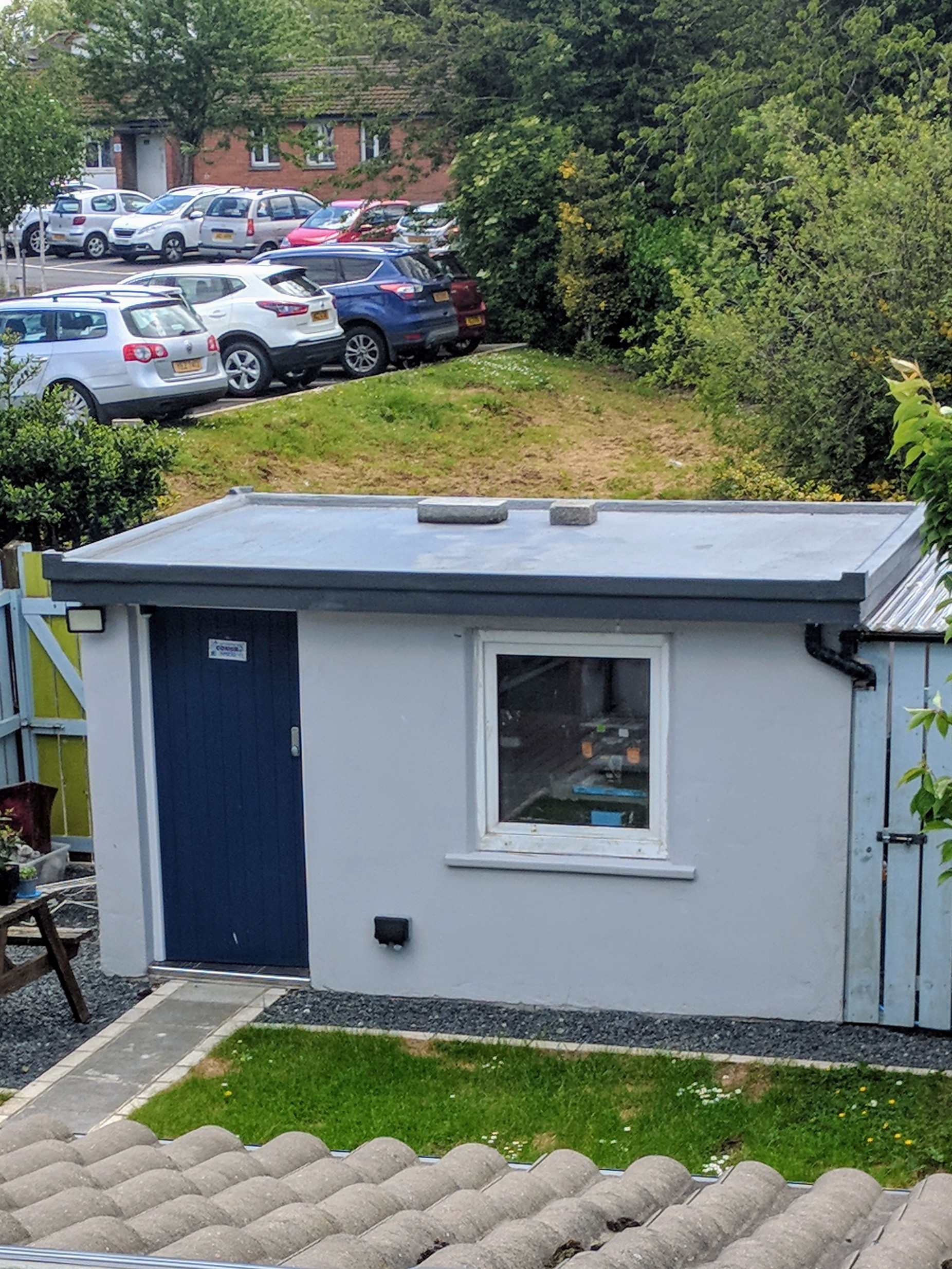

Wantage Cherry Posted 19 hours ago Share Posted 19 hours ago Hi, in the middle of building a garden room for my son and need all the help/advice I can get! Link to comment Share on other sites More sharing options...
Conor Posted 19 hours ago Share Posted 19 hours ago One issue, needs to be made out of largely noncombustible materials within 1m of a boundary.... So I assume you'll be cladding with some sort of fire resistant boards? Link to comment Share on other sites More sharing options...
Wantage Cherry Posted 19 hours ago Author Share Posted 19 hours ago Hi Conor, the plan is cedar cladding. Link to comment Share on other sites More sharing options...
Conor Posted 19 hours ago Share Posted 19 hours ago (edited) That'll be a building control fail and you might be asked to remove the building (if you are reported and it's enforced). Assume flat roof? Looks like it might be a tad over the max height of 2.5m? I'm assuming this is like a garden office / workshop and otherwise building regs exempt? Edited 19 hours ago by Conor Link to comment Share on other sites More sharing options...
Wantage Cherry Posted 19 hours ago Author Share Posted 19 hours ago Hi, the building is within the 2.5m so intended to be building regs exempt as you say. Link to comment Share on other sites More sharing options...
twice round the block Posted 19 hours ago Share Posted 19 hours ago 5 minutes ago, Wantage Cherry said: Hi Conor, the plan is cedar cladding. That is a flammable material. What is the height of the building? as that looks extremely high against your neighbours fences. Where is the rain water going to go? you've already paved over an area of your garden. You may want to get some advice on this build before you proceed any further. Link to comment Share on other sites More sharing options...
Wantage Cherry Posted 19 hours ago Author Share Posted 19 hours ago Hi, the building is 2.4m high. Rain water will be to a soak away within the garden, more than 5m away from the existing house and build site (the picture doesn't give the overall view of the garden and its length) Link to comment Share on other sites More sharing options...
Conor Posted 19 hours ago Share Posted 19 hours ago (edited) The spread of fire element seems to be the biggest issue to address, which can be done with the right cladding and roof material. Otherwise, looks to be well made. Keep asking questions! I needed up making mine out of concrete blocks with fire retardant fibreglass roof to comply. House since sold, and new owner uses it for his laser etching hobby/business. I did a basic soakaway to the RHS for the roof drainage. Worked well. Edited 19 hours ago by Conor Link to comment Share on other sites More sharing options...
garrymartin Posted 17 hours ago Share Posted 17 hours ago If the *internal* floor area is less than or equal to 15m2, even within 1m of the boundary, the "substantially non-combustible materials" element does not apply. Link to comment Share on other sites More sharing options...
Wantage Cherry Posted 16 hours ago Author Share Posted 16 hours ago Thanks Garry, that's my understanding. Link to comment Share on other sites More sharing options...
