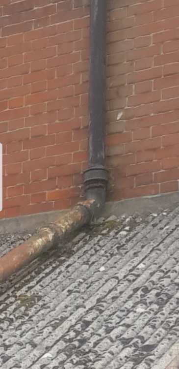

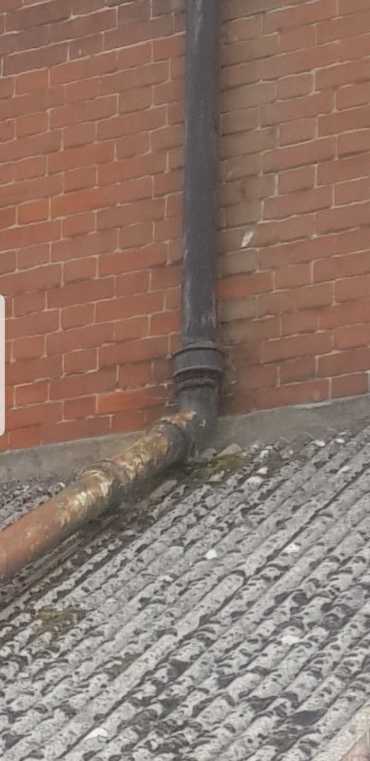

mreinor Posted October 13, 2024 Posted October 13, 2024 I have an existing soil stack which I can't get lead flashing behind. Any suggestions? See pic, the corrugated asbestos has now been replaced with slates, and I need to add flashing along the top.
Alan Ambrose Posted October 14, 2024 Posted October 14, 2024 Err, remove the pipe, flash, put the pipe back with suitable standoffs?
