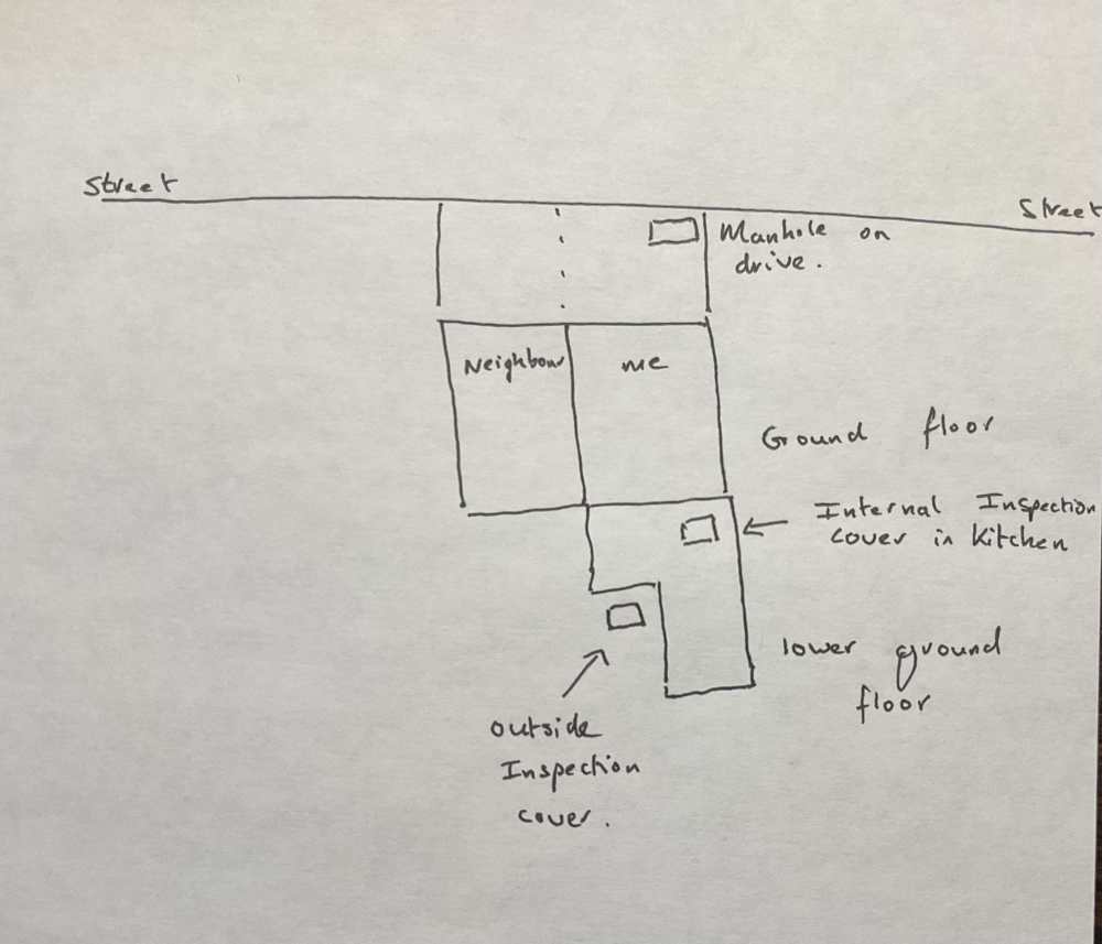

Thanks Crooksey. This is really helpful. Nothing like this had occurred to me. If you don’t mind , could you take a look at picture below. Do you think the internal inspection drain in the kitchen would be the place to is install something like this? This is the cover closest to the deep manhole cover on the drive.
Thanks again for taking the time to reply to this.
It won't work on the IC in the kitchen, probably flows from there to the one on the drive (easy to test).
It would need to be on the last IC before the property, so it does't allow backflow.
Hi Crooksey, thanks for getting back to me again. The neighbour and I use to be one property. Their loo etc flows to inspection cover outside my back door, which then journeys down to the inspection cover in kitchen and then down to street/drive. The manhole on drive is super deep. My question is why would the IC in the kitchen not work? If the non return valve is there. wouldn’t the water would just back up to drive manhole? It’s really deep. From one inspection I had done I could see  The outflow pipe in manhole is set  right at the bottom of manhole which is why it gets overwhelmed when flood water from street drains into it. I’m probably being really slow here, but I can’t see how you’d install a return valve there. Again,  thanks again for replying.
because if you add the NRV in that manhole in the house, it would only work up to the "back" edge of the inspection chamber, water that entered the mahole next to the road would still back fill into the IC in your kitchen.
If you fitted the NRV i posted into the IC in the kitchen it would be the wrong way round, and effectively block that IC from passing effluent into the manhole in the road.
If you are not confident doing it, I am sure a local drainage company would be able to assist. It cold also be that the manhole in the driveway needs replacing with an "air tight" one, this will ensure no flood water enters it.
It may be worth getting a CCTV survey just to check there is nothing un-toward.
I see you are in Surrey, I am not affiliated with them, but I use "Totally Blocked" for all my CCTV surveys and any patch repairs that need doing. https://www.totallyblockeddrains.co.uk/.
