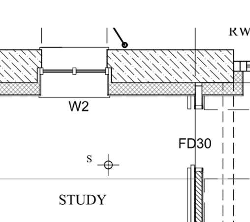

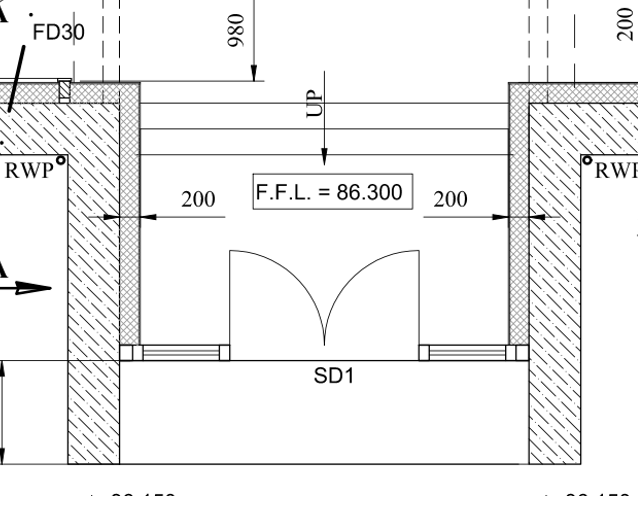

mickeych Posted September 23, 2024 Share Posted September 23, 2024 We have 185mm of Celtex each side of our stone openings which we will be fitting aluminium frames into. Has anyone had any experience/have suggestions as to the best way to deal with insulting up to the frames? We clearly want to avoid seeing the edge of the insulation from the outside, so what are the options? Link to comment Share on other sites More sharing options...
Mr Punter Posted September 23, 2024 Share Posted September 23, 2024 A drawing may be useful. Is it stone with insulation behind then a frame / blockwork? Is it new build or conversion? Link to comment Share on other sites More sharing options...
mickeych Posted September 23, 2024 Author Share Posted September 23, 2024 Sorry yes of course. It's original stone with membrane on top then studwork containing the in insulation layup. Link to comment Share on other sites More sharing options...
mickeych Posted September 23, 2024 Author Share Posted September 23, 2024 These are the large screens with double doors at the front elevation. and this and the rear elevation carry the most insulation Link to comment Share on other sites More sharing options...
mickeych Posted September 23, 2024 Author Share Posted September 23, 2024 The windows are also tricky... Link to comment Share on other sites More sharing options...
mickeych Posted September 23, 2024 Author Share Posted September 23, 2024 Old stone barn conversion so no blockwork only 500mm stone walls with no cavity Link to comment Share on other sites More sharing options...
