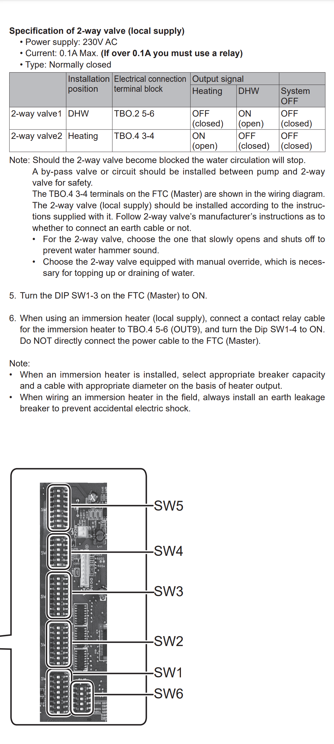

sharpener Posted November 29 Share Posted November 29 On 20/09/2024 at 12:09, Helene said: Hello. I've noticed from our melcloud graphs that every time the heating is on, the DHW heats up too. Which I confirmed by touching the flow pipe going into to the cylinder. Is it normal? I'm worried it's affecting the performance of the system and costing us more than it should. We have a mitsubishi zubadan 14W and a unvented cylinder. Thanks in advance for any advice. N.B. the company who installed the system less than a year ago has folded so it's not an option to come back to them. I think your original post sums it up exactly! However there are some tests you could still do to help diagnose the problem. This will save some electrician time on site as the tests are a bit time-consuming: Identify which valve is which. Check which valve moves under what circumstances. As upthread, the manual lever will go floppy when the valve is actuated. You cannot normally hear the valve opening but when the power is removed it whizzes shut with a very distinctive sound (which can be transmitted down the pipework over long distances, I can hear a valve in the loft shutting from the plant room). In heating mode does the weather compensation work i.e. does the pipe to the heating circuit get hotter as the weather gets colder? This is the important thing to verify as it will affect the running costs. In HW mode is the flow to the cylinder properly hot (hotter than in heating mode) and does the heating pipe also get hot? If so it is wasting energy. Link to comment Share on other sites More sharing options...

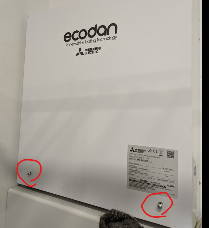

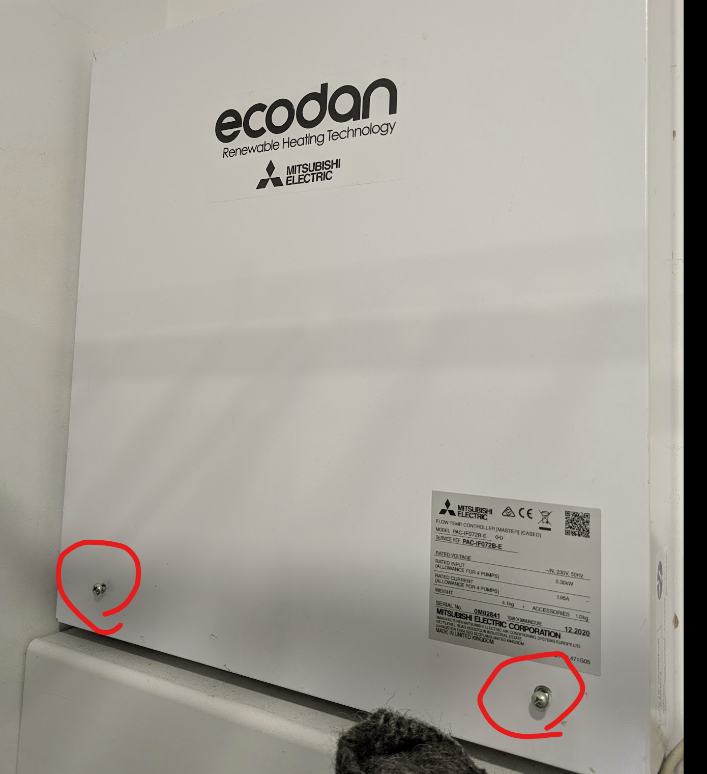

joth Posted November 29 Share Posted November 29 (edited) Your ecodan is driven by an FTC6 controller, white metal boxy thing. If you're comfortable taking the cover off that and getting some photos of the innards it should be possible to diagnose if the valves have been connected up incorrectly. The FTC has 2 complimentary outputs for dhw / heating switch over. In S plan with two normally closed valves you should see one wired into each of those outputs They're labelled OUT4 and OUT13 on the PCB because why have one numbering scheme when you can have two? Edited November 29 by joth Link to comment Share on other sites More sharing options...
Helene Posted December 1 Author Share Posted December 1 On 29/11/2024 at 09:42, joth said: Your ecodan is driven by an FTC6 controller, white metal boxy thing. If you're comfortable taking the cover off that and getting some photos of the innards it should be possible to diagnose if the valves have been connected up incorrectly. The FTC has 2 complimentary outputs for dhw / heating switch over. In S plan with two normally closed valves you should see one wired into each of those outputs They're labelled OUT4 and OUT13 on the PCB because why have one numbering scheme when you can have two? Thanks for the advice, happy to give it a try. Should I turn off the pump completely before opening or there's no risk? I see 4 screws on the cover, I guess it's as simple as that? Hopefully... Link to comment Share on other sites More sharing options...
joth Posted December 2 Share Posted December 2 If you're reasonably competent / careful (i.e. keep fingers off connections) it's safe enough to do still powered up, but really no downside to shut it down first, esp if it's the first time you've poked about inside it. While open it'd be worth tracing each of the cables back to unambiguously identify which pump/valve is connected where. You only need to remove 2 screws, on the bottom edge of the front face. Link to comment Share on other sites More sharing options...
