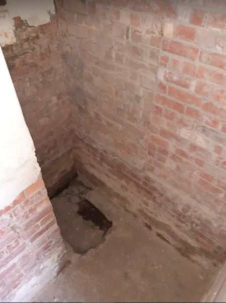

Night Owl Posted August 31 Share Posted August 31 Looking for a few pointers in regards to the old boiler room in my house (1950's bungalow) which would have been originally solid fuel. It is approx. 3.28m2 and was constructed partally below ground for some reason but has long been removed. The floor level in the cellar is about 800mm below (slate) DPC and usually has between 6 and 12 inches of water in it during the winter months. Picture above was taken today where it has all but finally dried out. I want to bring the floor level up in this room to match the rest of the house, so approx. 800mm needed. My thought was to get a concrete company in to pour waterproof concrete to approx 300mm below dpc (1.64m3). Install DPM, insulation 200mm, 50mm concrete then screed to existing floor level. Can anyone see any issues with this approach or suggest a better (easier) way? Would also be interested to know why it was built below ground level. Thanks. Link to comment Share on other sites More sharing options...
dpmiller Posted August 31 Share Posted August 31 was there a coal hatch somewhere? Link to comment Share on other sites More sharing options...
Night Owl Posted August 31 Author Share Posted August 31 Hi, no not that I can see however the door that accesses the room was on an outside wall. Link to comment Share on other sites More sharing options...
Night Owl Posted September 4 Author Share Posted September 4 Haven't found a concrete company yet interested in delivering, probably due to the small amount. Quite a few don't carry pumping equipment too so that would be an extra hire cost. Looks like it might have to be done manually Anyone got a good formula / mix recommendation for waterproof concrete? Link to comment Share on other sites More sharing options...
