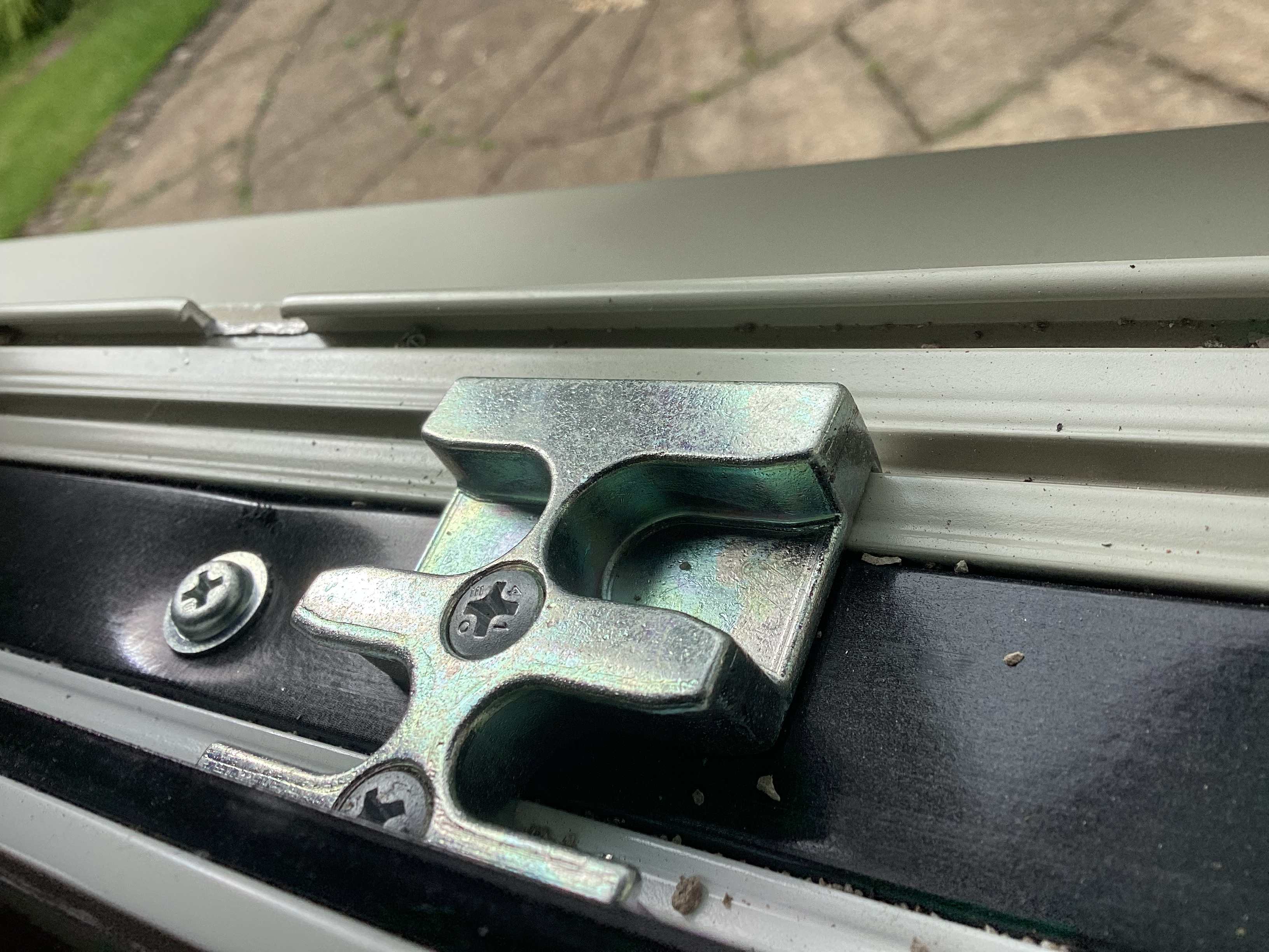

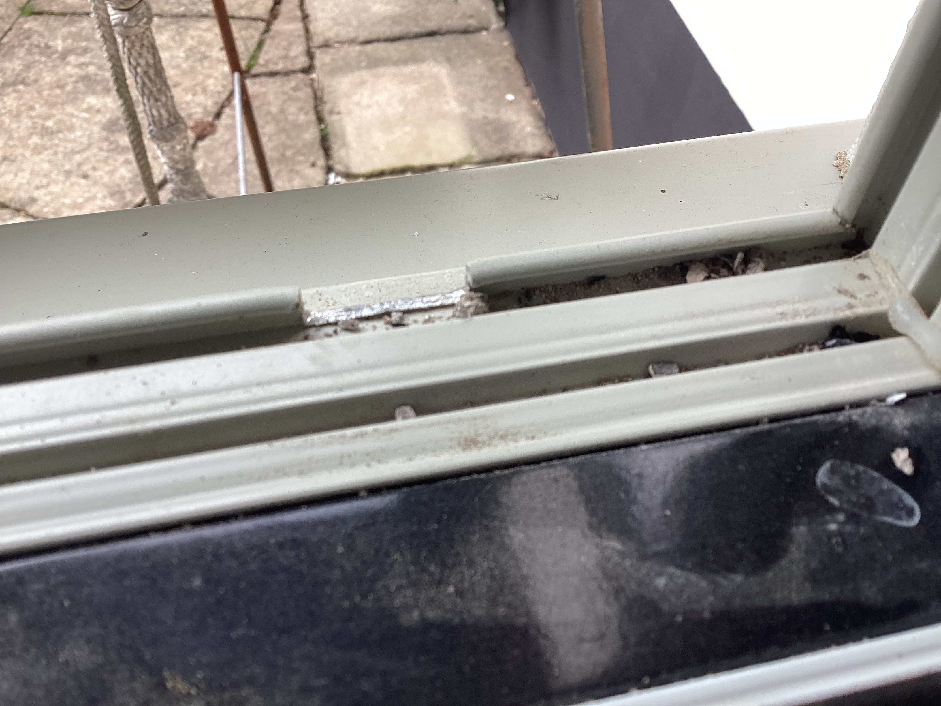

We have just had new aluminium windows installed and I am worried that there are things which are not right .  Is it normal to have chunks of the frame carved out as drainage holes and leave the aluminium exposed on the edges!  Also a lot of the beadings are scratched from installation.  Is it normal/successful to have these repaired/touched up?  They are supposed to be coming back but unsure whether I should push for new beading?
Regardless of beadings I would tell them to replace the frame The fitters shouldn’t be cutting anything off the frame All the drainage is normally done at manufacturing
Very rough work
  • 2 months later...
They should make new all the scratches caused during installation. My installer (Passivlux) have no sense of urgency to do this (or anything else to be honest), but I am pushing them to complete this before signing off the work.
