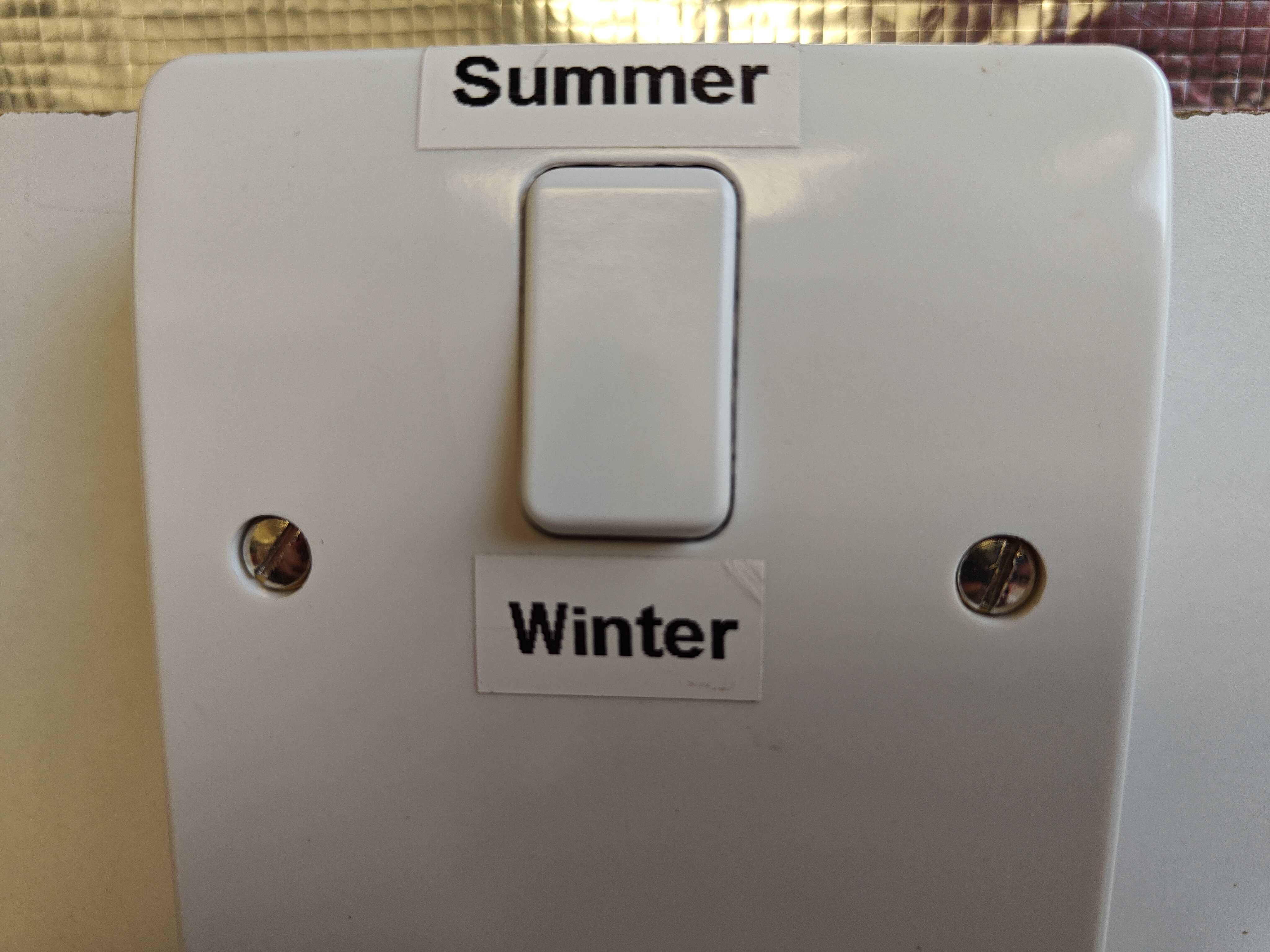

JohnMo Posted August 20, 2024 Share Posted August 20, 2024 12 minutes ago, G and J said: Heat-Off-Cool Heat cool switching should be zero volt switching same as remote on off. So you may need two switched but could be a double light switch, one switch on/off the other summer/winter. Link to comment Share on other sites More sharing options...

JohnMo Posted August 21, 2024 Share Posted August 21, 2024 (edited) 9 hours ago, G and J said: Meaning I can’t just use a normal physical switch, or at least, I then have to use it through another zero volt switching device. I'm guessing this is to protect vulnerable components in the heat pump? Yes normal switch, just a 2 core cable from switch to ASHP for mine. Many will do it via the controller. Edited August 21, 2024 by JohnMo Link to comment Share on other sites More sharing options...

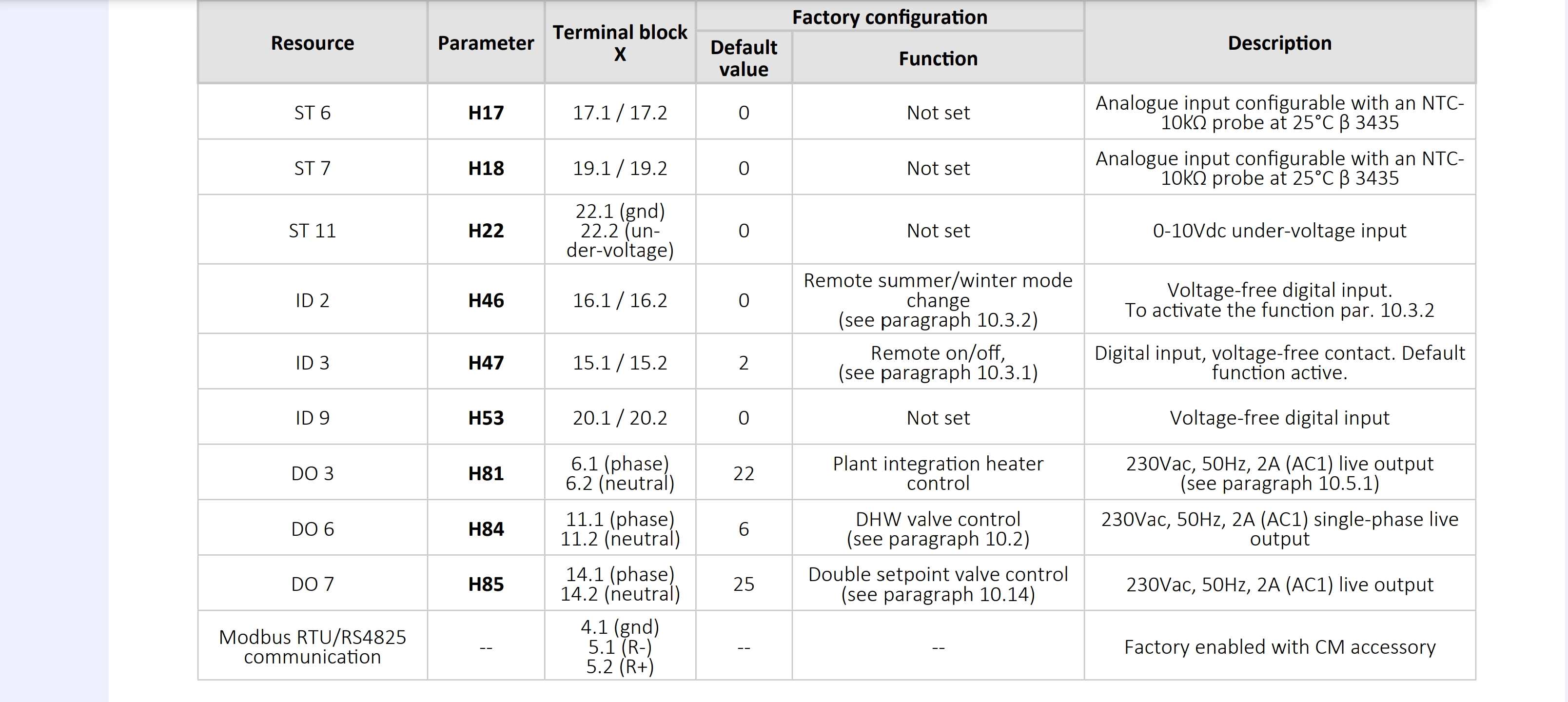

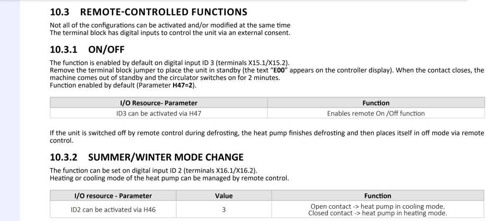

JohnMo Posted August 21, 2024 Share Posted August 21, 2024 (edited) 6 hours ago, G and J said: OK, I’m officially confused. That doesn’t look like a clever zero volt switch. If you’ve only got a two core cable back to the ASHP then presumably that’s just on/off, so how does the pump know whether to cool or heat? I’ll take deep breaths and try and stay calm whilst hoping for a comforting circuit diagram to ease my perturbations. Remote control functions are either open or closed zero volt contacts. One set of contacts are for heat or cool, the other set for heat or cool off. Remote On/off is via a volt free thermostat, this inhibits heating or cooling when it's an open contact see ID3 below Summer winter Open contact or closed contact selects either heat or cool. See ID2 below. Terminal block Edited August 21, 2024 by JohnMo Link to comment Share on other sites More sharing options...
