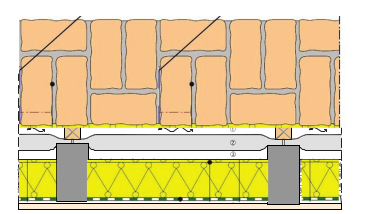

I'm trying to model my wall in Ubakus, and I'm stuck because I can't find one of the materials. (Long story short: the wall is already insulated on the inside, with a mixture of traditional and reflective materials; I am considering insulating it on the outside.)
1. This is the wall as it stands now:
From inside to outside (and top to bottom, within the diagram):
BA18 plaster layer (18mm)
45mm BioFib trio
unventilated air layer (R=0.53, supposedly)
ATI PRO MULTI HPV (reflecting insulation) (40mm)
masonry wall of unknown composition and thickness, from the 1930s (well, I suppose I could estimate its thickness, but I have no idea of how to get an accurate measurement).
The problem is that, while BioFib Trio is in Ubakus's database, ATI PRO MULTI HPV is not. Is there a close substitute?
