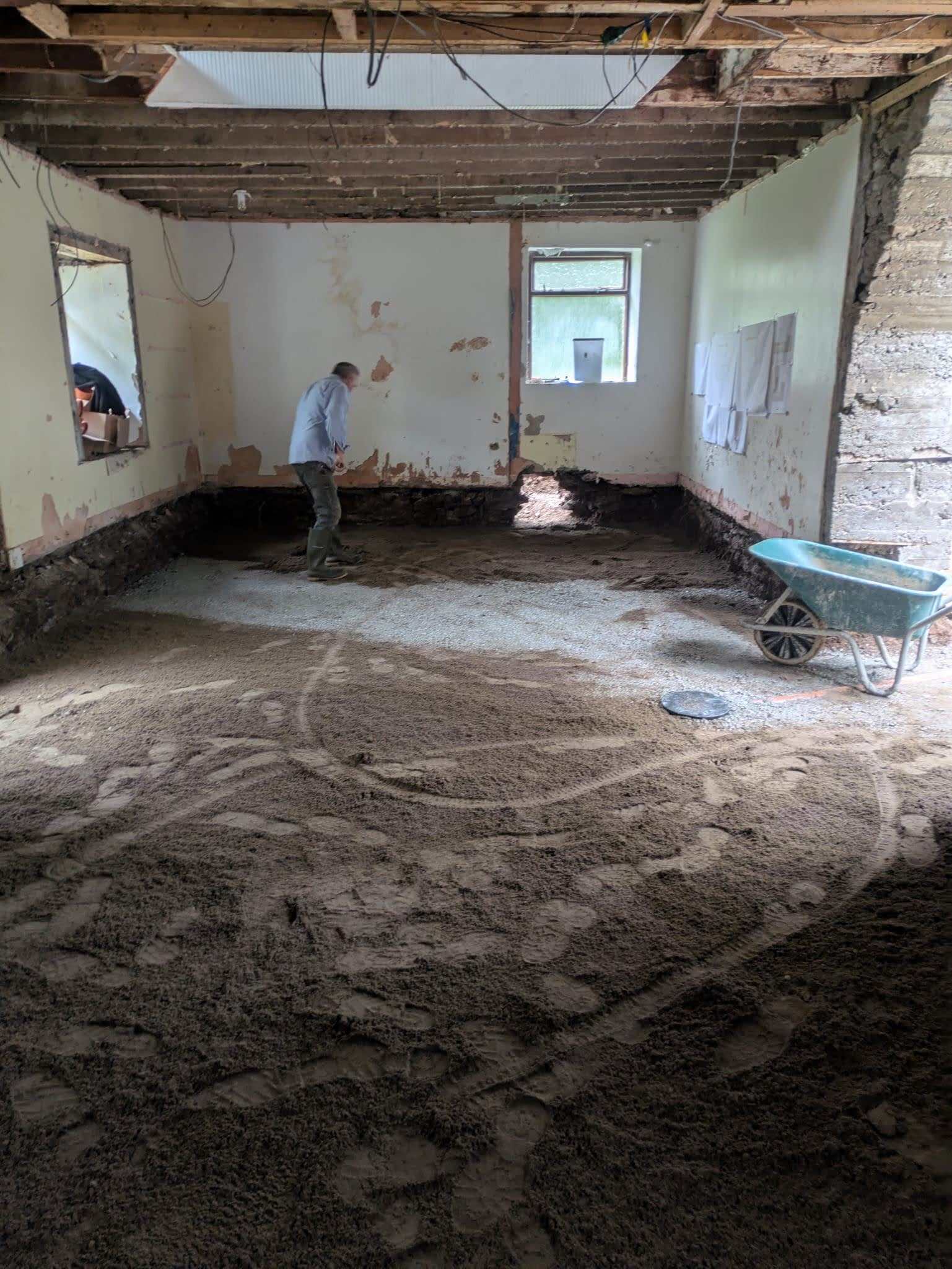

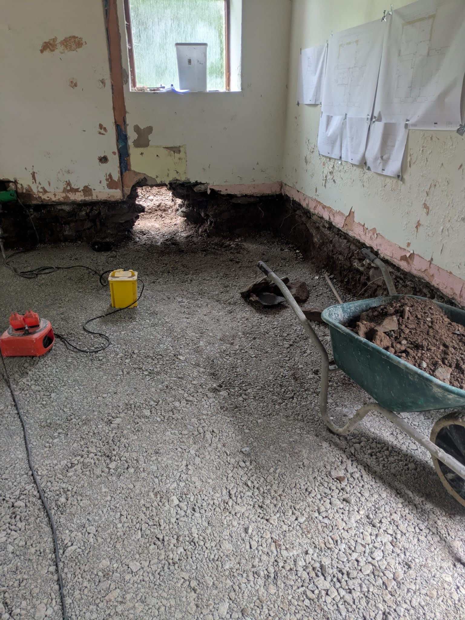

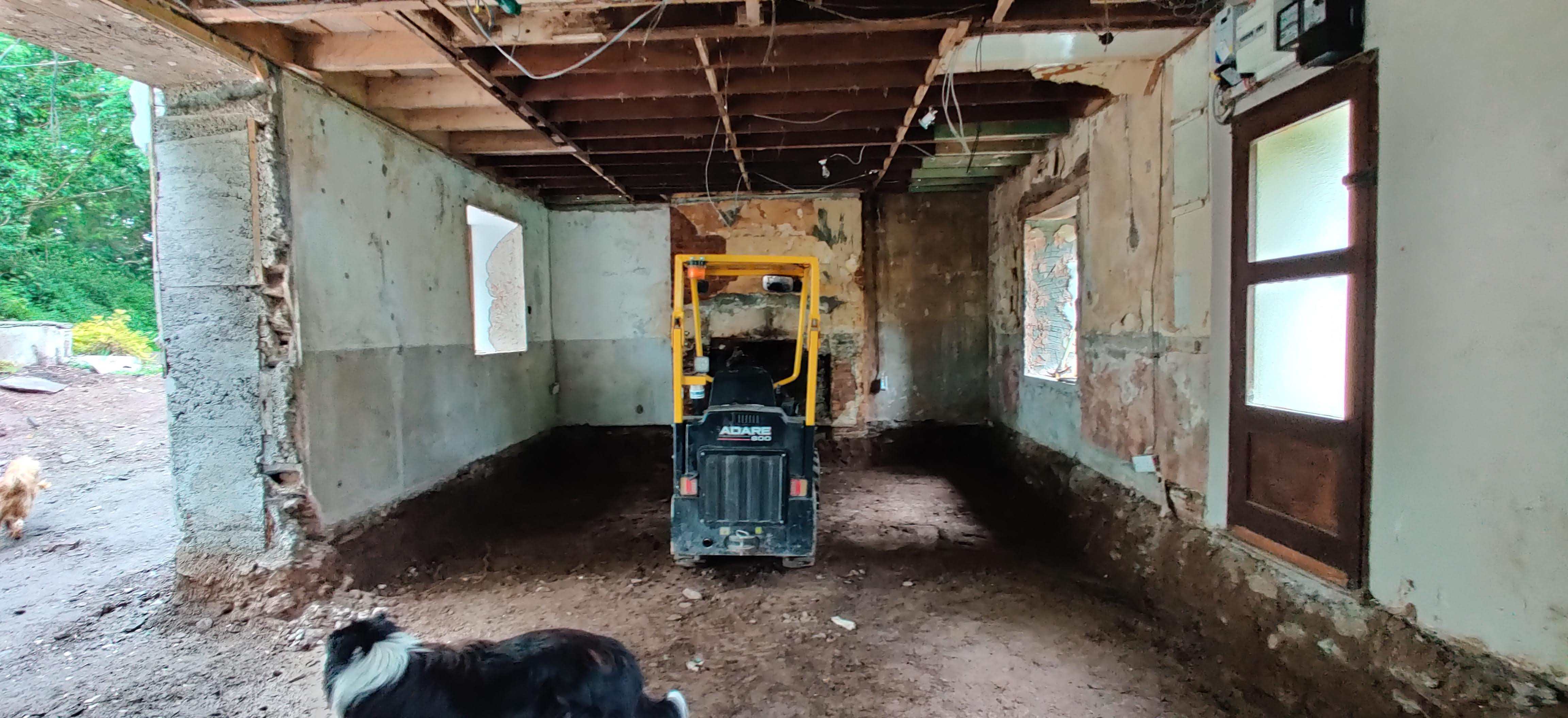

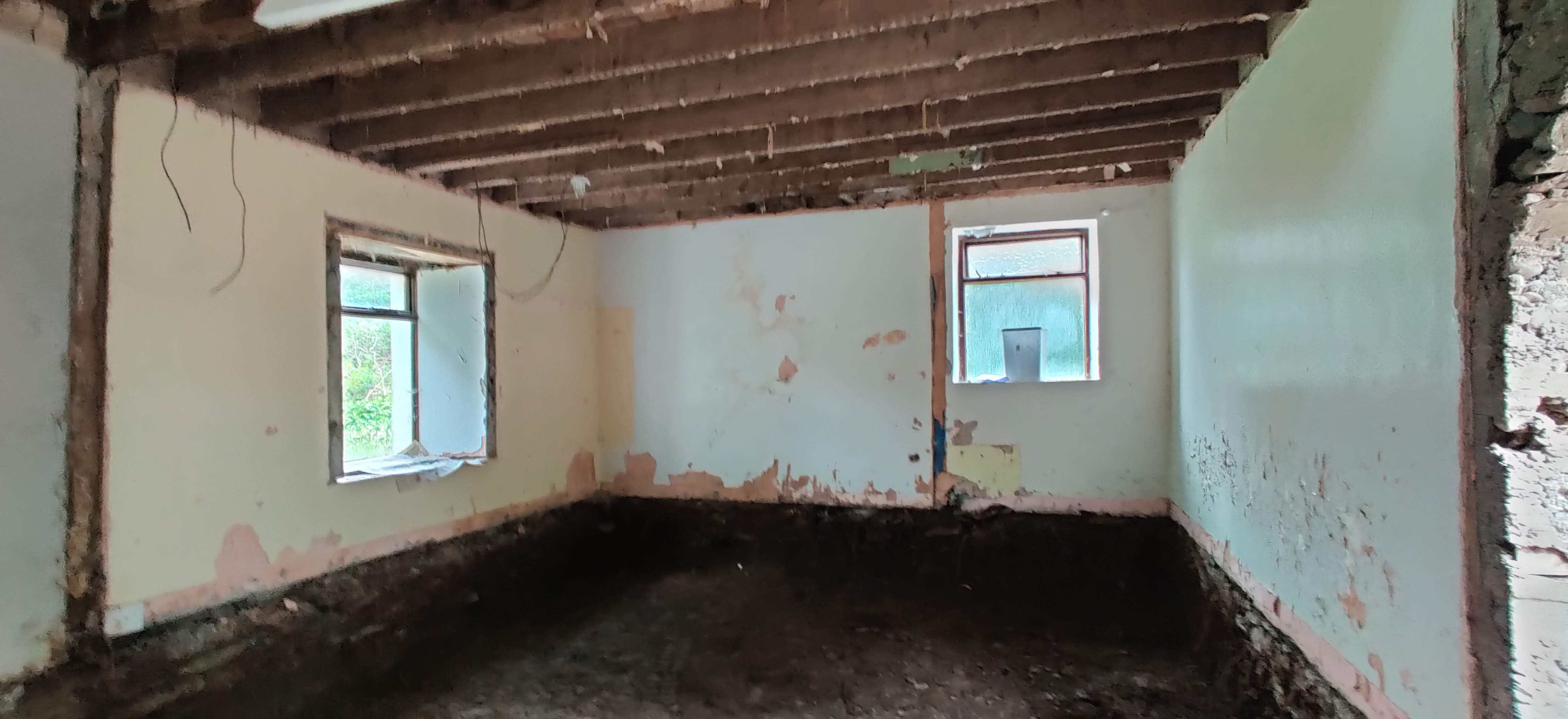

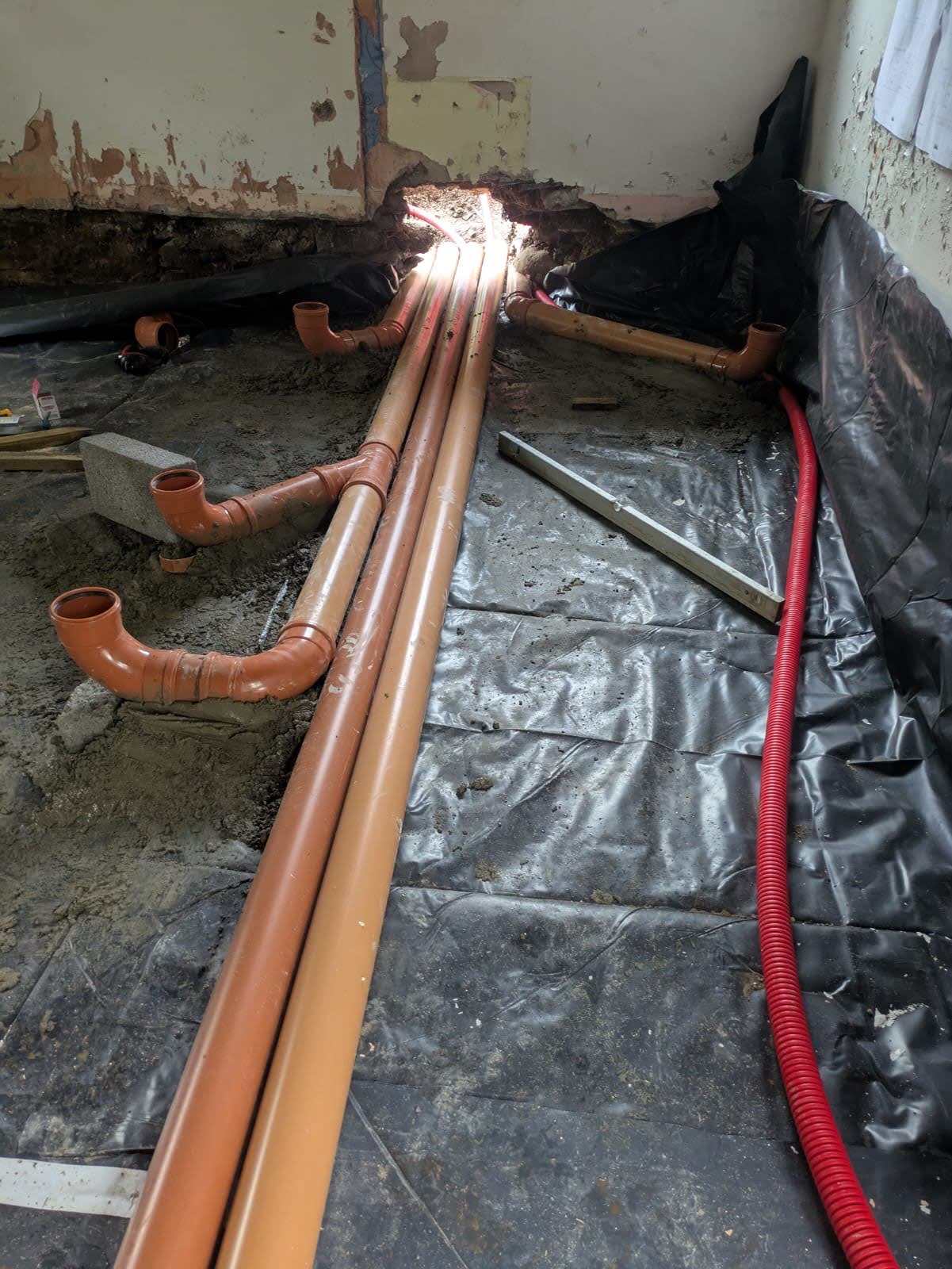

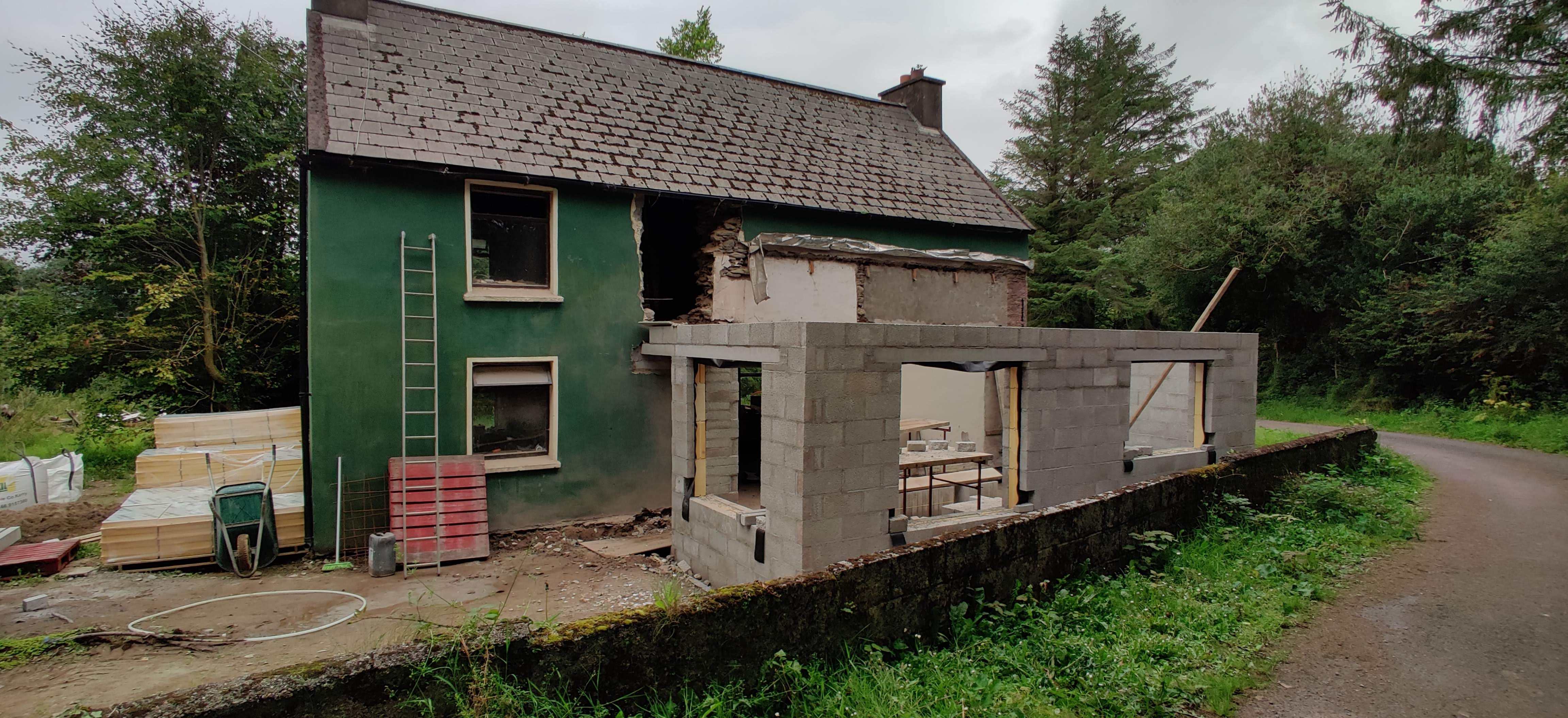

sorry - i never got a notification on this post. In the end we dug down about 500mm and put in 100mm compacted hardcore, blinding, radon barrier, and then a 150mm subfloor. Once the extension is built, the next stage is 150mm insulation, 70mm screed with UFH and then the floor finishes. I’ll post some pics now of the progress
19 minutes ago, Bemak said:
This seems to be quite a popular solution in Ireland on old houses.
Ive no idea why as its likely to create damp problems. And increases the risks during rexcavation, depending on the depth of the foundations.
i think it will work out fine, particularly when we introduce a french drain.
