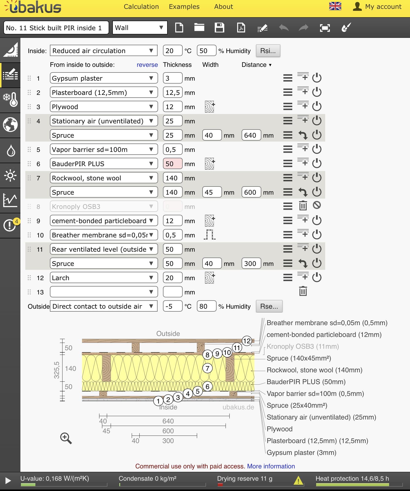

I’m celebrating, I finally managed to produce a sensible looking ubakus wall build up dooberry thingy.
Now I need my homework marked….. (should I be worried about the red colour on the drying reserve measure?  It goes away if I turn off the PIR layer).
