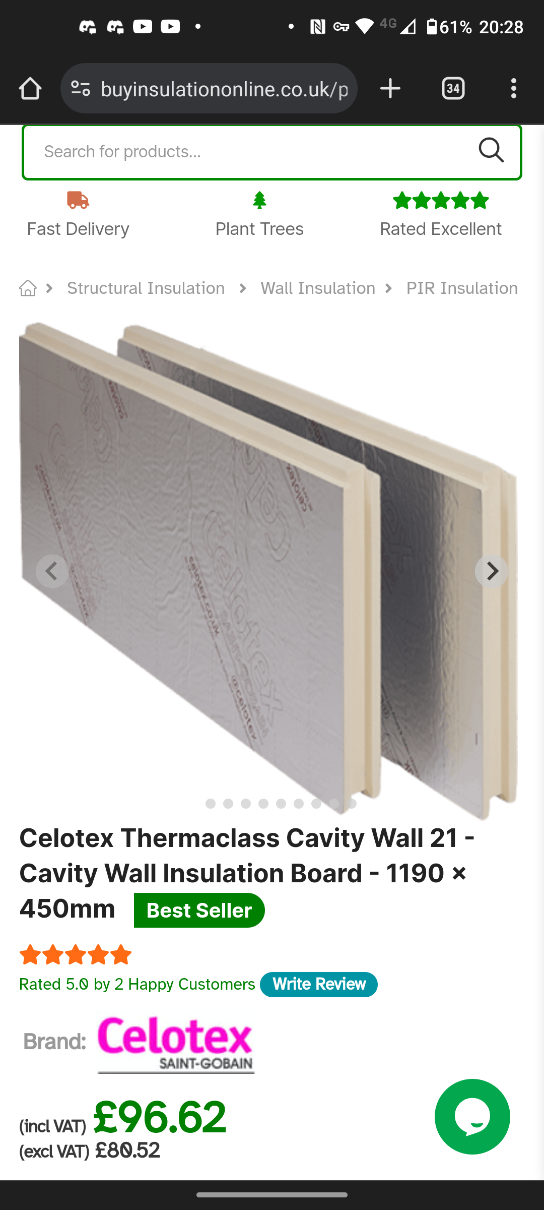

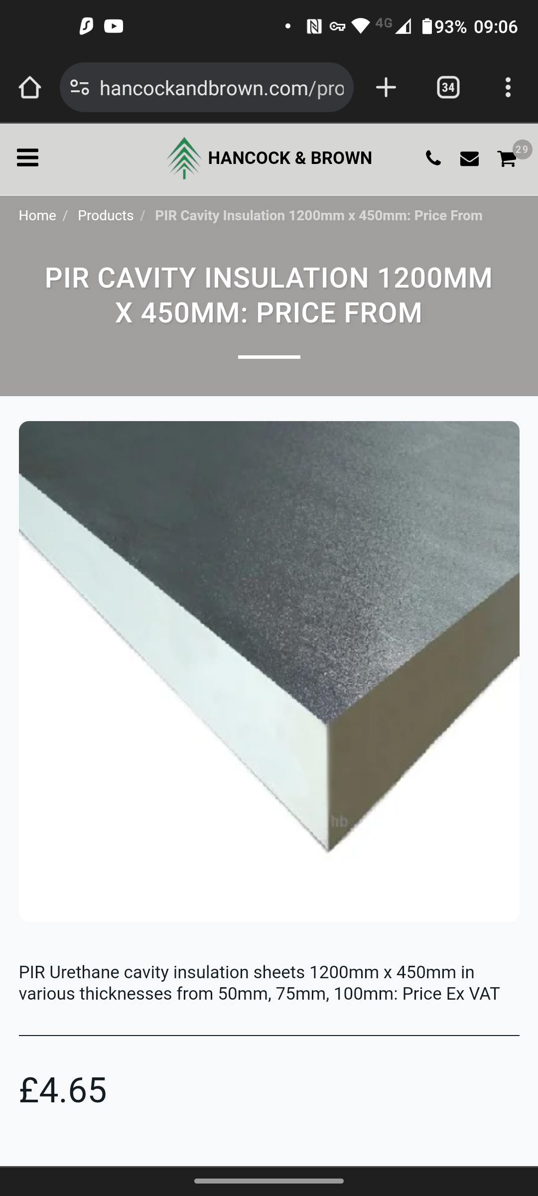

1) partial fill cavity or full fill? Cavity will be 100mm.
To me it seems senseless to build a cavity to then full fill it. Isn't that defeating the objective of a cavity. Surely by filling it full fill I'm asking for damp to be bridged through?
With partial fill, it says I need a 50mm air gap? Which only leaves 50mm of insulation.
But I have sound some pir batts that are BBA approved and says they can have a 10mm air gap.
90mm board 10mm air gap.
These are more expensive but also have tounge and grove.
Please see attached picture of these bba approved batts compared to standard PIR batts. Are they worth the extra money?
The cheaper ones don't say anything about bba approved? So guess they need a 50mm air gap compared to the other.
Or is it better to go for full fill. I can't decide.

Regarding full fill cavity, this is what I did with my build (200mm) in rockwall batts, as you say they have a bba cert for full fill. Also as a “porch” which is outside the thermal envelope do you need to insulate that well?. I had a porch on my build, only 50mm cavity and full fill but it’s only an “air lock” to stop loss of heat when the front door is open.
