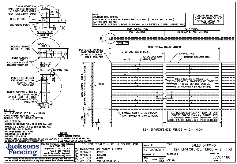

Have a look at a product like this
https://www.jacksons-security.co.uk/acoustic-security-barriers/12k-acoustic-envirofence
In effect its 20mm thick timber which interlocks
