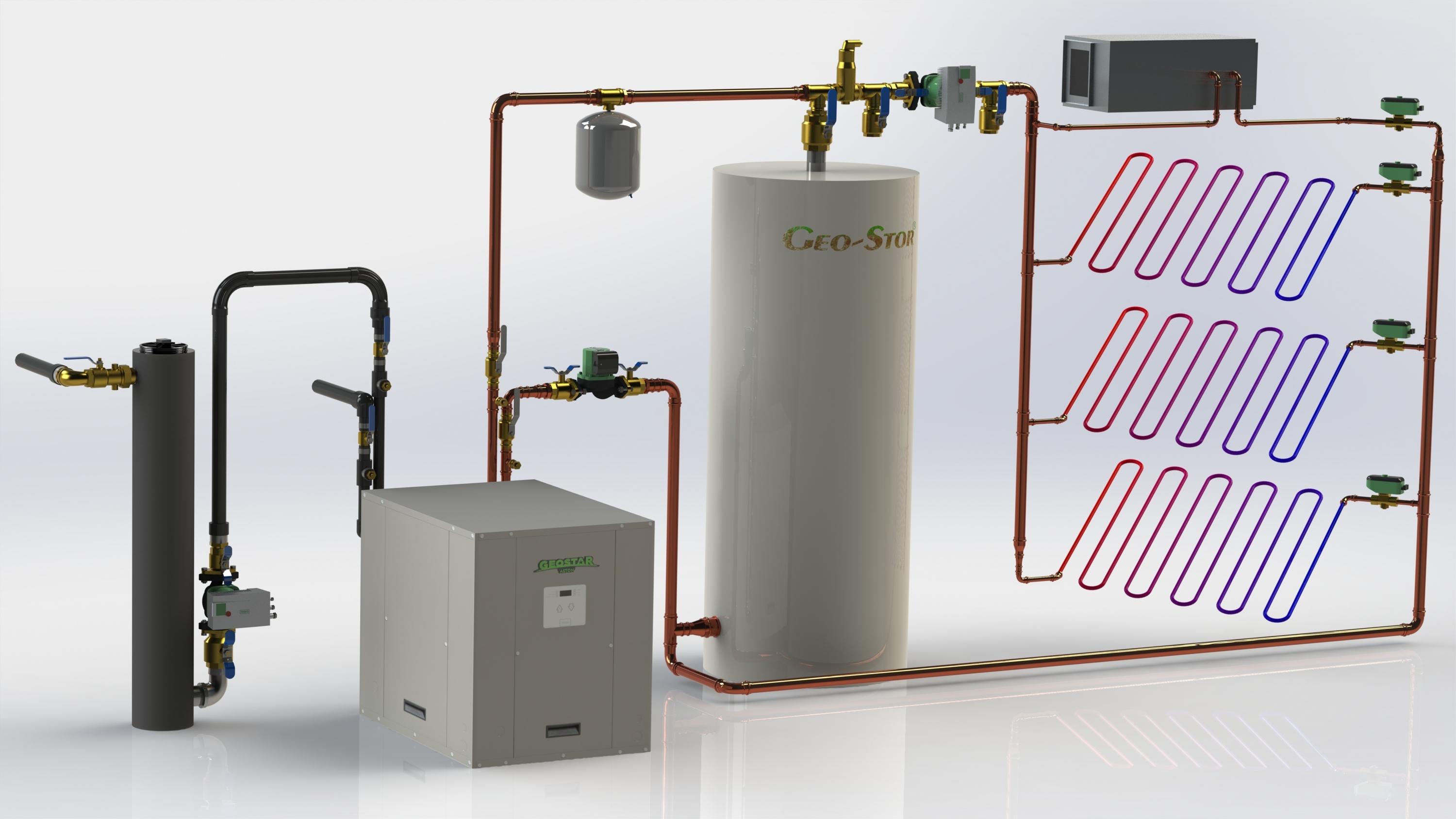

JohnMo Posted May 15, 2024 Share Posted May 15, 2024 2 minutes ago, Jerry32 said: solar generated electricity, to keep the cylinder warm enough to delay the re-firing of the Combi. Well that was my intent anyway So basically using the UVC in reverse as a buffer. I would plumb as a 2 port buffer. So basically it simplifies the install. The grey box is your boiler there is an oversized tee on the top connector, this forms a hydraulic nul point, after that you have a secondary circulation pump. Water flow is to central heating first, zones closed flow is automatically diverted to buffer, no zones open around buffer only. You control the secondary pump by the heating demand, you control the boiler by the cylinder thermostat. You are likely going to need a larger heating system expansion vessel to match your increased capacity. How it works - So cylinder hot, house heat demand the secondary pump pulls from the buffer until the buffer calls for heat, then the boiler starts. Once house demand is finished secondary pump stops and the cylinder is heated ready to go. At the end of the heat season switch the boiler off, but it likely your solar excess will do that anyway. The DHW would look like the top image below, with a Watts solar diverter. You need a cold water safety group and expansion vessel if not already installed. Safety There must be no valves (if valve the handle removed) between cylinder and heating system expansion vessel and safety group. Or you install the full safety group on the cylinder - this is a zero cost option as all the kit comes with cylinder anyway. Link to comment Share on other sites More sharing options...
