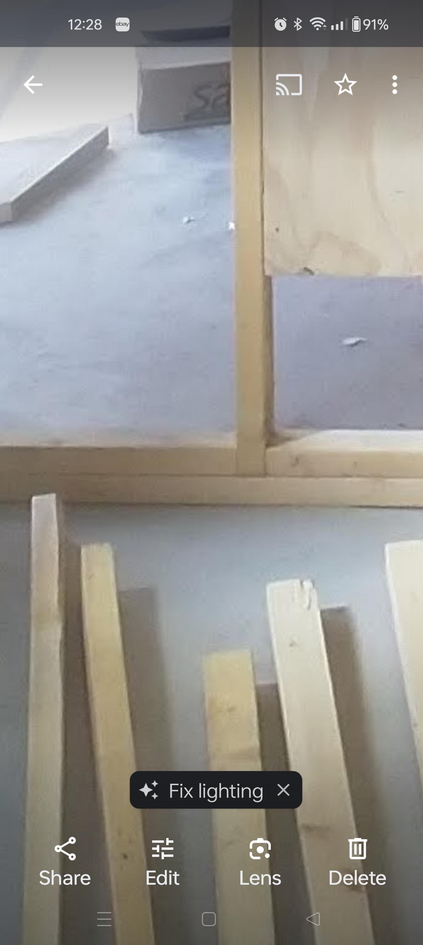

After a quick bit of help. The sole plate(s) on my stud walls arent going to be high enough above the insulation and screed to support the perimeter strip going around.
My question is, does it need it? I assume without it there is a good chance the screed will bow the perimeter strip out or could break through. Should I put a length of ply around the base of all the stud walls as support? Or do I need to add what would basically be ground level noggins between each stud...
I am currently thinking the ply would work and is necessary....
Thanks!
Doug
Just cut a noggin to add height to the sole plate. Insert between the vertical studs.  Like below
Screenshot_2024-05-10-12-28-42-74_965bbf4d18d205f782c6b8409c5773a4.thumb.jpg.f8f9a8213add5e91f0ca98aa82f69f72.jpg
Cool, easy enough thanks. A lot of noggins to cut and was praying I was done with them! 🤣
