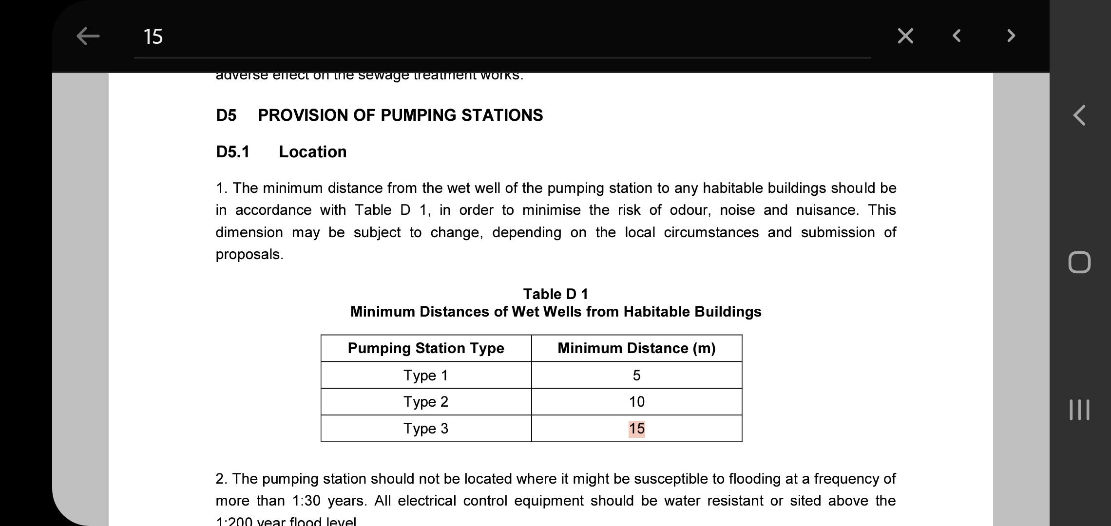

Has anybody got a link to a building regs doc which states minimum distances from a sewage pump station to a house? I've scanned doc h but didn't see it.

15m from the wet well for the largest type of water pumping station

From water uk
Design and Construction Guidance for foul and surface water sewers offered for adoption
Screenshot_20240331-144611_AdobeAcrobat.thumb.jpg.a519e3cc375f8f5858c31d4839d5ebd8.jpg
