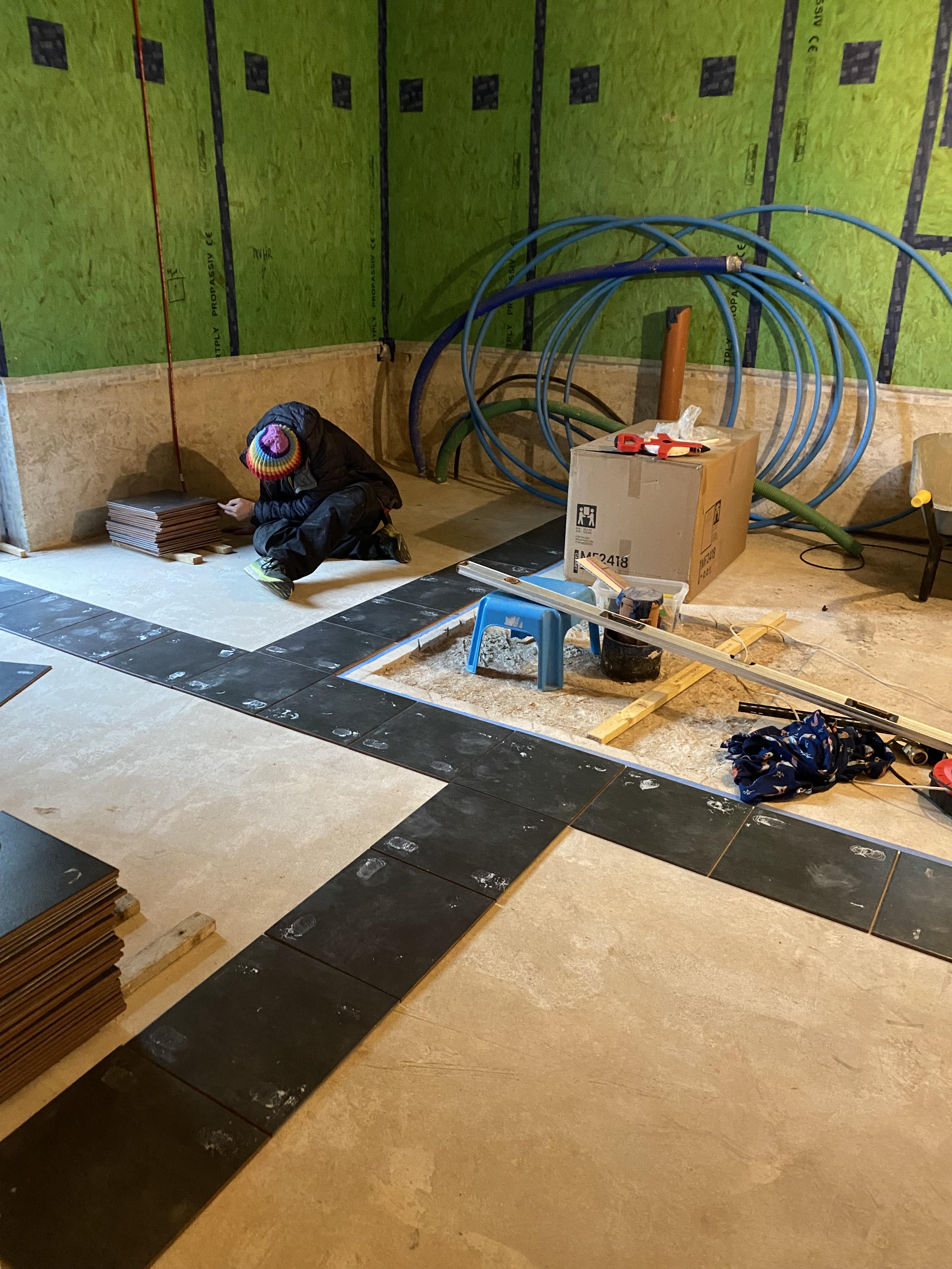

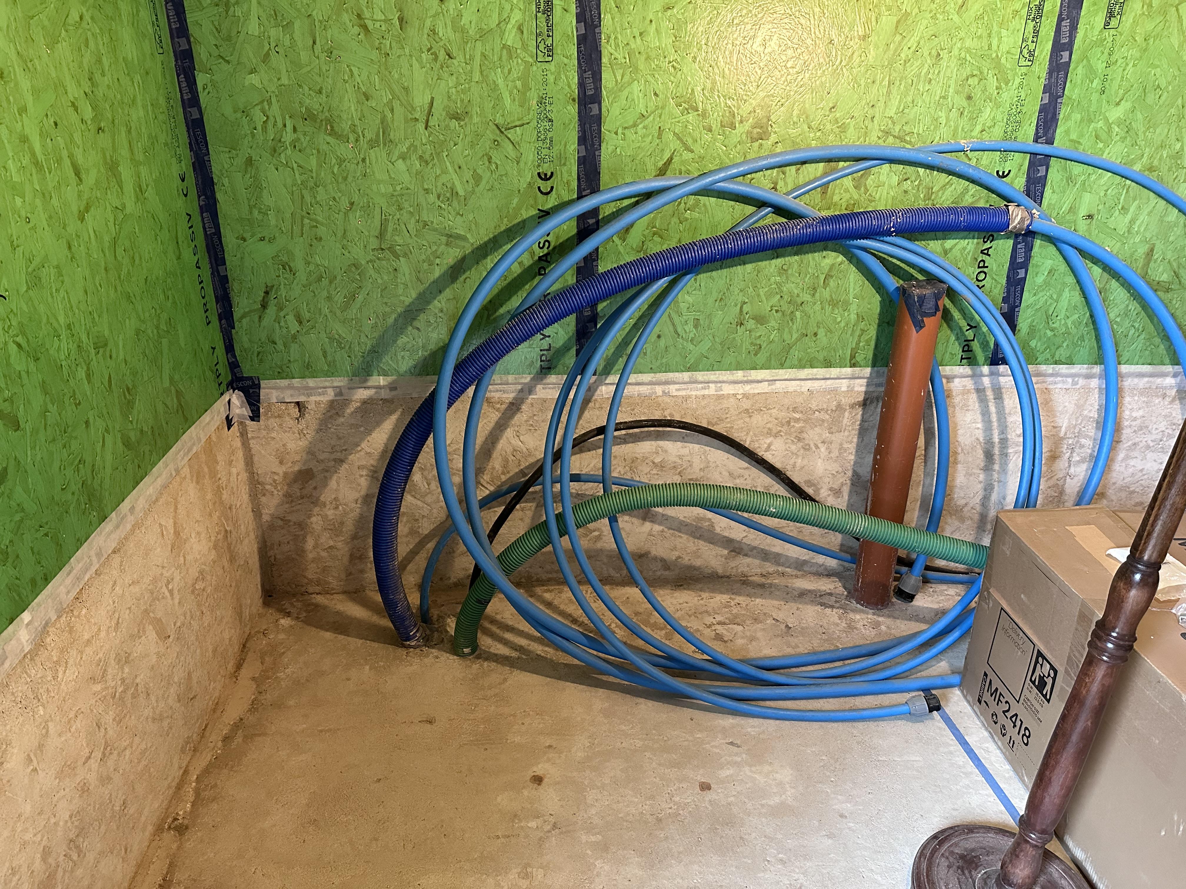

I am starting work lining and tiling the plant room this week. The conduits for internet, electricity and water come up through the slab and I’m not sure what to do with them. Any thoughts?
photo below: The plant area is behind where HWMBO is sat, with the black tiles on his left marking out the right hand boundary wall.
We battened out a small area with 3x2 timber, ply on top and brought all the cables etc up behind it, then out through slots for the consumer unit, network switch etc. or you could but a networking cabinet. Water should be away from everything else.
