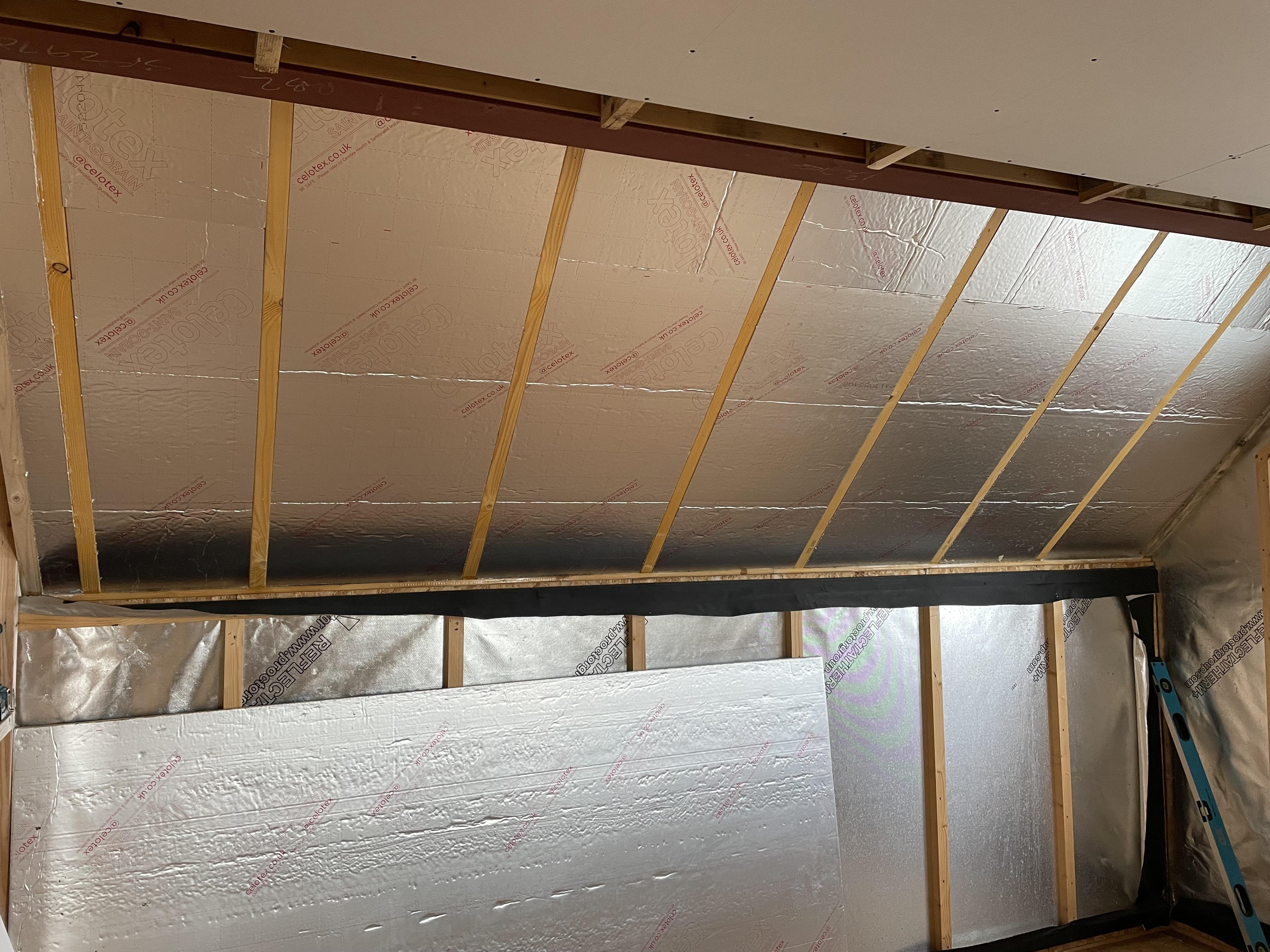

Can I ask what the pic above shows? Is it the PIR between the rafters, with tape entirely covering the rafters?

The photo has 170mm PIR in between the rafters, rafters not visible for the tape.
Tape the PIR together with foil tape and return it to the walls with tape or airtight sealant to ensure no vapour from the room can migrate into the roof.
Then run 50*50mm battens at 90deg to the rafters for a service void. 400mm CC for 12.5mm plasterboard or 600mm CC for 15mm plasterboard
Run your wires as necessary. (They may need to be uprated, consult your sparky)
Infill with 50mm Rockwool batts. They will fit around the wires, provide better sound and fire protection and break the thermal bridge of the rafters. ( I would happily take this to 100mm Rockwool if you wanted to). It is important that you have a very comprehensive airtight layer returned without any holes to the internal walls though.
Then 1 or 2 layers of plasterboard. Seal all penetrations and the perimeter with acoustic mastic for sound protection.
Skim.

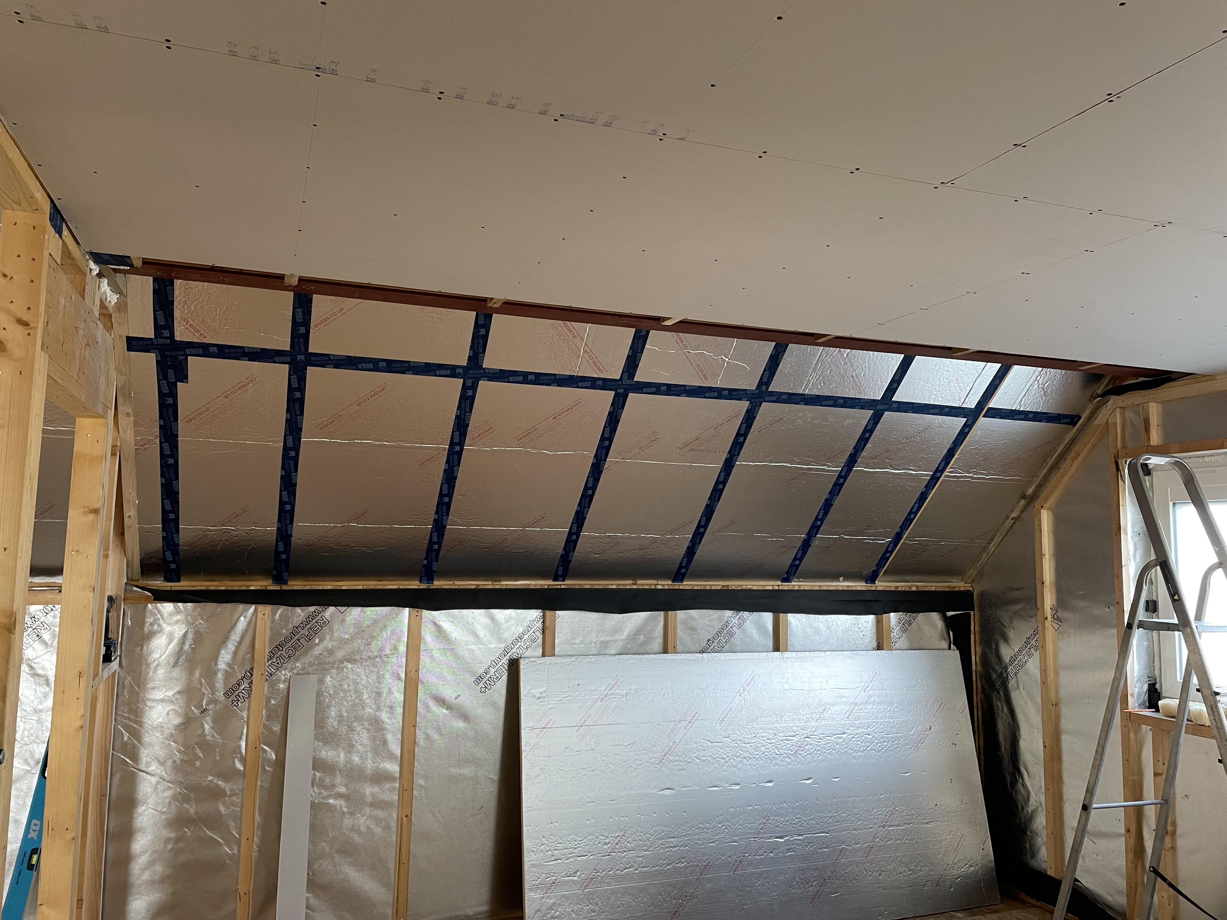

Thanks for the info, I am curious as to how I should be fitting the PIR under the rafters though.
Is there any specific way the sheets should be cut/positioned to line up with rafters etc.
It is 15mm plasterboard.

I think an insulated service cavity with Rockwool comes with lots of advantages over PIR as mentioned.
If you do use PIR Any which way is fine. Less cutting and joints is better. Just use a couple of woodscrews with insulation washers to hold them in place temporarily. Foam and tape the joints. Make sure to mark the rafters lines with a Sharpie on the boards.
Then use the battens screwed through to the rafters to seal the deal.
25*50mm battens will be a pain though. Not very straight and will split easily.
50*50 or 25x75 will be better.
600cc is fine for 15mm.
I already have the PIR so will use it.
Any advantage fitting rockwool in the service void on top of the PIR & VCL?
More insulation is always better.
Better fire and noise protection.
