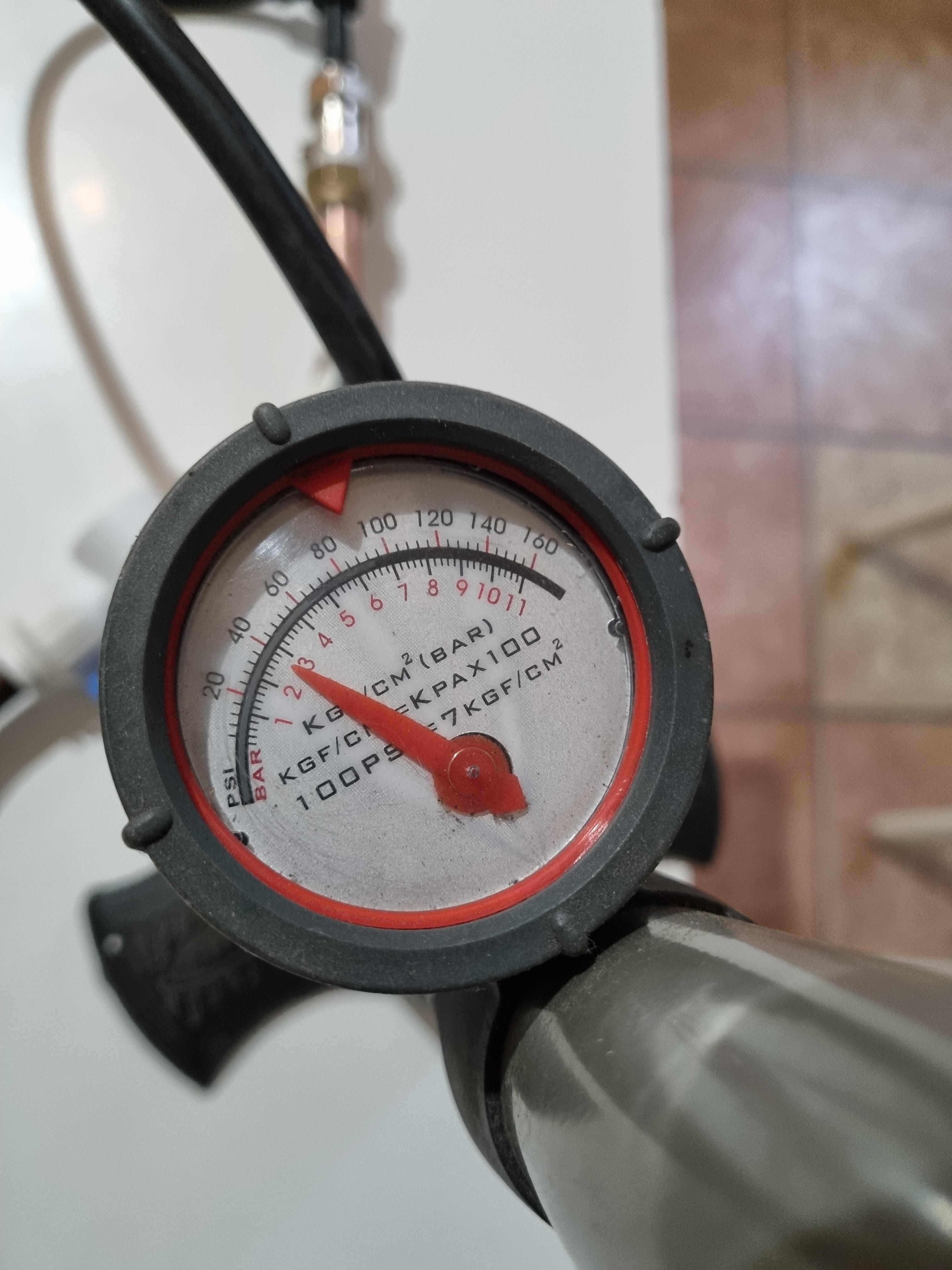

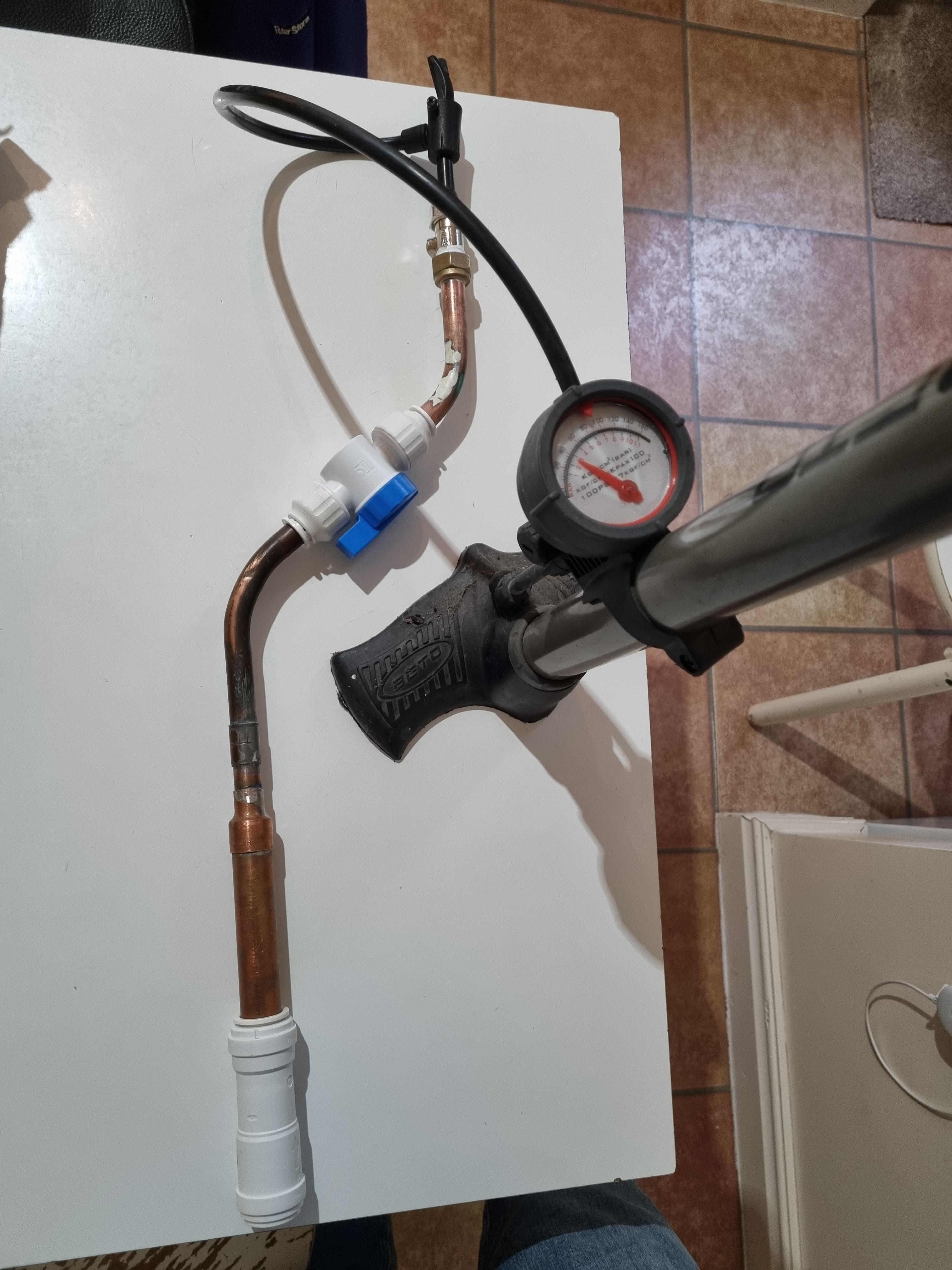

BotusBuild Posted March 11 Share Posted March 11 Following a few threads and a YT video, I decided I was competent enough to create an air pressure tester for plumbing purposes. I will not be using this beyond the pressure shown in the picture as I deem this more than enough for the H&C water pipes it will be used to test in the house. Its first use will be on my DIY H&C manifolds - more to follow. This is designed to used on 15mm or 22mm pipework. The bend are because I used leftovers from old repair work in current house, but should allow connection to mounted equipment to be a little easier 1 Link to comment Share on other sites More sharing options...

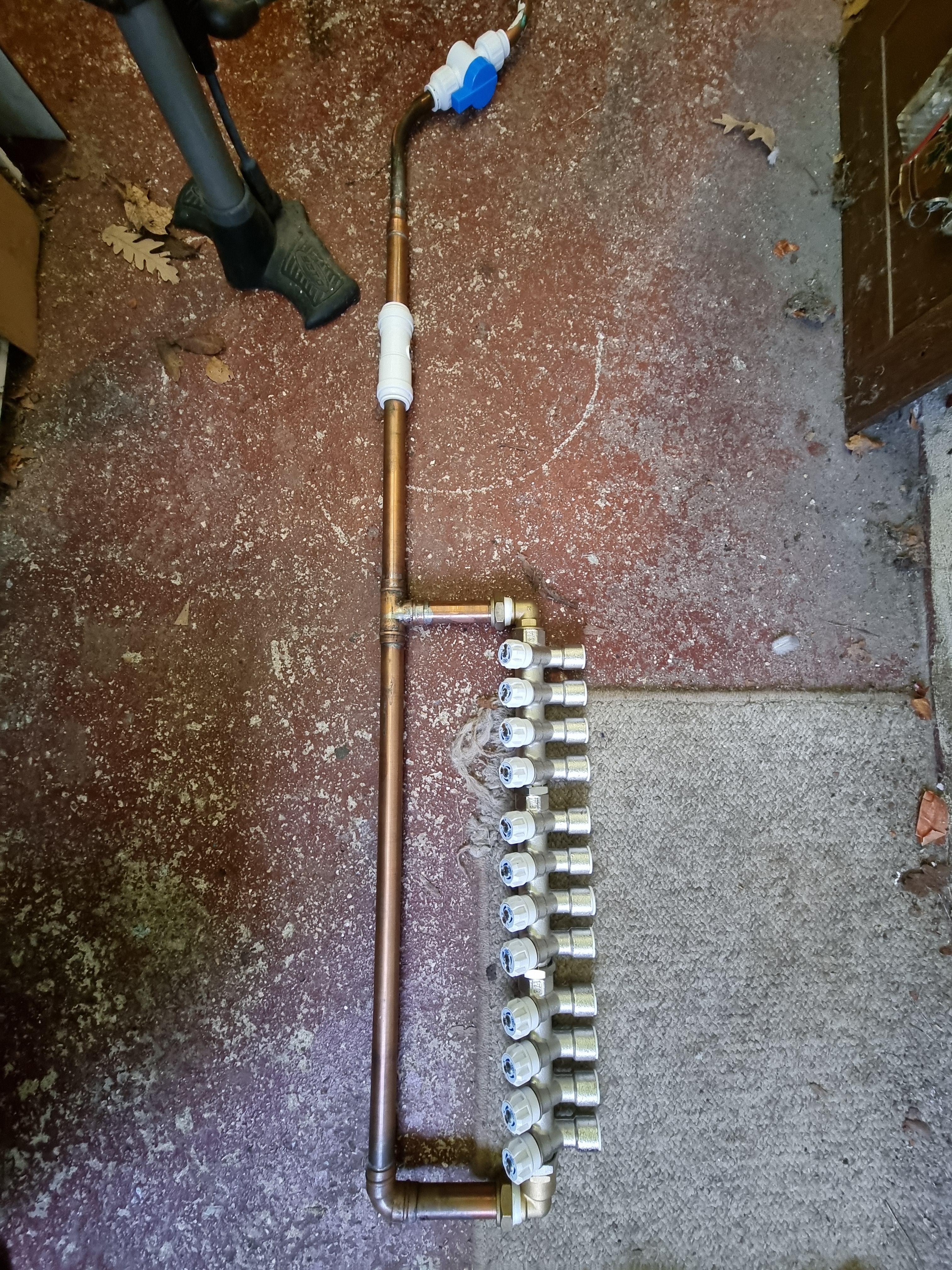

BotusBuild Posted March 11 Author Share Posted March 11 DIY H or C manifold being tested 1 Link to comment Share on other sites More sharing options...
