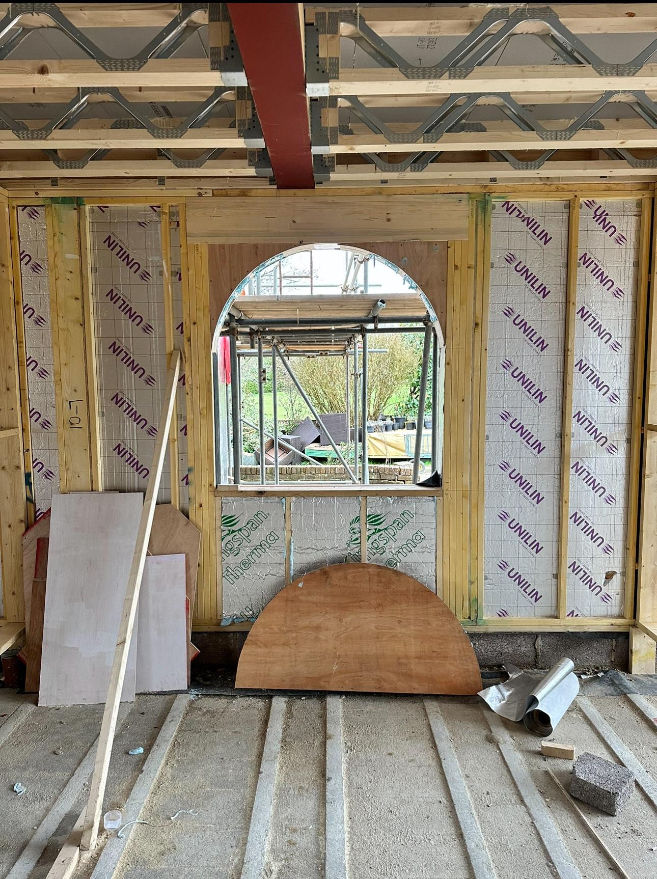

Timber Frame Arched Cavity Lintel
A tricky one on site… BC have said we need a 50mm arched cavity lintel above this arched window.
Struggling to find a supplier! IMG_2253.thumb.jpeg.1e8955c0aa8cbdb20c44bed2f1c2bce4.jpeg
Anyone else encountered the same problem?
Can you just form the arch in brickwork and use a normal timber frame lintel with cavity tray above?
BC inspector wasn't keen on this as a solution over the phone.  He's coming out Thursday so I will try again with that solution!
  • 2 weeks later...
Thanks for all your comments.  IG Lintels came up trumps, supplying me with an arch lintel (1360mm SPAN; 600mm RISE) for £260.
