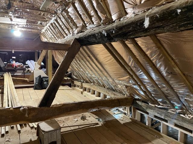

We are restoring an old barn and in the living room it will be double height with a valuted ceiling, which will be 2 bays long (circa 8m) . The 1st photo shows the restored roof pre plasterboarding.

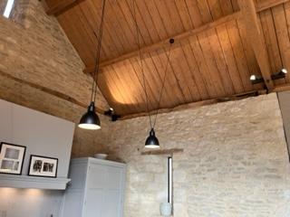

I am trying to find the right product to run along the bottom beam to push light ip the roof towards the purlin.  I'm trying to get the effect the second picture shows (kitchen showroom) but ideally I was hoping to be able to hide the light on top of the beam rather than see spotlights as shown....

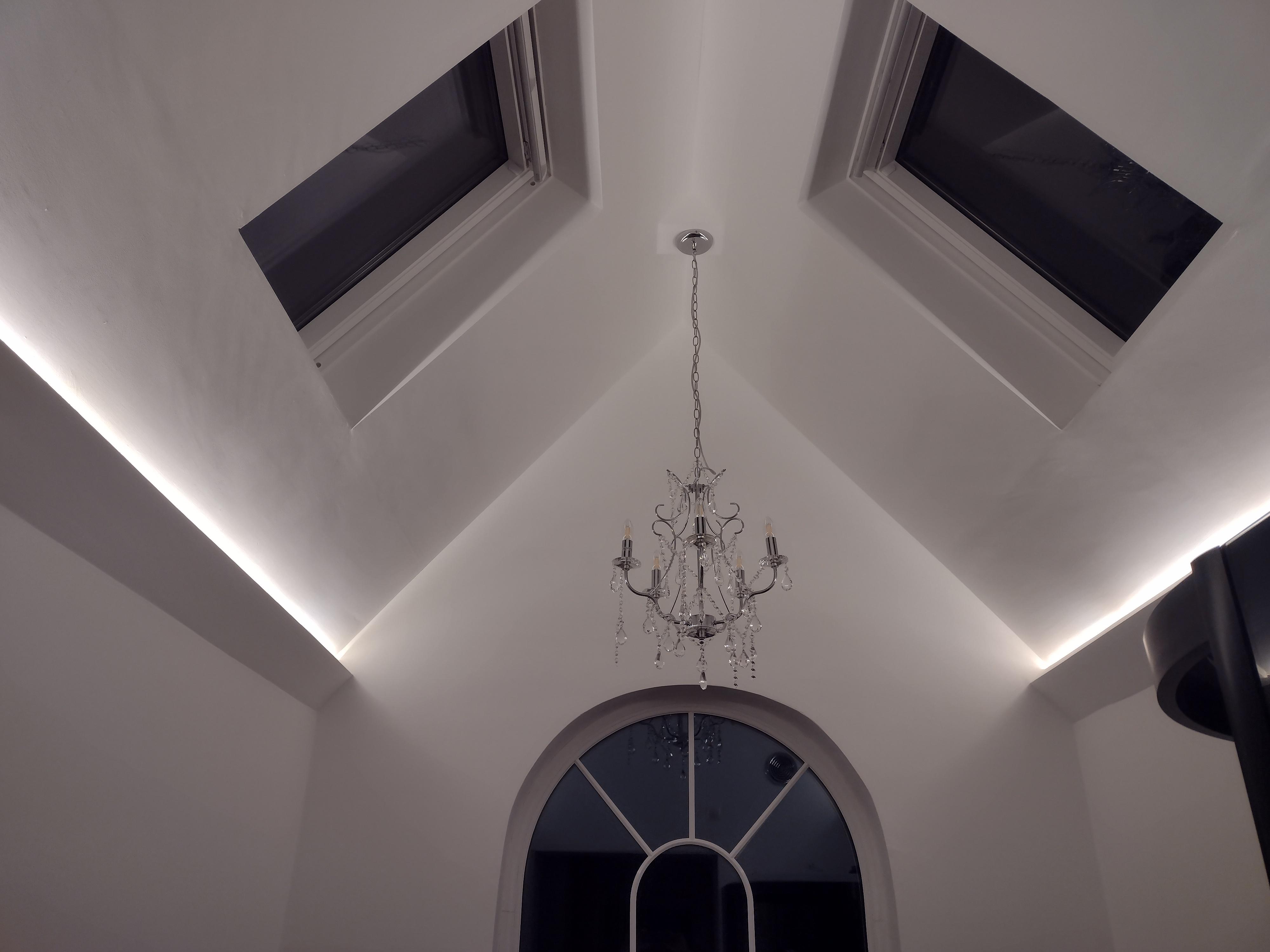

I think this is 5w a meter led strip warm white, but a relatively small room and white ceilings
Many thanks for all the replies, the picture from "bassanclan" is exactly where wer are looking to go... ideally quite bright to the purlin and then fading out towards the ceiling..... of to investigate further!
