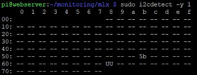

The sensor is a cheap CJMCU one, which is an mlx90614, sometimes also known as a GY-906.
I have installed all the relevant libraries i.e. adafruite_mlx90614, smbus2, etc, but may have missed something key.
I can get it connected and showing up with i2cdetect -y 1 as 5b and plays nicely with my RTC (which may or may not be UU)

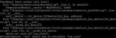

When I come to run the proper Python programme I get this message.

A bit more playing and I get this message.
from smbus2 import SMBus
from adafruit_mlx90614 import MLX90614
TemperatureModule._sensor = MLX90614(1, 0x5B)
while not i2c.try_lock():
        temperature = TemperatureModule._sensor.get_object_1()
        temperature1 = TemperatureModule._sensor.get_ambient()

adafruit_mlx90614 is the CircuitPython library (https://docs.circuitpython.org/projects/mlx90614/en/latest/api.html) so you'd have to flash the firmware to your microcontroller. I'm assuming instead you're using a zero or such with a standard python install, so you'd want another library. The one you linked might work but note the different name for pip/include: https://pypi.org/project/PyMLX90614/

Zero and 3 will behave the same (full OS with Python on top). CircuitPython is for things like the Pico.
That could account for it then.
I have booted up one of my old Pis and shall see if I can get the proper libraries on it.

Nick, have a look at the Datasheet for the MLX90614.  It runs a proprietary 2-wire protocol that isn't quite I2C. This might confuse the RPi I2C driver, but the easiest is to have a look at the various MLX90614 on RPi YouTube videos, e.g.
