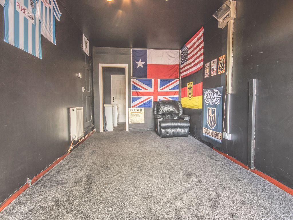

The project: bought our house in 2021 and previous owner had ‘converted’ attached single garage into a den. It involved dot & dab PB (painted black) and a single 400x600 radiator for the uninsulated space. Oh and garage door replaced with patio doors and carpet straight on the slab.

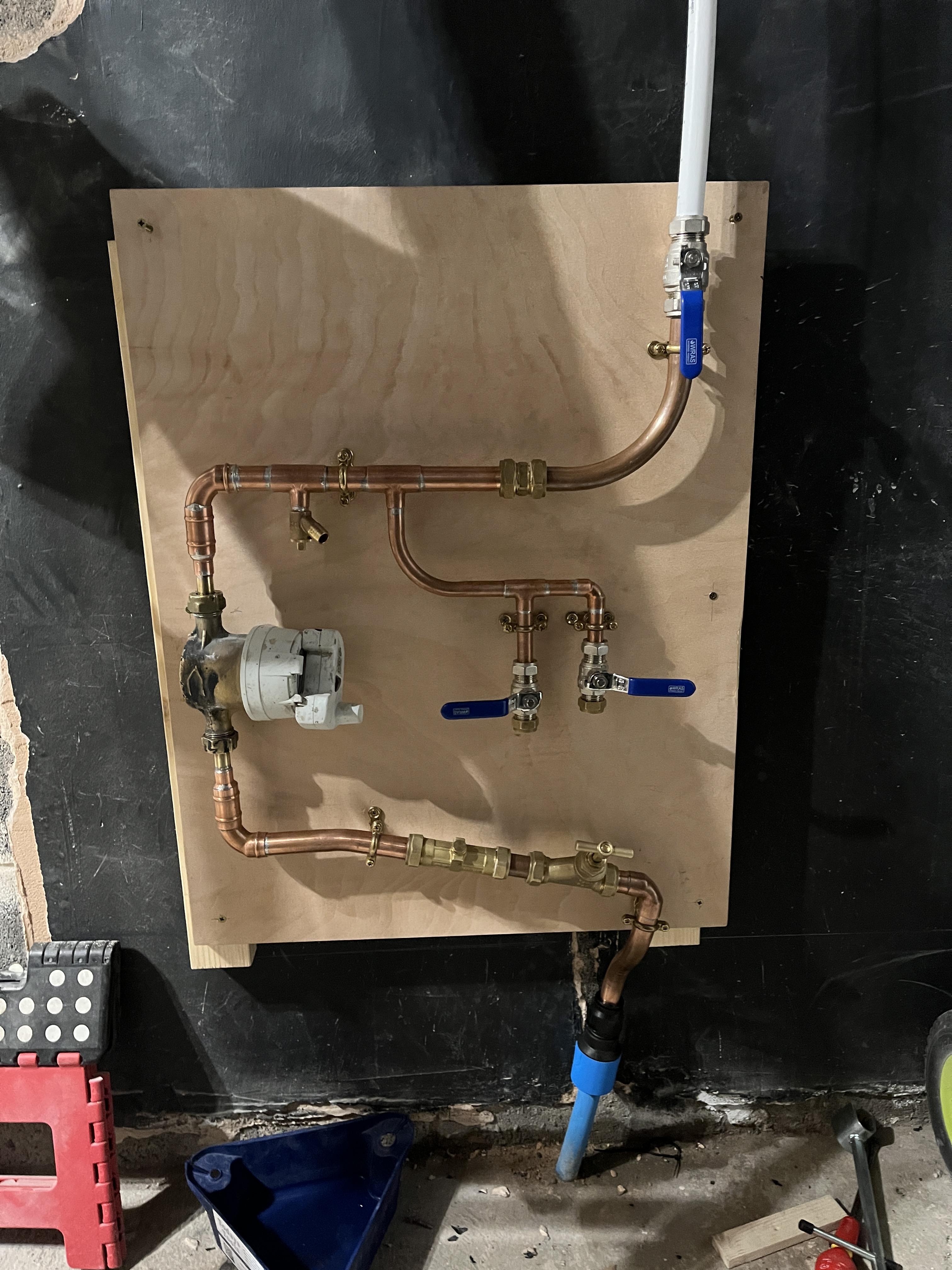

Recent success is replacement of a very dodgy cold rising main that had been plastered and painted over, with new manifold (will be within shallow depth cupboard in future utility).
