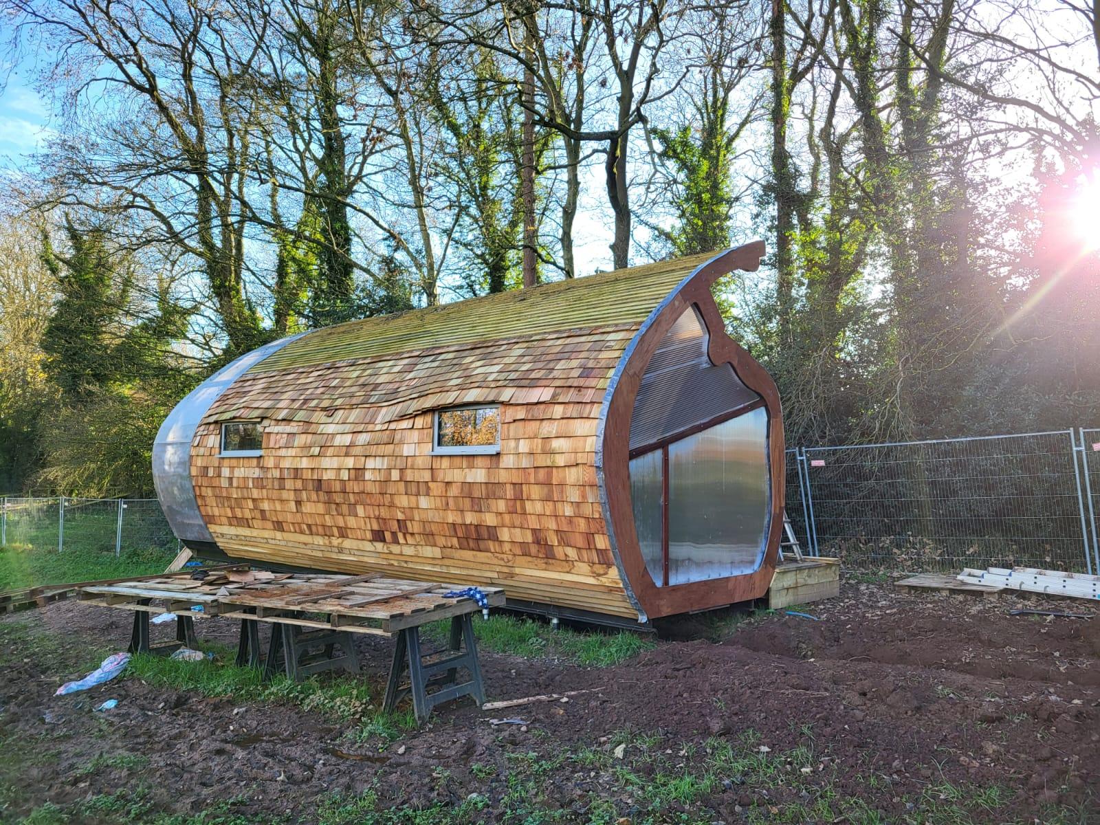

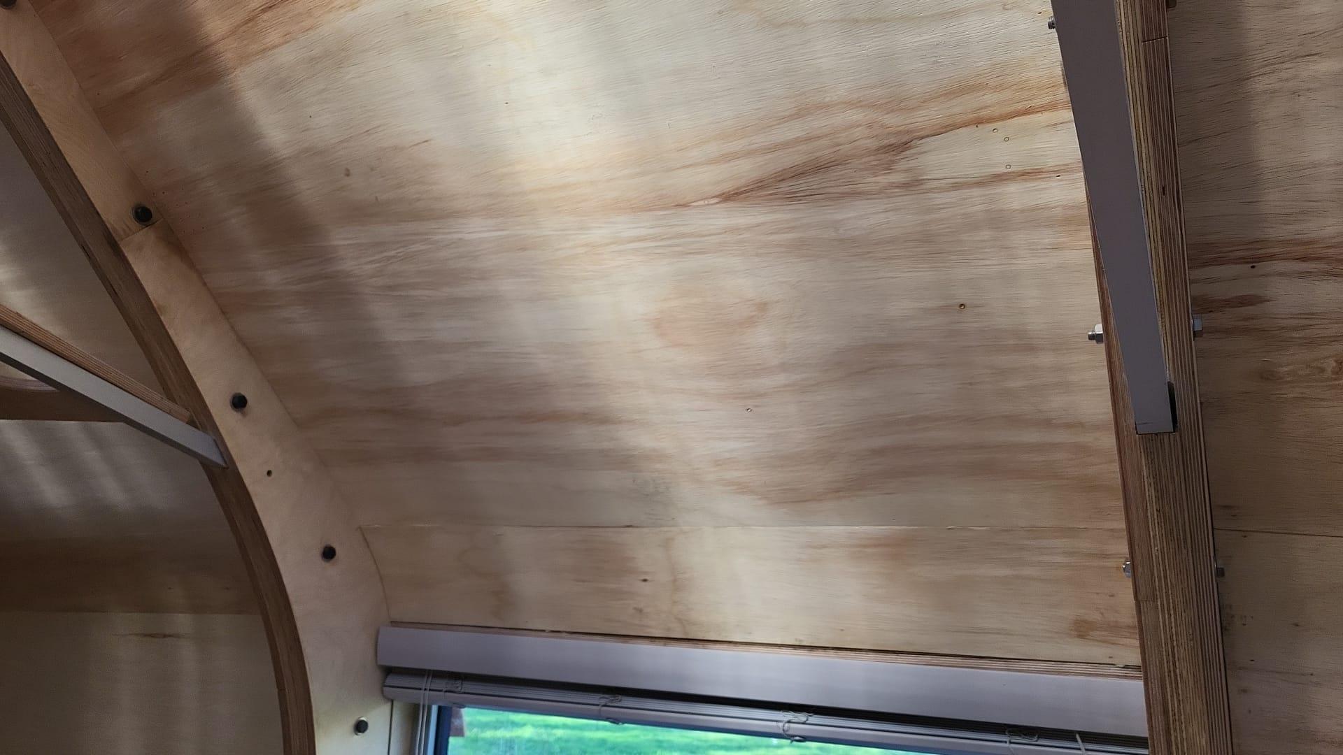

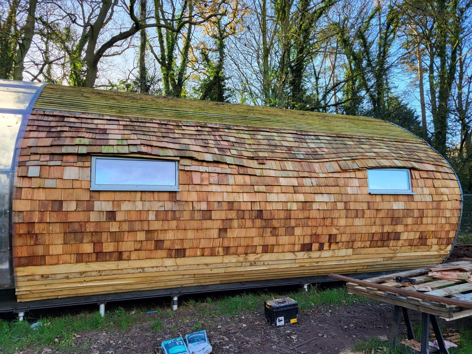

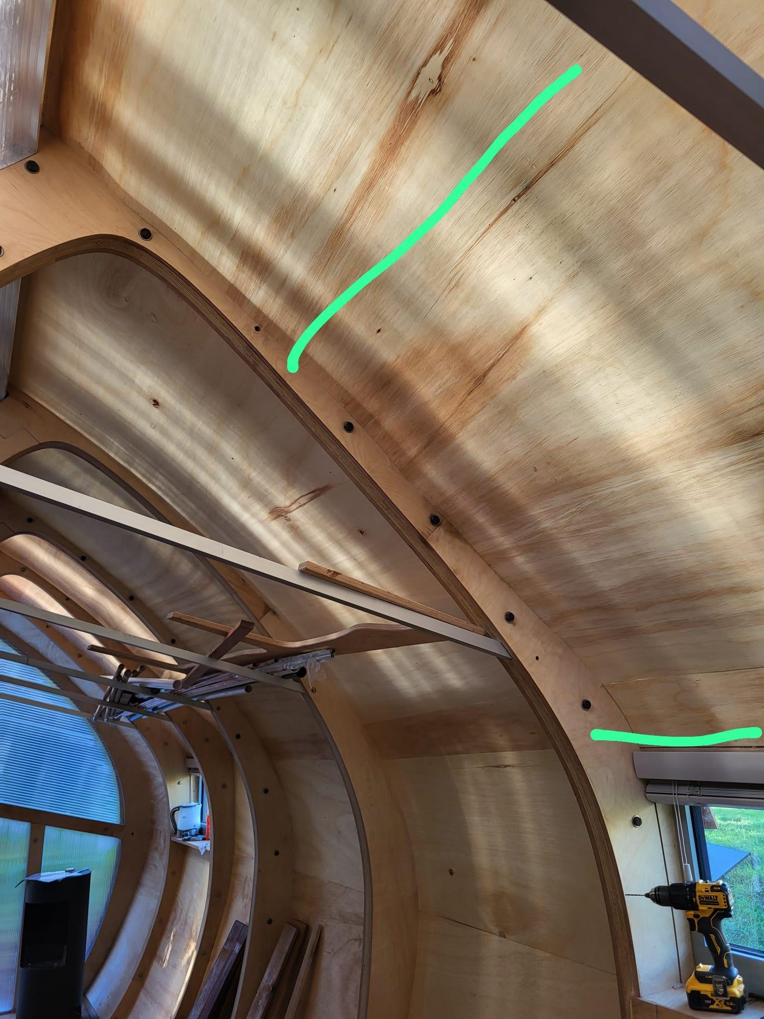

BadetBadarkos Posted November 23, 2023 Share Posted November 23, 2023 (edited) The issue I am having with mould. I would appreciate folks' thoughts and help. For context, we are based in the UK, and our construction system consists of; cedar shingles, cedar breather, felt underlayment, plywood, actis multi foil 90mm with an integrated vapor barrier followed by a plywood lining internal lining. Essentially, we're having some mould marks internally now. I am unsure whether this is caused by mould due to humidity levels being as high as 80% in the cabin continually for the past 2-3 months or if it is due to poorly fitted roof shingles causing water to run in? Were going to install a de-humidifier etc as a starting point. The issue is a roofer I spoke with today said we would need to rip the whole thing off and start again. Our shingle gauge is 150mm, but the roofer said this would need to be 125mm, which he believes is causing the issue. The roof has a pitch of 45° and 90°. Of course, we want to avoid this and would appreciate your thoughts. I have attached some photos including the interior that show the mould. Edited November 23, 2023 by BadetBadarkos Link to comment Share on other sites More sharing options...
SteamyTea Posted November 24, 2023 Share Posted November 24, 2023 Is the mould on the exterior north facing, so shaded? Not sure what the other pictures are showing. 1 Link to comment Share on other sites More sharing options...
BadetBadarkos Posted November 24, 2023 Author Share Posted November 24, 2023 Hey, the interior photos are showing where the mould is appearing, the exterior is green just from the trees. The main issue is the mould in the interior. Link to comment Share on other sites More sharing options...
SteamyTea Posted November 24, 2023 Share Posted November 24, 2023 I suspect you have not got the interior warm enough and this is keeping the RH high. So really sure how good Actis multifoil is in reality. How large are the gaps between the ceiling and the roof materials? 1 Link to comment Share on other sites More sharing options...
BadetBadarkos Posted November 24, 2023 Author Share Posted November 24, 2023 That's interesting, so you don't think it is caused by moisture ingress from improperly laid shingles? When do you mean the ceiling and the roof materials? There is a 10mm cedar breather air gap between the shingles and the felt - I have attached a link to the product we used. https://benjaminobdyke.com/product/cedar-breather-ventilated-underlayment/ Link to comment Share on other sites More sharing options...
