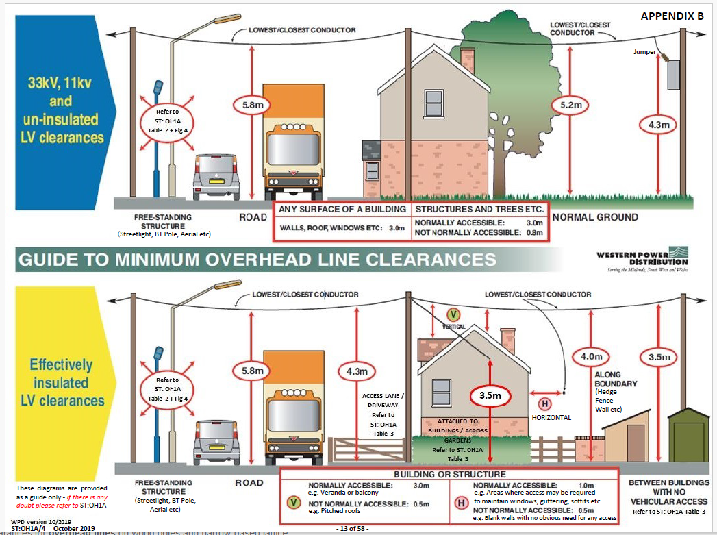

Not familiar myself but it could be they are correct. I found this which suggests 0.5m or 3m between cable and roof...
0.5m clearance for  roofs not normally accessed.
3.0m for accessible areas like balconies
Page 11 says
"Solar panels should be treated as normally accessible objects as per Item 1 of Table 2 in ENATS 43-08 or, where WPD is building or refurbishing a line over an existing solar farm, Item 2.1 of Table WPD 2 in Section 4 of this document."
https://www.nationalgrid.co.uk/downloads/63817

Thats some good info, much better than anything I've been able to find anyway. It seems a bit strange to me they may count solar as "normally accessible objects", especially as the installers won't do any work up there without shrouding fitted.
The national grid guy I've been speaking to on facebook reckons said "effectively insulated means a single layer of insulation I.e. ABC conductor (the main)" whereas mine is concentric double insulated so should not need any clearance.
