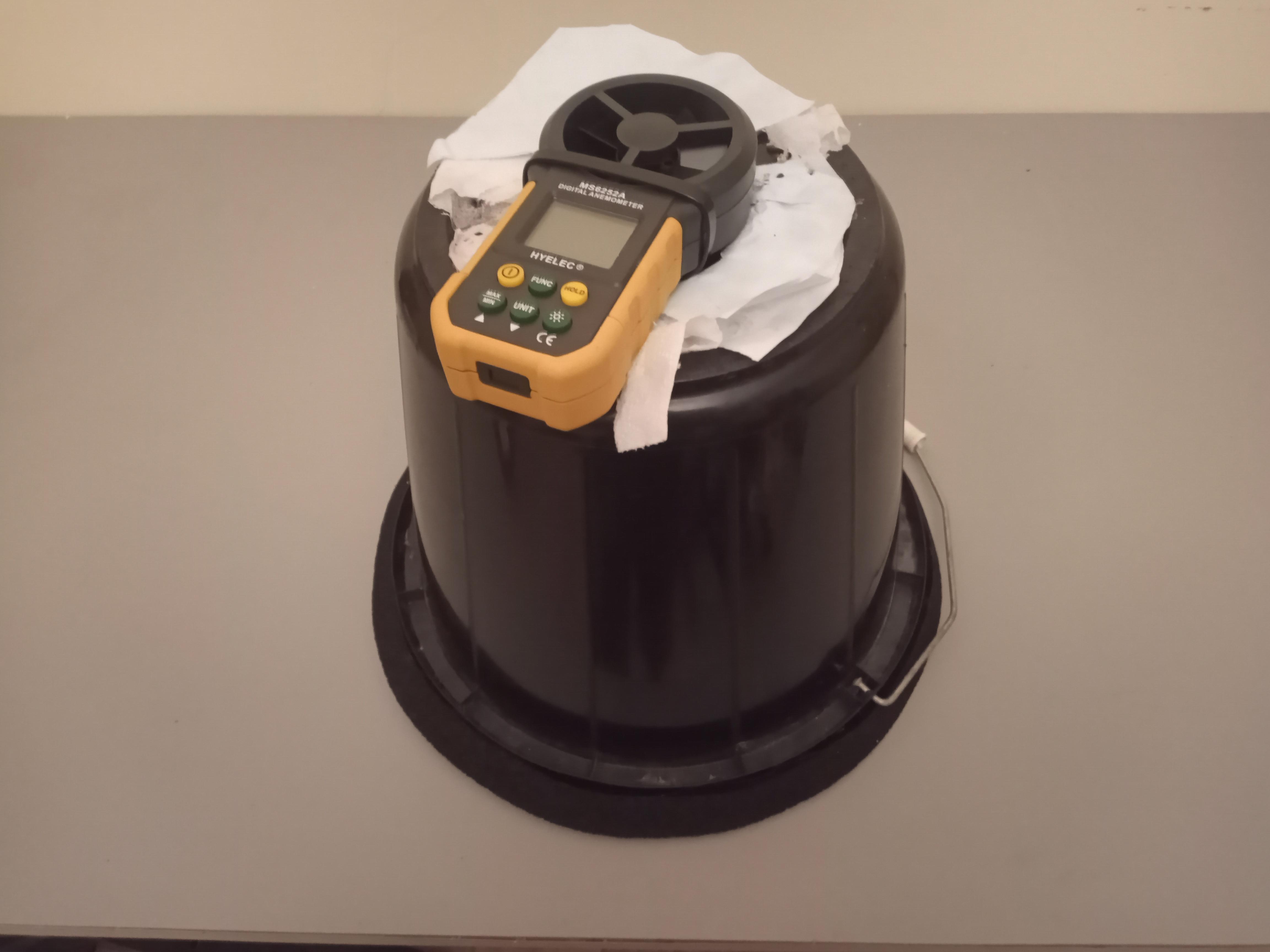

FrazK Posted December 13, 2023 Author Share Posted December 13, 2023 Got my system all installed now just need to balance it all. It's far from a perfect system, I'm sure the efficiency is very low, mostly due to the ducts running uninsulated down the roof void but also uninsulated connections in the attic that I still need to sort out. Still I'm very happy with it, it's been running nearly two weeks now and the house just feels fresher and less stuffy. I bought the unit used reconditioned off Ebay for £320 and spent less than £500 on all the ducting, vents, connections etc. Just need to decide if I should upgrade the filters now. I've bought a cheap anemometer off Amazon for the balancing, I'm sure it'll be far from perfect but hopefully enough to roughly balance the system. Anyone tried it before? Am I just wasting my time? Link to comment Share on other sites More sharing options...
Coanda Posted December 13, 2023 Share Posted December 13, 2023 16 minutes ago, FrazK said: I've bought a cheap anemometer off Amazon for the balancing, I'm sure it'll be far from perfect but hopefully enough to roughly balance the system. Anyone tried it before? Am I just wasting my time? I balanced mine up with the aid of an anemometer bought off ebay, a plastic bucket with a hole cut in the bottom and a sponge seal around the top. I had to add a speed controller to one of the fans as it was more powerful than the other. I wasn't too difficult. I've got some mods to do so I'll be doing it all again soon. 1 Link to comment Share on other sites More sharing options...
FrazK Posted December 13, 2023 Author Share Posted December 13, 2023 Mine looks very similar to yours. I went with a plastic pop bottle but it's too small so was trying to work out what else I could use, I like your bucket idea! Link to comment Share on other sites More sharing options...
Coanda Posted December 13, 2023 Share Posted December 13, 2023 I had the bucket left over from drilling the ceiling holes. I put my hand up through the hole with a sealer and held the drill inside while I drilled the holes, the bucket caught the dust. Link to comment Share on other sites More sharing options...
