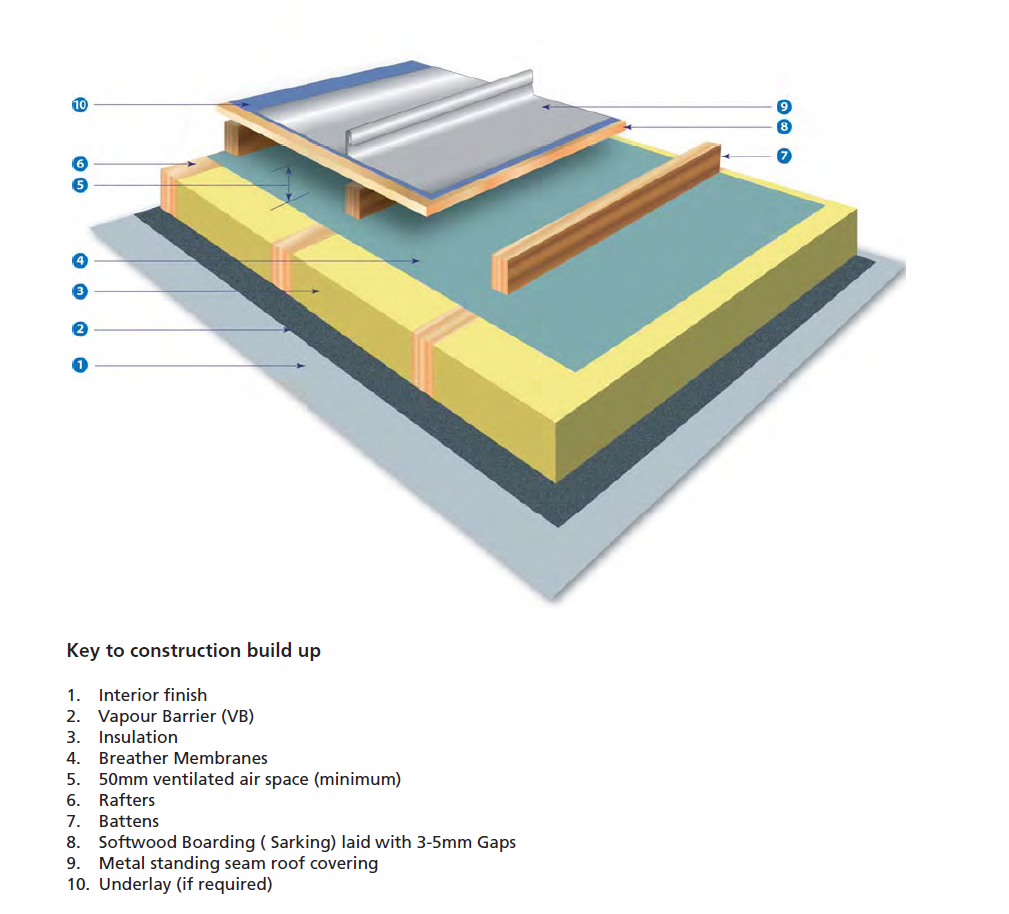

Our roof buildup is like this:
... which is from the good practice guide for metal roofiing (FTMRC).  The standing seam company have understandably requested same buildup from our roofers.
Instead of using ply on top of the battens we are usaing timber sarking board, but this came from the metal roofers as they think it is a better option than ply.

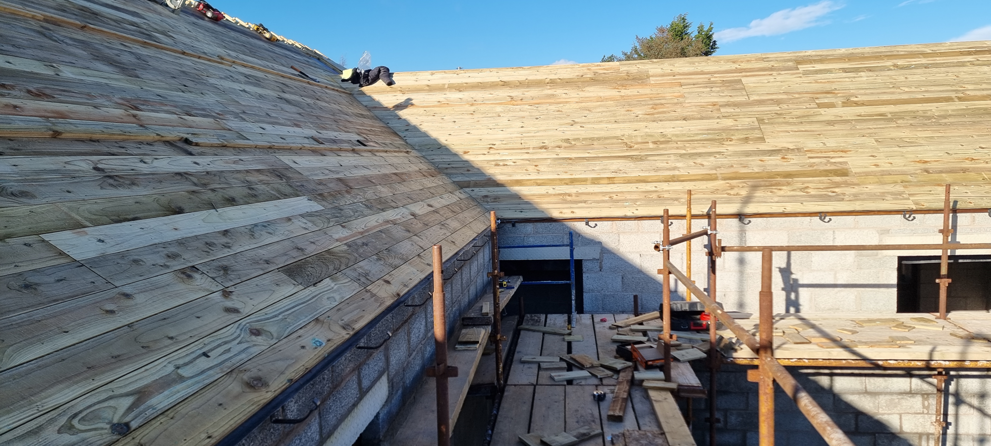

The sarkng looks great, almost a shame to cover it up.  Like this:
I have been told that the membrane that will go between the sarking and the standing seam will be waterproof.  Not just a debonding layer.  I hope so because right now storm Debi is pulling those un-taped laps away from the nail holes 😫

Ah ok so there's a second membrane to protect the sarking.
I did a corrugated steel roof but only used one membrane. I wonder why standing seam is different.
