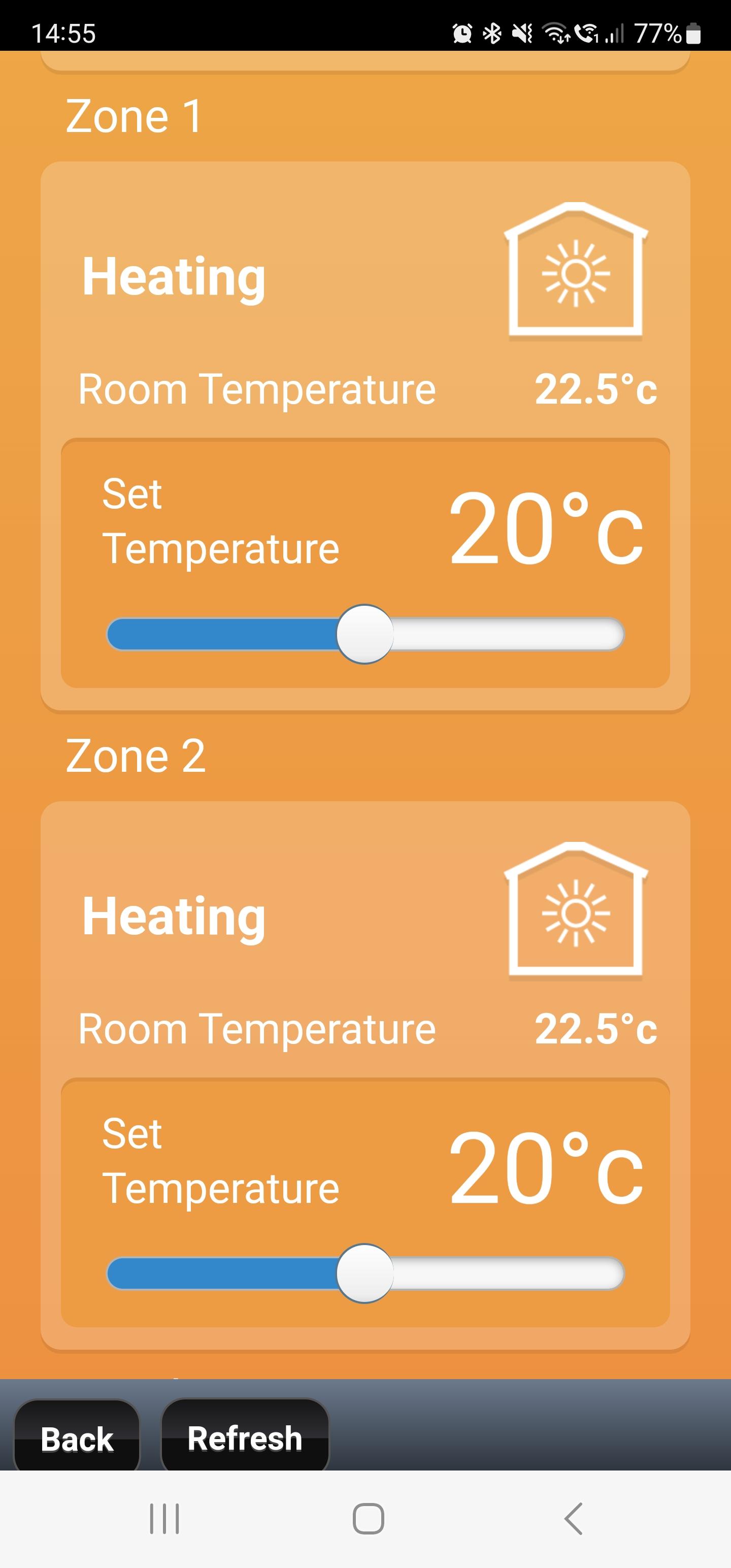

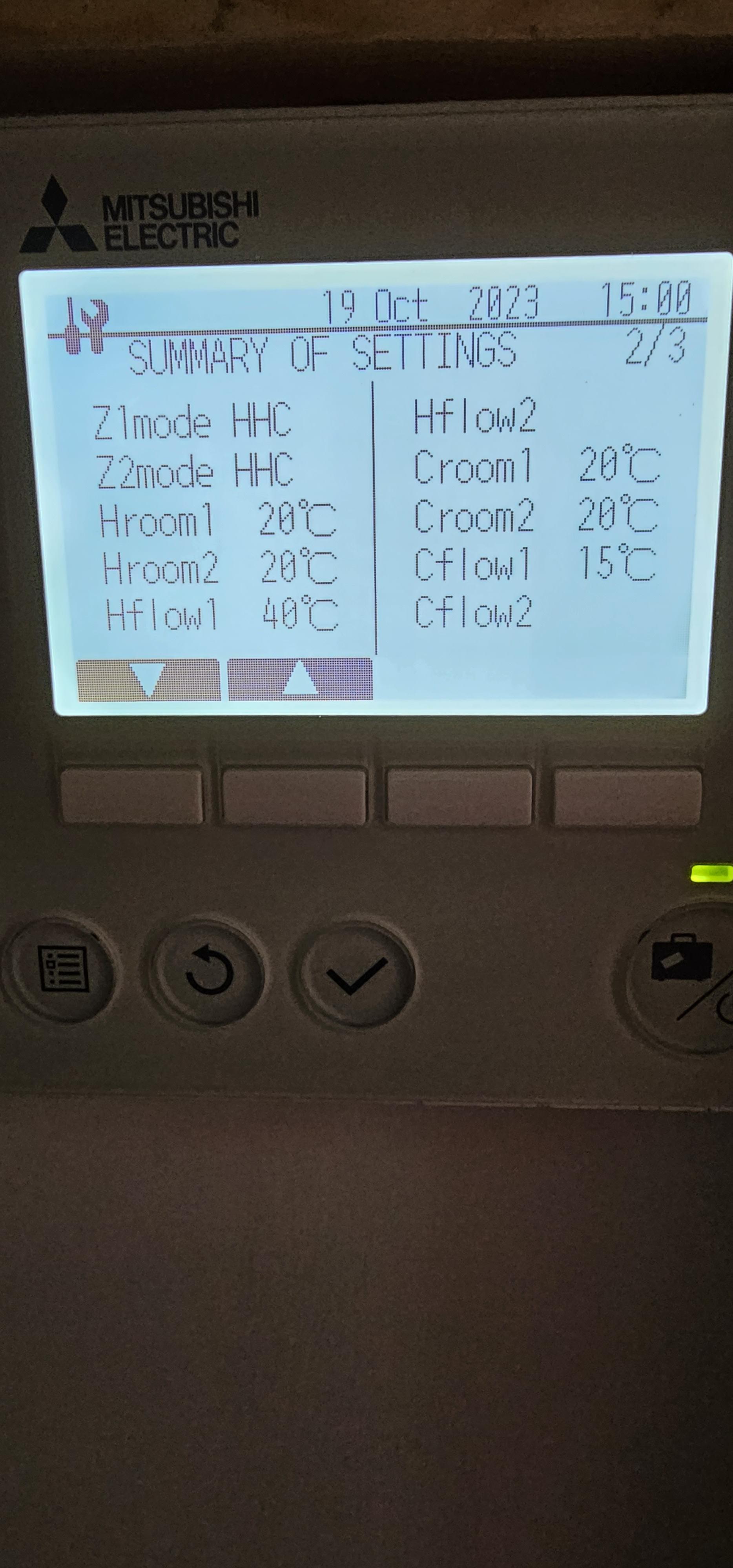

athlonoc Posted October 19, 2023 Author Share Posted October 19, 2023 Just a secondary question with the MEL Cloud App. Both zones (zone 1 and 2) appear to be on indicated by a sun symbol. But all of zone 2 (downstairs UFH) is at room temp so shouldn't be onand isn't according to the FTC6 controller but is according to the Mel Cloud App. Zone 1 is the upstairs rads and it's this stat that is set to heat upstairs at a higher temp but is cutting out on this occasion. The app shows two room temps at 22.5 and the set temp at 20. Can you confirm if they should or can override the rooms stats around the house? Reason I ask this is when looking at the summery settings on the FTC6 , page 2 of that menu has two temperature settings - HRoom1 & HRoom2 These temp settings change when the settings on the app are changed for each zone. So are these independent temp settings from the actual room stats? Link to comment Share on other sites More sharing options...
sliderule Posted November 10, 2023 Share Posted November 10, 2023 As your MELCloud shows the same 22.5C for both zones, I'm guessing that your room thermostats are not the source of those readings, and the 22.5C is coming from the thermostat inside the little FTC box (mounted on the bigger FTC controls box, near the Hot water cylinder?). If you are on room temperature mode, then the heat pump will be controlled by those temperature readings. Try using the Weather Compensation mode if you are not already, as that will ignore the "room temperature". See YouTube videos on how to adjust. Don't lower the WC curve too much or the HP will cycle on and off frequently (bad). Too high and you will be spending more on electricity. I'm not sure about the settings you show, perhaps you should talk to mitsubishi if you still have a problem. Link to comment Share on other sites More sharing options...
