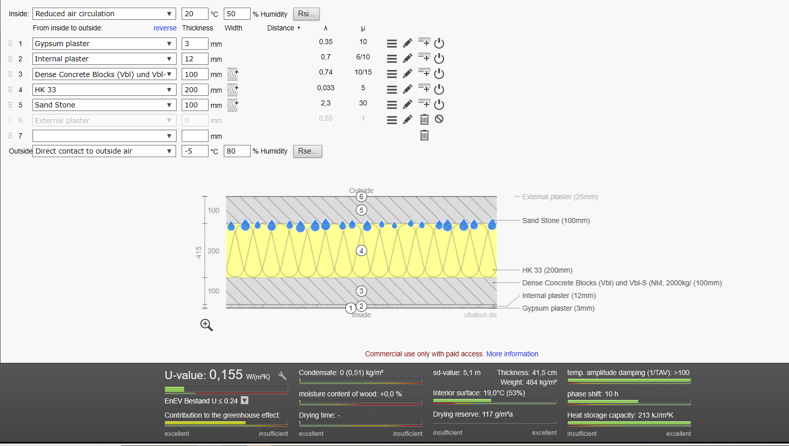

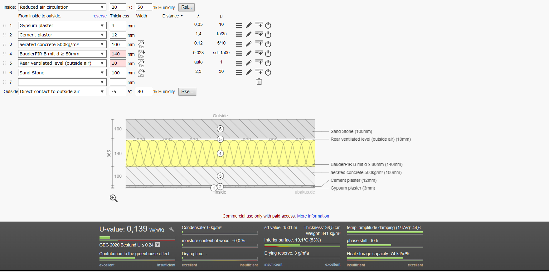

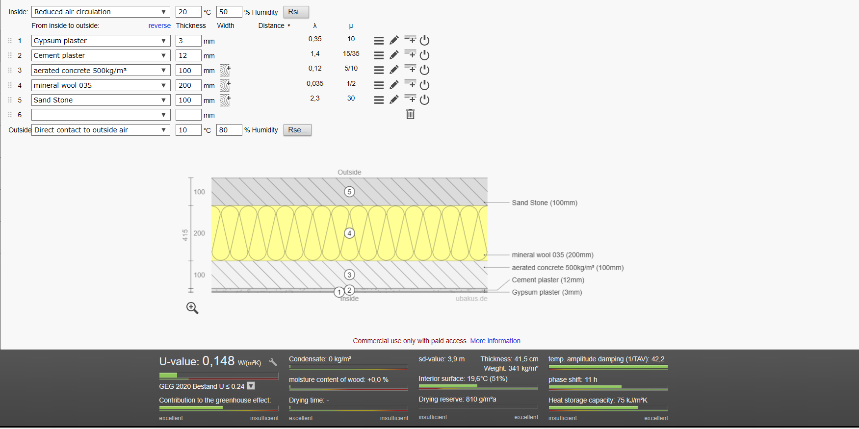

If it's this I would suggest it's equivalent to engineered stone.
I am against PIR boards in cavity walls.
Preferable in my opinion to use a wider cavity with 2 x layers of mineral wool batts or EPS blown beads. AHA Denby Dale Passivhaus.
The Golcar Passivhaus: Denby Dale mark 2
I would just use standard blocks internally too. Less cracking and cheaper. They add almost nothing to the thermal performance compared to including slightly more insulation.
What I'd suggest.
Plenty of free U-Value calculators online or you can do it by hand. No need to feel compelled to use a manufacturers detail.
