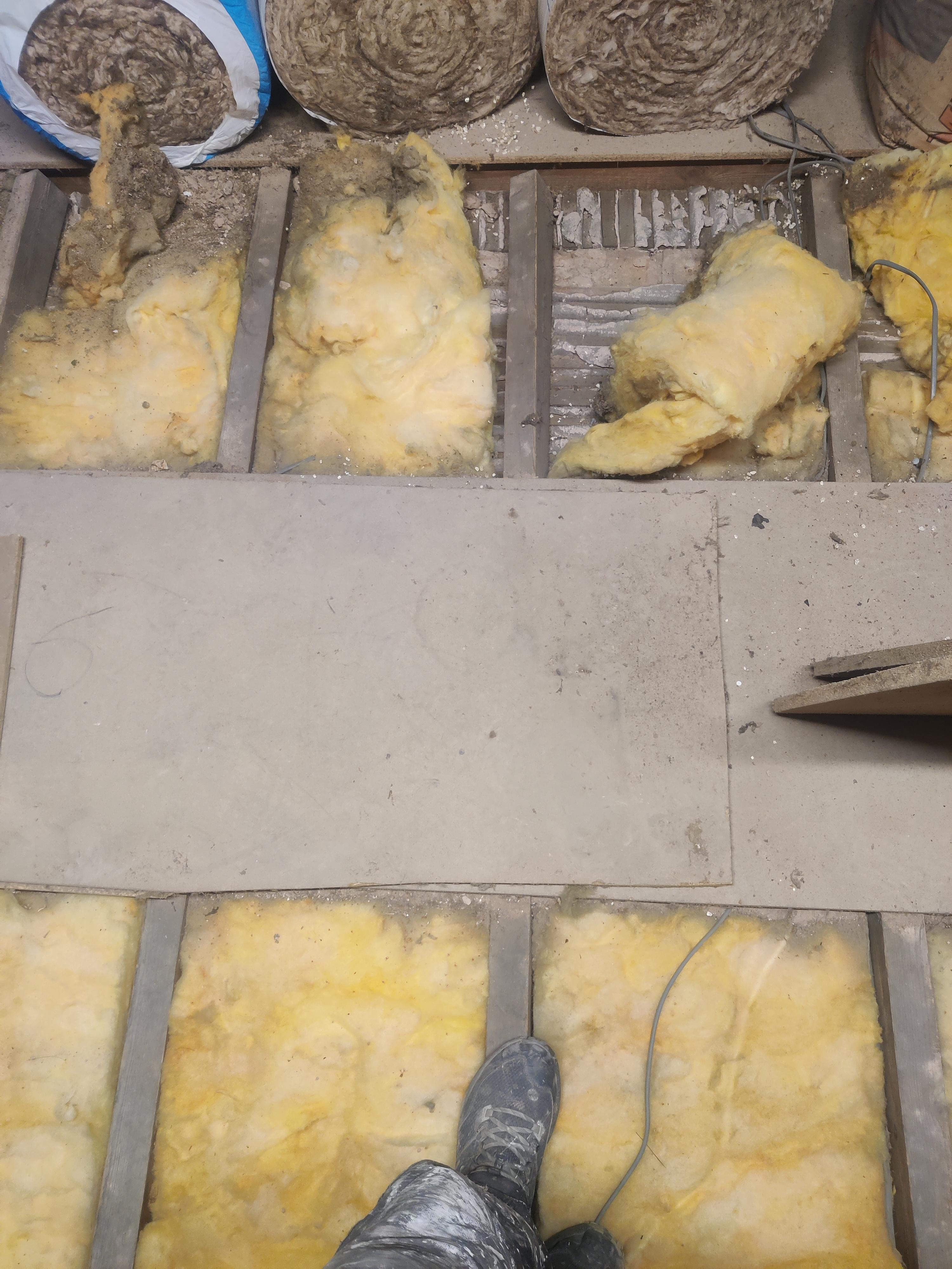

Alexm1992 Posted October 16, 2023 Share Posted October 16, 2023 Im about to overboard with insulated plasterboard an existing top floor lath and plaster ceiling. I just popped up the loft to check out the joists and mark up where the joists sit so that I can be sure to fix directly into them ... But we've got a problem... You will see from the photo that a few of the joists have twisted over the years, and quite badly. The joists are fairly straight until about mid way into the room (just behind my feet) then they twist as they approach the internal load bearing wall. With the additional weight of the plasterboard this will only make things worse with time. Any advice on the best way to fix this or beef up the joists? Thanks for any advice 🙂 Link to comment Share on other sites More sharing options...
Mr Punter Posted October 16, 2023 Share Posted October 16, 2023 Could you fit some noggins between them on the line of the supporting wall? Link to comment Share on other sites More sharing options...
Alexm1992 Posted October 16, 2023 Author Share Posted October 16, 2023 This is definitely possible and I suppose would restrict further twisting but is anything additional required to strengthen these joists along there length? Cheers Link to comment Share on other sites More sharing options...
