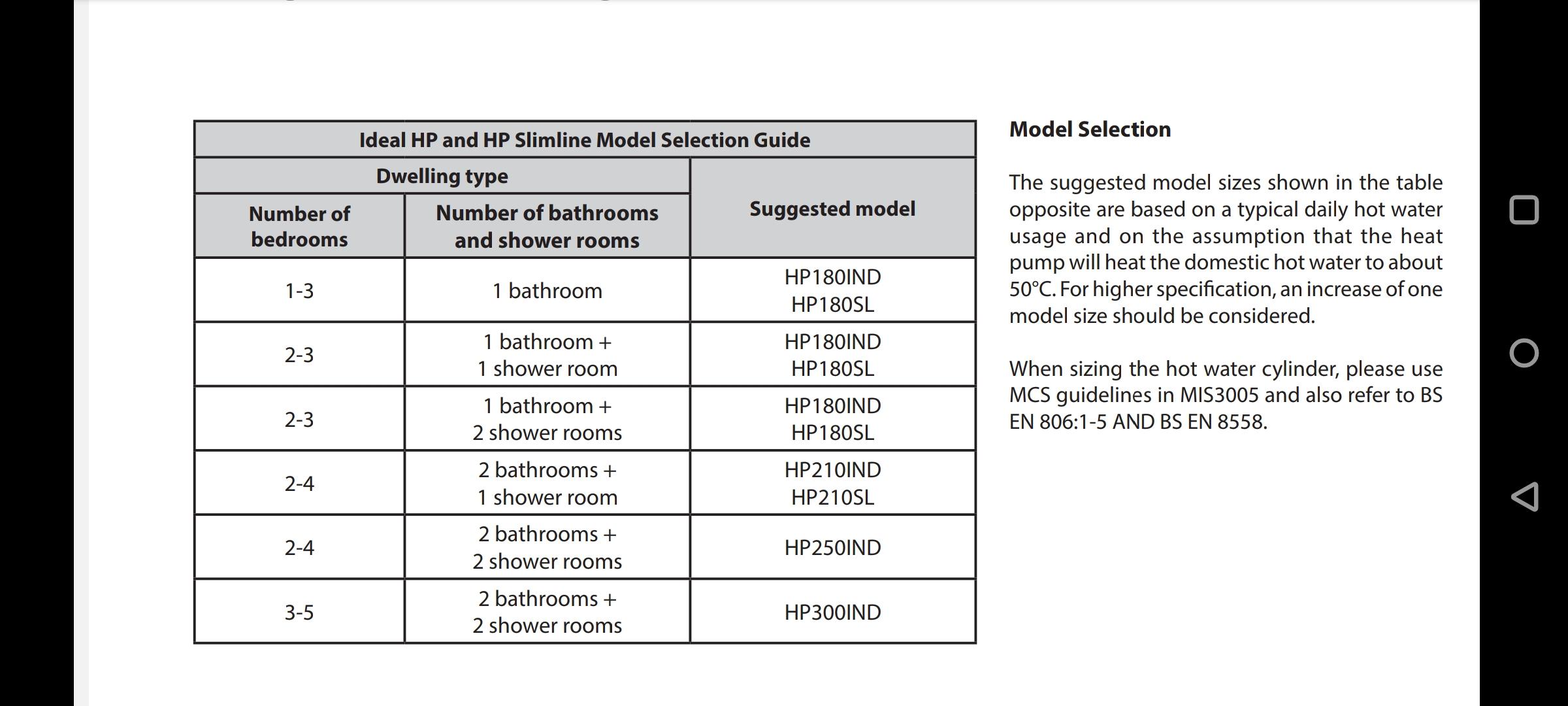

Nic Posted October 7, 2023 Posted October 7, 2023 My question ( as an uneducated man ) if I go for a ASHP in a new ICF build for my DHW ( there are three adults one of which likes a soak in the bath a few times a week) is there a better cylinder for ASHP …. What do I need to know ?
JohnMo Posted October 7, 2023 Posted October 7, 2023 Get a cylinder with a heat pump coil about 3m2. And size the cylinder appropriately. All cylinders are pretty much equal, just capacity difference and coil sizes. 1
Nic Posted October 7, 2023 Author Posted October 7, 2023 @JohnMo I’ve only noticed coil ratings not sizes … is that likely to be in the tech sheet somewhere?
JohnMo Posted October 7, 2023 Posted October 7, 2023 Look at specific heat pump cylinders, if it doesn't state the coil size move on. Ideal cylinders are made by Gledhill, but sold considerably cheaper. 3m2 coil Telford heat pump cylinder 3.3m2 coil. Sizing guide for heat pump cylinders 1
