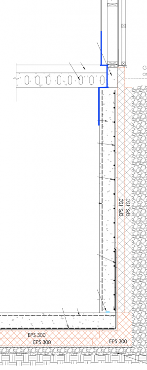

Thanks @Thorfun - I took the opportunity to read through all the way through your blog, which is interesting and informative.
Is this your basement cross-section? It wasn't in the blog, but I think I made a note from another thread.  It would be great with the annotations :)
most of those annotations are to do with our structural engineering design so won't be pertinent to your build up as your SE calcs will be different.
