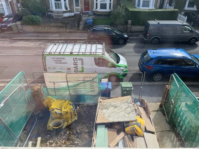

nmh Posted September 24, 2023 Share Posted September 24, 2023 We’ve a Victorian semi in SE London and are clearing the ‘front garden’ for a car parking space. Southwark will drop the kerb if we meet the various requirements (permeability etc). We are, believe it or not, keen gardeners and would like to keep as much ‘greenery’ in the driveway as possible. Wondered if anyone had any experience of something like: https://www.pavingdirect.com/grasspark-permeable-paving-grid Have read on here that the plastic grid systems can chip and wear easily - any truth in this? Any thoughts, experience, advice much appreciated. Shot of site attached for reference (currently housing a skip)! Link to comment Share on other sites More sharing options...
