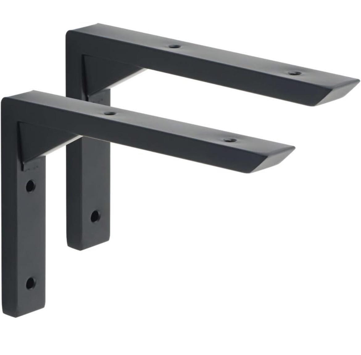

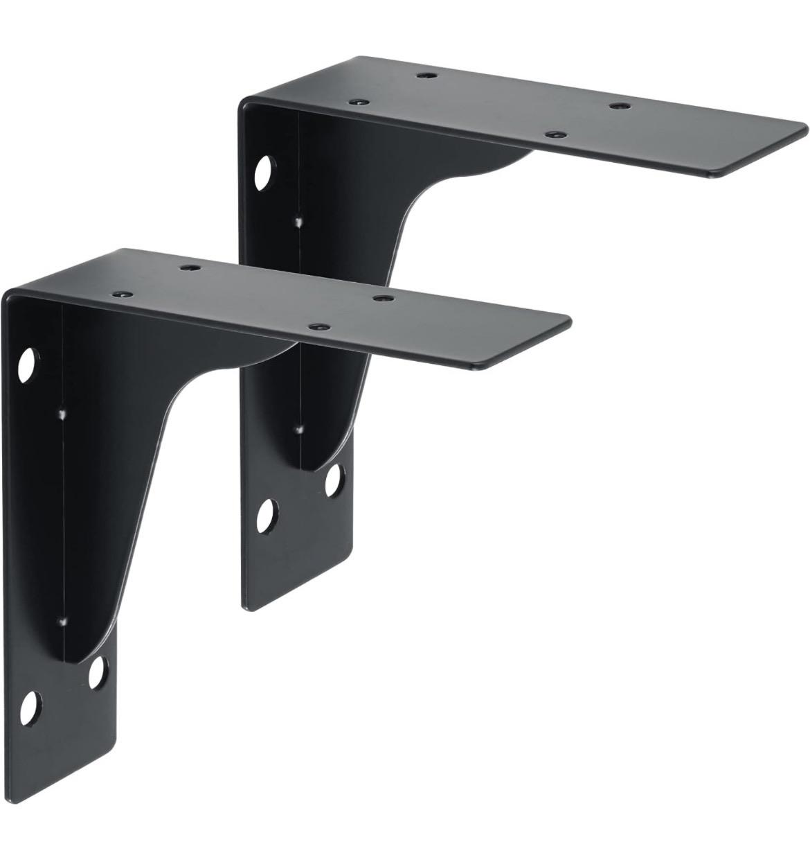

ashthekid Posted September 17, 2023 Share Posted September 17, 2023 Which of these two types of wall bracket would be stronger to hold glass shelves? The wider one or thicker one? or would both do the job equally as well as eachother? Wider Thicker Link to comment Share on other sites More sharing options...
Andehh Posted September 17, 2023 Share Posted September 17, 2023 Both look fairly heavy-duty for a spread load. What are they holding up on said shelf? Link to comment Share on other sites More sharing options...
ashthekid Posted September 18, 2023 Author Share Posted September 18, 2023 DVD player, games consoles etc. nothing crazy heavy. Link to comment Share on other sites More sharing options...
markc Posted September 18, 2023 Share Posted September 18, 2023 1 hour ago, ashthekid said: DVD player, games consoles etc. nothing crazy heavy. Doesn’t need anything heavy duty then, main thing with glass is stopping the shelf flipping over so support needs to come out full depth of the shelf (unless you are drilling the glass and fixing down at the rear). Link to comment Share on other sites More sharing options...
