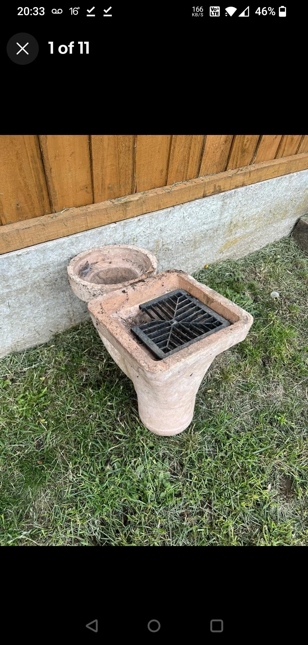

Finally got going on our patio renovation today. Seem to have uncovered a plethora of drains, and could with some suggestions on how to proceed please.
We've uncovered a double drainage gulley as shown. The gulley is cracked and unusable, so looking for a suitable replacement. We only really need the part for the downpipe to go into, not both parts. What are my options?

In plastic you would either use a back entry gully and a 90' to bring the 110mm pipe vertically or move the gully closer to the wall and put the downpipe into the grate on actual gully
