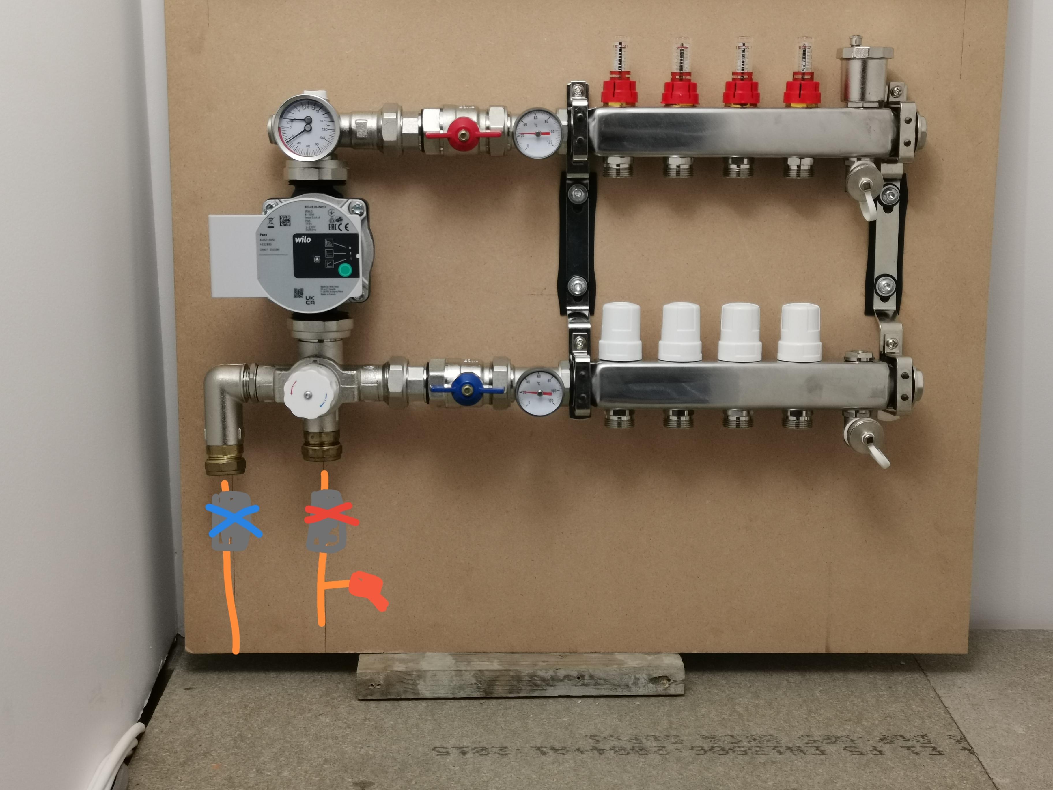

Hello ladies and gents.
I'm going to add butterflies as marked in the picture but having a mental block as it's been a long week. Should I add a drain to both the flow and return as well or just the flow or not at all?
Cheers!
I'd put a drain at the lowest point in the system you can.
Just whack one on the flow? That's as low as you're gonna get above floor level.
What about using the 2 that already fitted at the end of manifolds, just screw hose adapters to them when required?
Good shout. So just close off all the loops and open the drain? Seems a better option all round.
