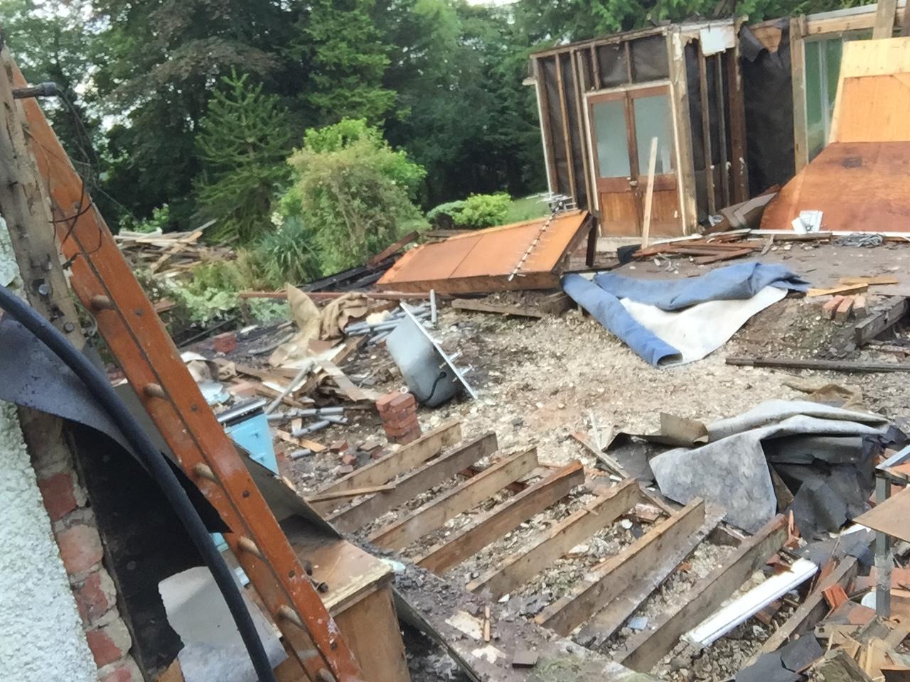

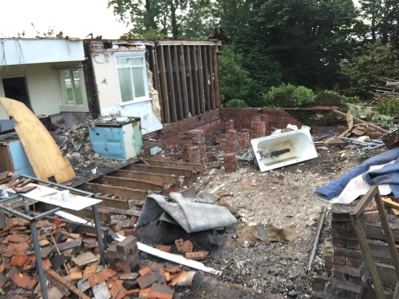

The demolition is nearly completeIMG_0290.thumb.JPG.b4014429bab56b149917cc17f4cfaa75.JPG
I've arranged for our local 'man and machine' to bring his 12 tonne machine to dig out the basement, the garden on the far side drops away quickly, so we'lll have a walk in basement where the old house stood.
