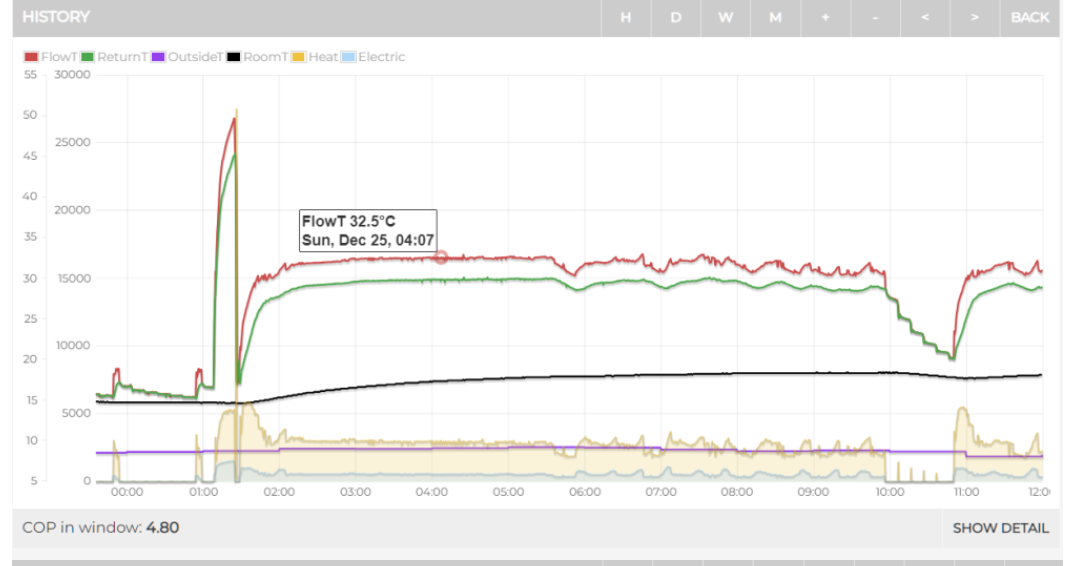

Many post graphs like this, presumably from openenergymonitor.
Has anyone worked out the most cost effective/simplest way to extract the data from a Vaillant heat pump?  It appears they do a modbus interface, but it might be just a simple to buy the current clamps/heat meter that openergymonitor recommend.  Any tips would be welcome, I dont want to be flying blind.
