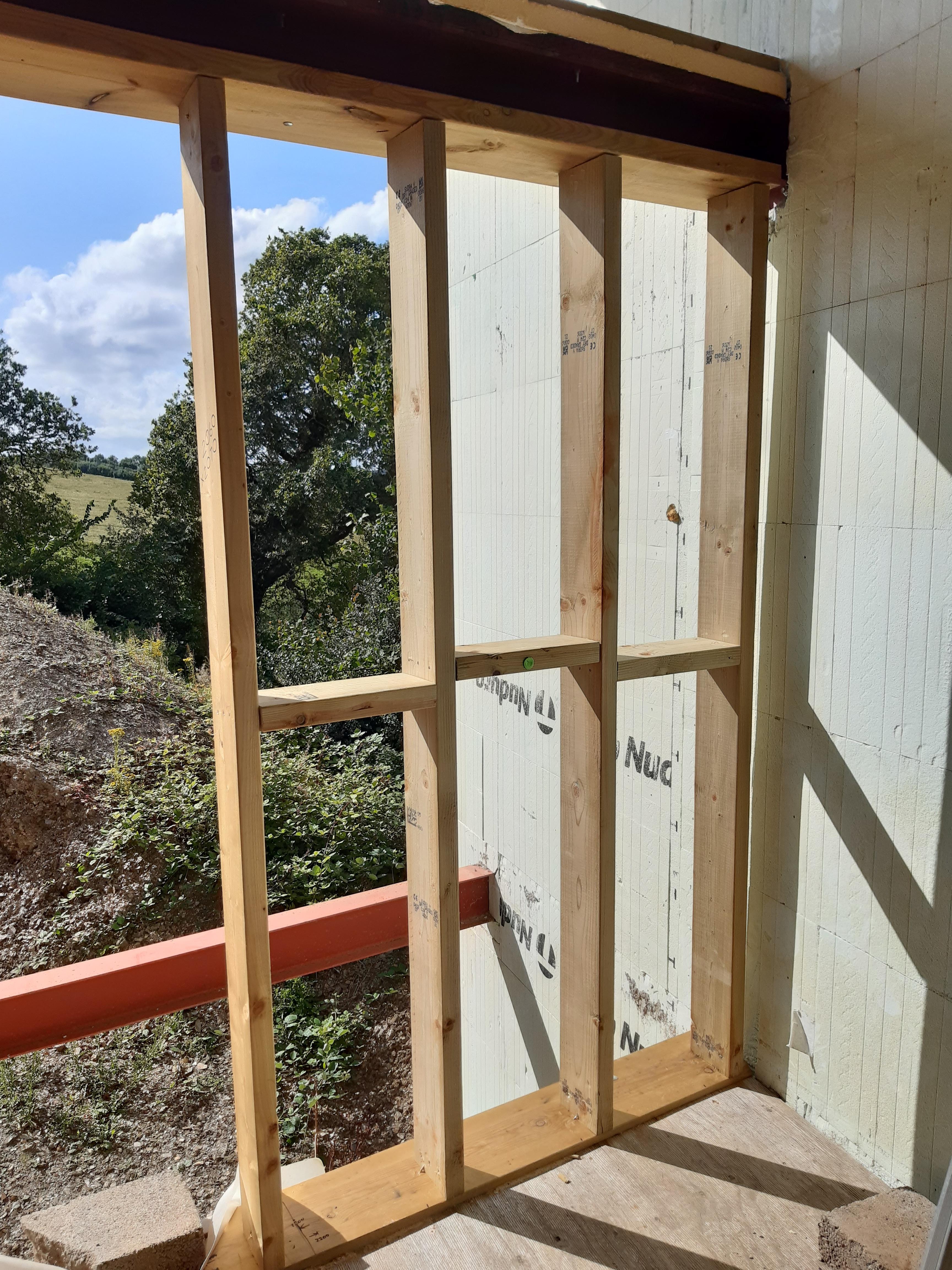

Hi all,
I have built some external frame walls (studwork) below and alongside some windows. My question is what sheet material should I use on the outside (exterior) of the studwork?
The exterior will be clad, most likely, using stone slips, the build up will be:

To help, here is a picture of one such studwall - the gaps will be filled with PIR and foamed round, ( outseide lat

One issue will potentially be the weight of the stone slips on a timber framed structure.
If you are doing rainscreen cladding on a timber frame you need a minimum 25mm strongly vented air gap between the sheathing and the cladding.
I think you should be looking at a proper system with BBA approval.
