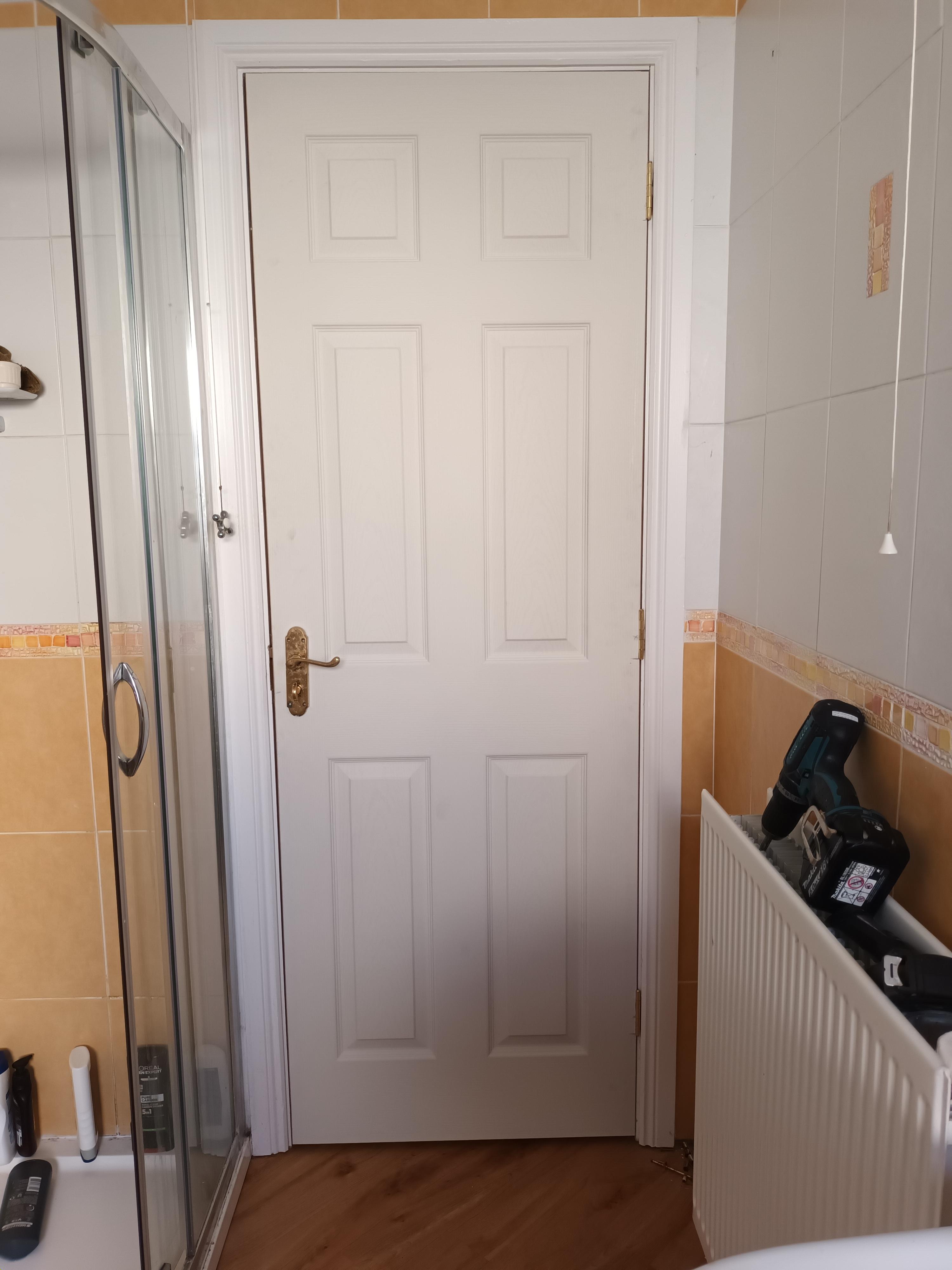

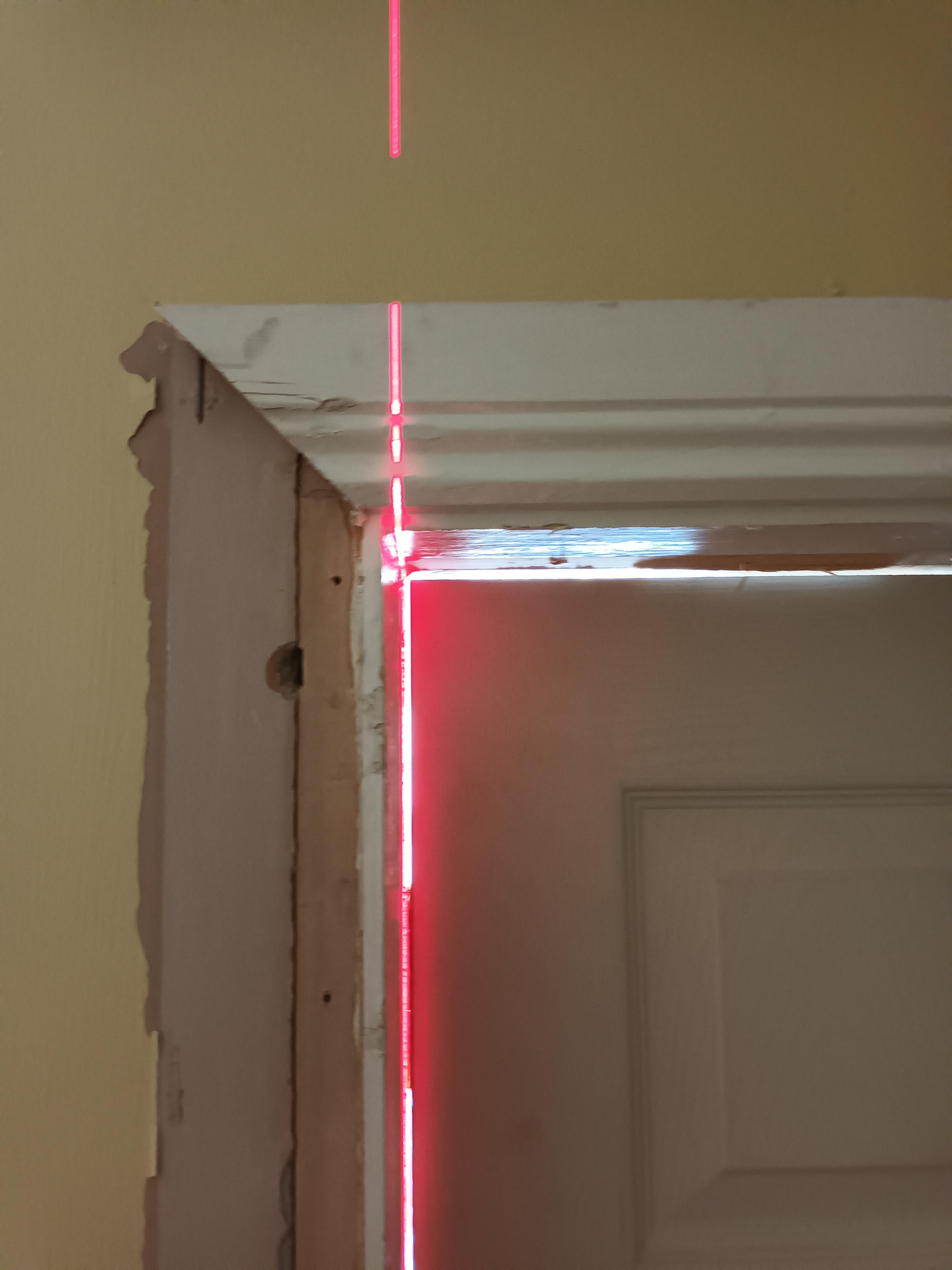

Craftsman22 Posted July 24, 2023 Share Posted July 24, 2023 (edited) Hello I've an issue with my bathroom door I recently replaced in the photo there wide gap at the top and smaller margin at the bottom on the lock side , I put the laser on the hinge side and it considerably off square, is my best option to take the nails out that the frame that theyve nailed to the wall at the hinge and lock side and put wedges at the top of the hinge behind the door frame and the middle to move it in line and replace nails with 72mm concrete screws ? Edited July 24, 2023 by Craftsman22 Forgot last photo Link to comment Share on other sites More sharing options...
Dave Jones Posted July 24, 2023 Share Posted July 24, 2023 check both sides, also check they haven't already planed the door. Link to comment Share on other sites More sharing options...
Craftsman22 Posted July 24, 2023 Author Share Posted July 24, 2023 Yes I'll do that, would I still get away with packing that side out and putting in concrete screws Link to comment Share on other sites More sharing options...
