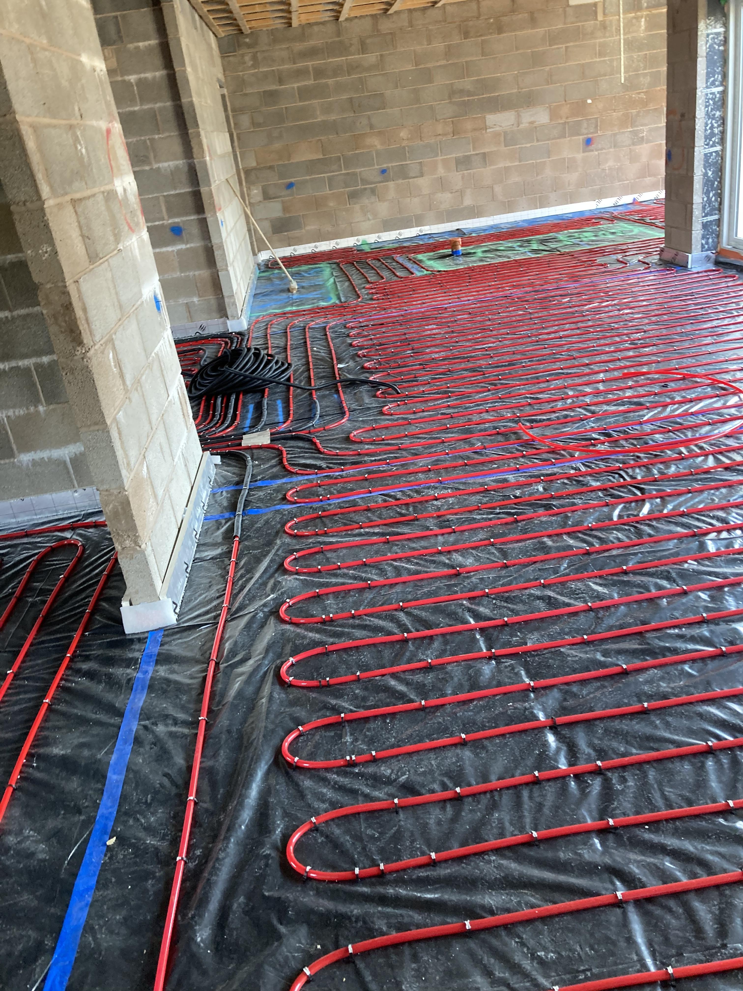

Hi everyone,
Just a query on what brand of tape to use to join DPM to DPM on top of a beam and insulated block floor. The areas are  larger than 4 m  so I need to join the DPM in places This is basically just a separating layer between the EPS blocks and the Cemfloor topping but the warranty guy today said that he wants to see the DPM taped at the joins which is fair enough.
I have used some poor quality double sided tape in the past so was looking for a product that someone can recommend.

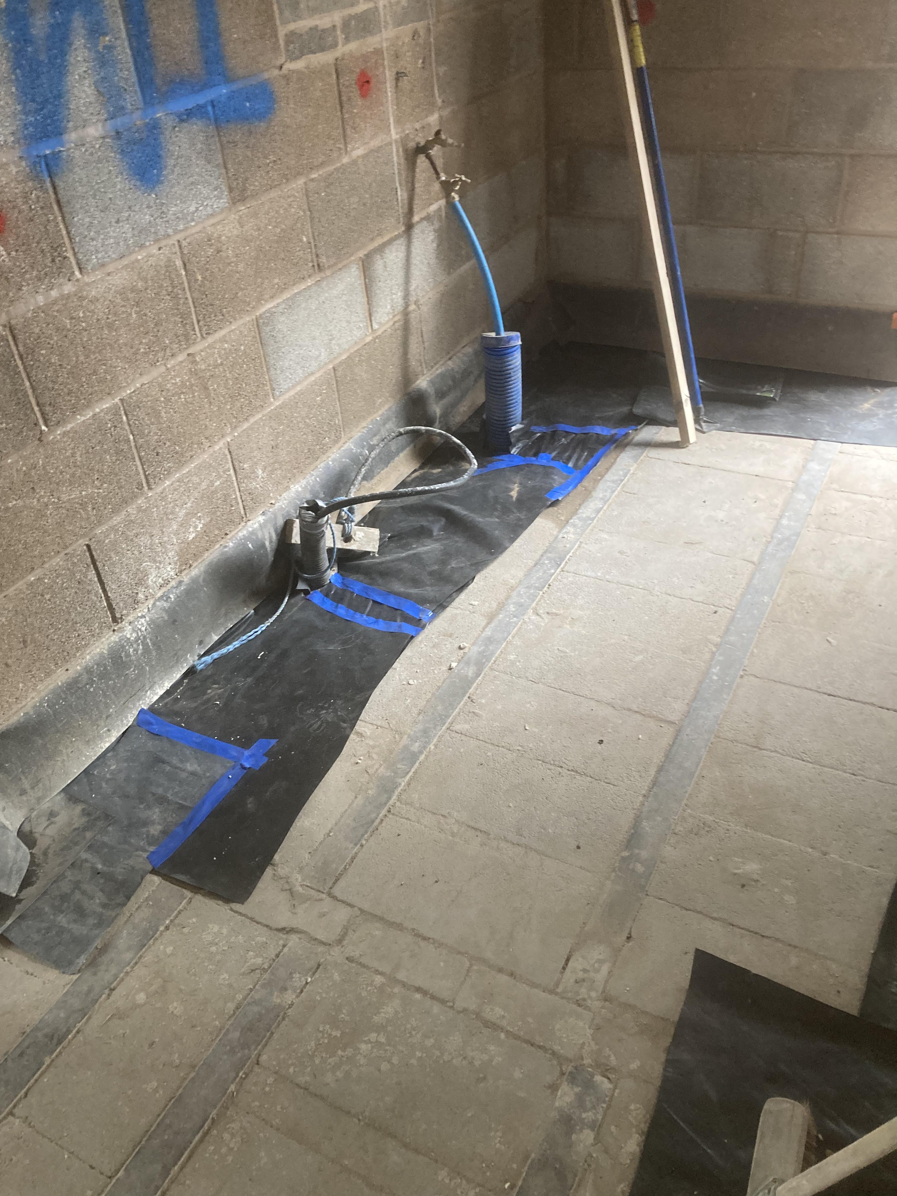

I’ve just done ours this week
Render tape is cheap and sticks like S**t to a shovel
The blue is Dolphin Orange Jaffa
Membrane and taping Curtesy of my wife But I did take all the photos 😁
