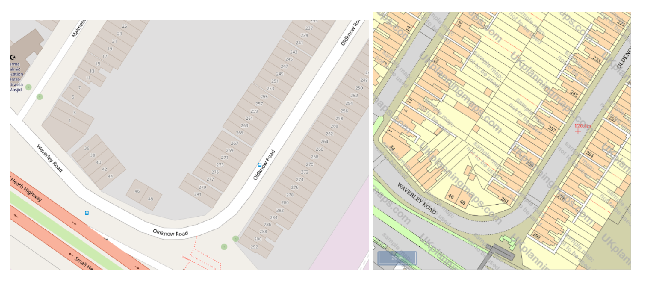

BigBub Posted October 8, 2023 Posted October 8, 2023 Whilst you could use Open Street Maps to produce a site location plan, many Council's will require the location plan to use an up to date OS map. The OS maps are much more accurate and detailed than Open Street map, and will also generally show the site boundary which is not really shown on Open Street map. See comparison picture. There is the INSPIRE Index Polygons spatial dataset which you can download and add on to QGIS on top of Open Street maps though which helps show site boundaries based on freehold property registrations.
