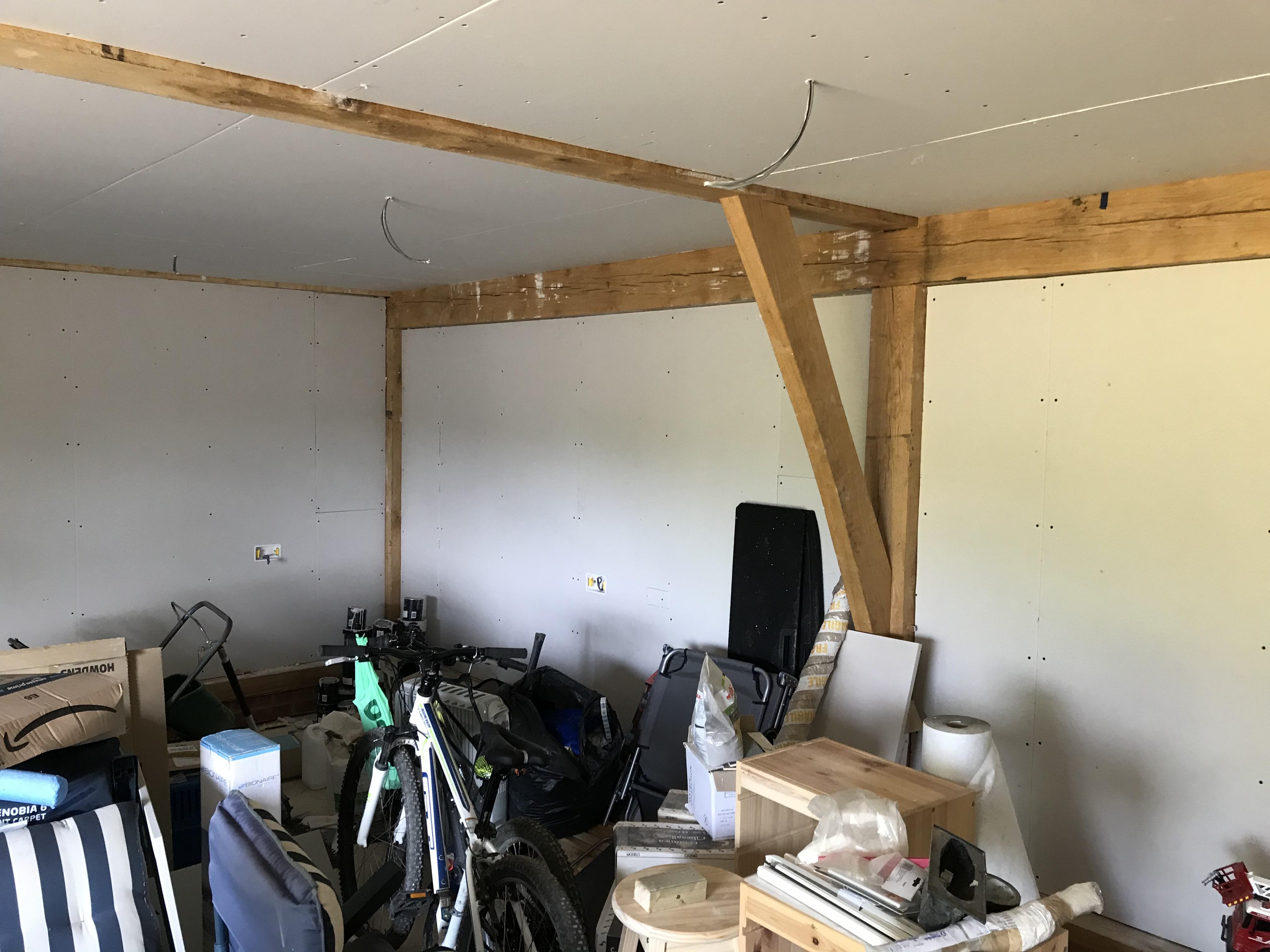

Morning all,
We are having our oak frame garage plastered in a couple of weeks.
Would it be work masking the timber off to avoid it getting covered in plaster?
Not sure if plaster ends up on the wood will it stain/ mark it?
If so are there any pointers for cost effective masking? Normal tape seems to peel off the wood after a short time!
 Cheers for any pointers
Render rough surface tape (Jaffa)
Thankyou, take it that shouldn’t leave any residue on the timber?
No
leave up to a week
