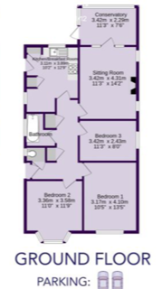

Question is simple, if you had around £120k, what do you think could be achieved? We are considering:
1) Taking the cloakroom road to open up the hallway and make space for a staircase.

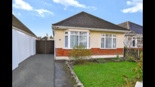

2) Bring the front the flush with outside and install small sidelight.

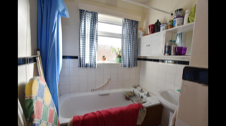

3) Square of the bathroom downstairs and turn into shower room.
4) Retain all 3 bedroom at the front.

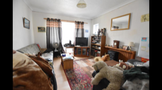

5) Extend 3m out but retain wall in between living room and kitchen.
6) 1 window and French doors on the back.
7) Ideally hip roof onto hip-to-gable roof conversion upstairs.

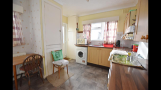

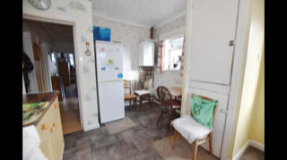

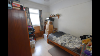

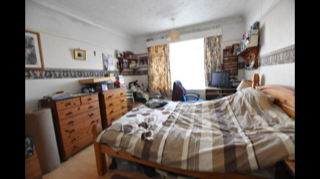

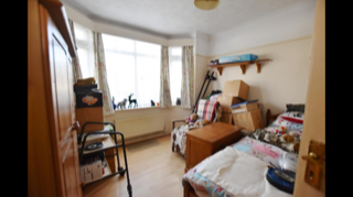

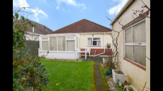

8 - Use space in the kitchen to create a utility room next to a bathroom.
9 - Upstairs flat roof dormer on one side above the bathroom to allow for upstairs bathroom with a bath, headroom for staircase and extra room in the front room that would retain hip roof at the front
10 - Hip to gable at the back.
11 - 2 velux in both rooms.
