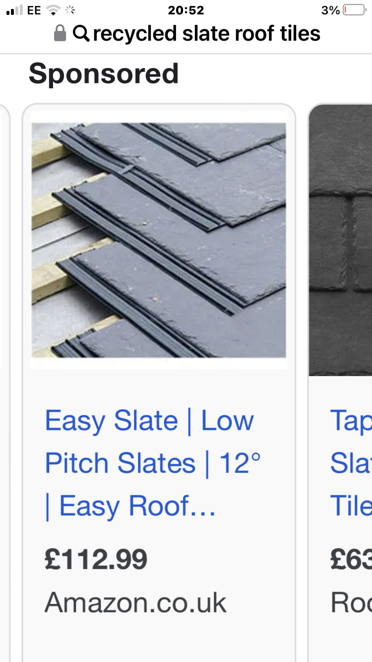

I do quite a bit of work for a company that uses the recycled Tyres Slate lookalike There not cheap but interlocking and look superb
I have a maintenance contract on a site that was done about 18 years back They still look grate
