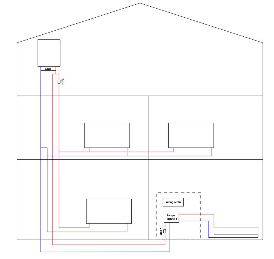

Super_Paulie Posted May 9, 2023 Posted May 9, 2023 after getting my domestic water sorted, cheers gents, https://forum.buildhub.org.uk/topic/32853-dhw-manifold-arrangement-options/ ive now moved onto the UFH. As my manifold is going in my bunker and the boiler in the loft it raises a few issues with the dedicated feed and return for the UFH. Am i better off doing as shown in the (simplified) diagram? that is bringing both the 2 ports down to the wiring center and then going back up for the rads. Also the return, i believe i need that "tapped back in" above the last rad in the house to avoid reverse circulation, so is the diagram accurate? Cheers gents
jayc89 Posted May 9, 2023 Posted May 9, 2023 Hot water's taking the scenic route to those rads. We have our 2-port for our rads in the airing cupboard upstairs (with the boiler and water cylinder) and have the cable from it ran down to our UFH wiring centre.
Super_Paulie Posted May 9, 2023 Author Posted May 9, 2023 yeah i know, its an odd situation. So you reckon the 2-port for the rads up at the boiler end? easy enough to run the cable.
