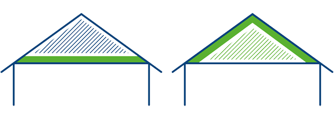

From how I read it you have a SIP roof as the below pic shows?
      COLD LOFT                      WARM LOFT
This means you have have a "WARM LOFT"??
In this case all the ducting will be inside the "thermal envelope" and even if you have no radiators up there and will be fine without insulation.

Thanks for the reply. Yes that's exactly what I will be having. I'm in contact now with a supplier who will be designing a scheme and will ask for their thoughts on this too. I'm thinking where I am proposing to run the ducts, the lowest triangle of space next to the eaves, I will be building a small skeiling wall anyway so can insulate them with rockwool or such like anyway. thanks again
