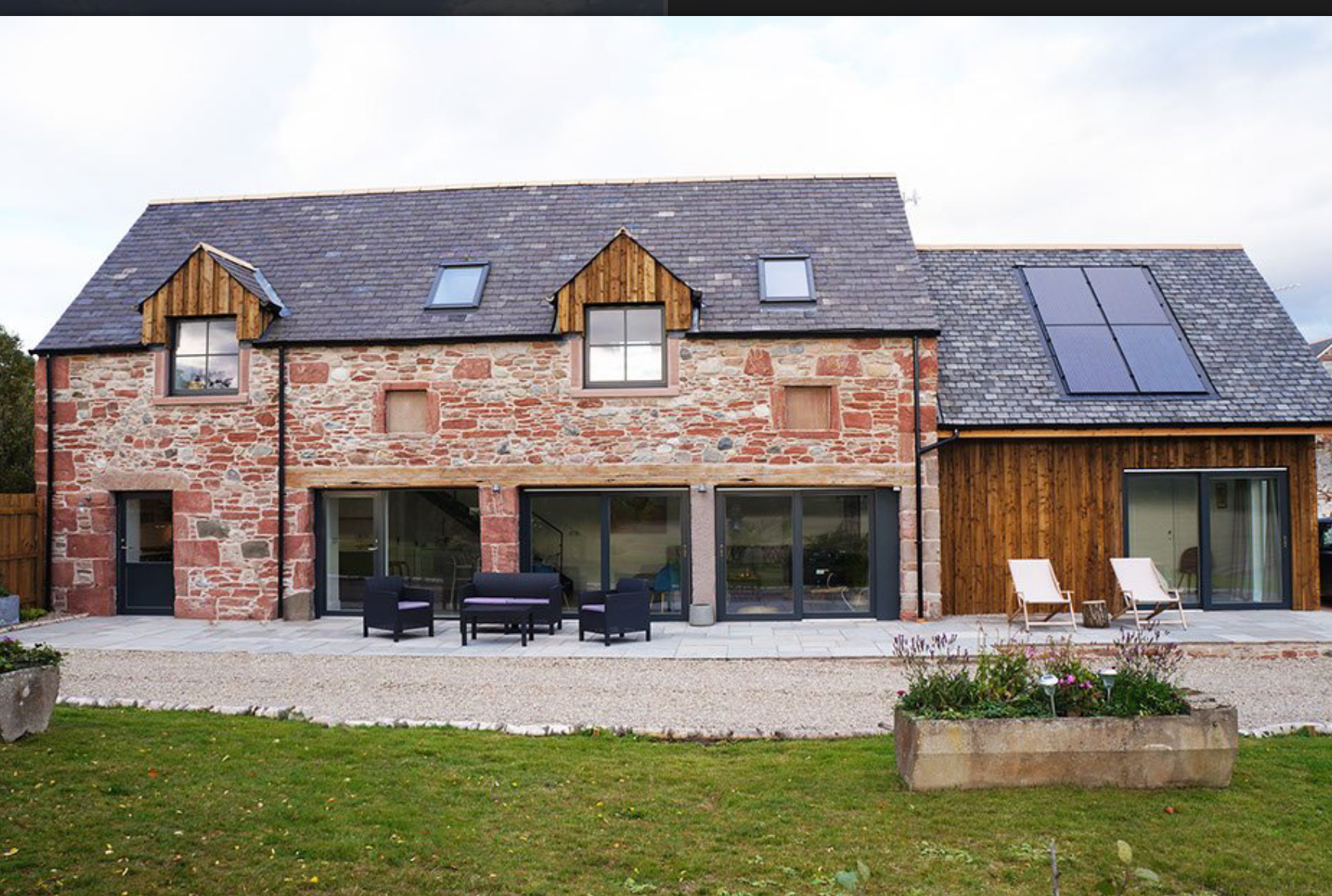

Bozza Posted January 29, 2023 Share Posted January 29, 2023 I think you’re meaning that you are unsure how a long building would look with the lean to, if you have the roof line the same all away long. As in it would be “too long” as it’s a low building. Your drawings make reference to cladding and stone. with long building it’s easy to break them up by changing the roof height slightly and a change of material. Like in the picture attached. Well placed planting can do that too, break up a long building. apologies if I’ve misunderstood your query. Link to comment Share on other sites More sharing options...

Somersetcider Posted January 29, 2023 Author Share Posted January 29, 2023 11 minutes ago, Bozza said: I think you’re meaning that you are unsure how a long building would look with the lean to, if you have the roof line the same all away long. As in it would be “too long” as it’s a low building. Your drawings make reference to cladding and stone. with long building it’s easy to break them up by changing the roof height slightly and a change of material. Like in the picture attached. Well placed planting can do that too, break up a long building. apologies if I’ve misunderstood your query. Thank you that’s perfect! Exactly what I meant. I hadn’t thought about a change of material/switch of cladding direction on the end parts would help to break up better. I was already thinking to have a difference in roof height if I went over to a pitch roof. The thinking is it would make it look less of an afterthought and modernise the building a bit? Link to comment Share on other sites More sharing options...
Bozza Posted January 30, 2023 Share Posted January 30, 2023 3 hours ago, Somersetcider said: The thinking is it would make it look less of an afterthought and modernise the building a bit? Yeah if you look at my house on my profile page. The timber clad section with the lower roof on the left. That was done like that because we felt if it was all one height / same material it would look too long and bland. Also balances the timber with the prominent elevation to the right. Link to comment Share on other sites More sharing options...
