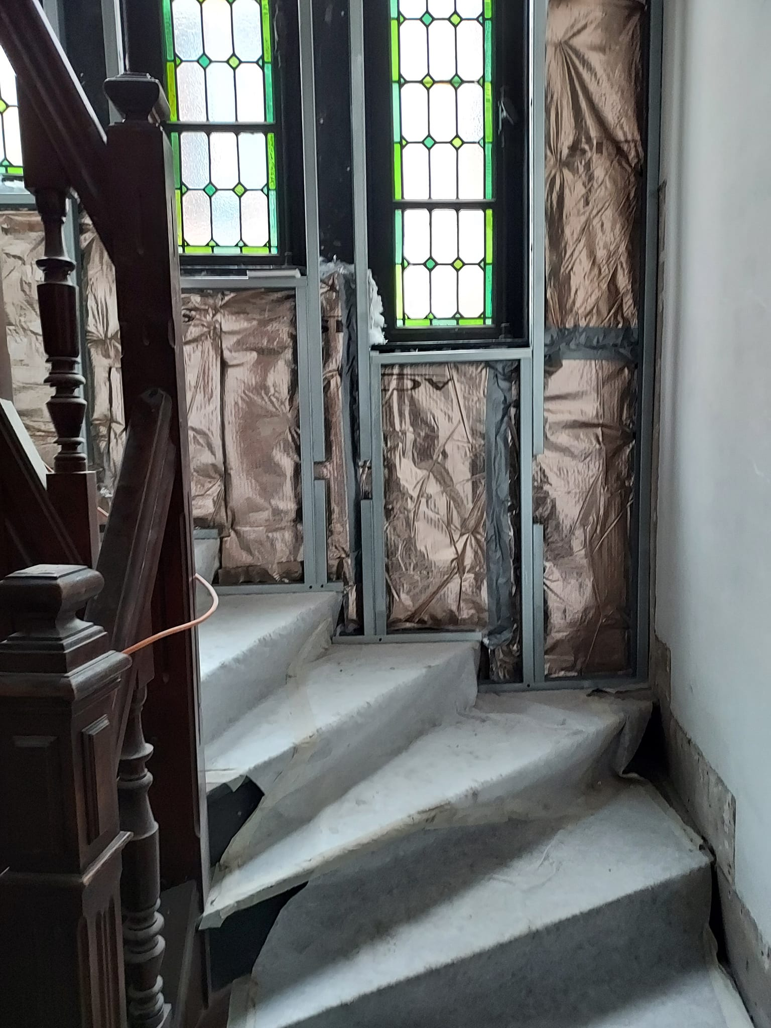

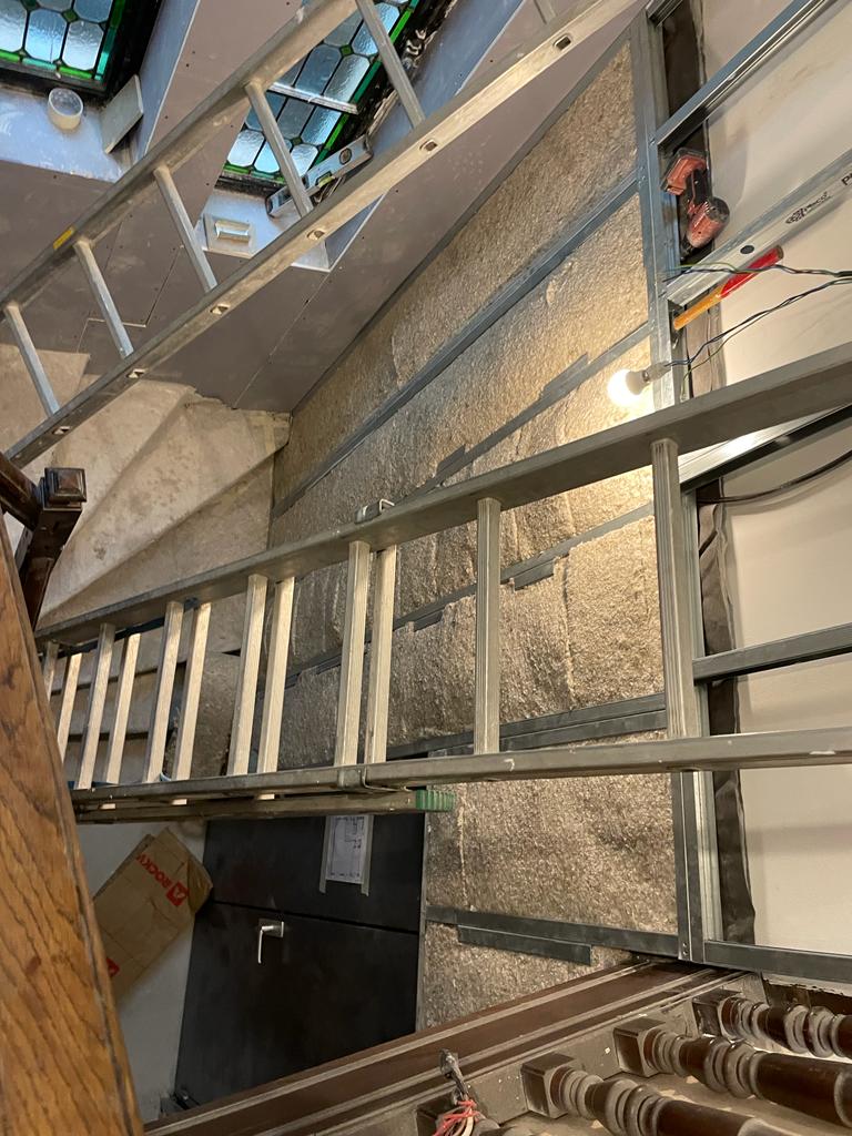

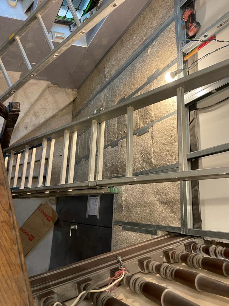

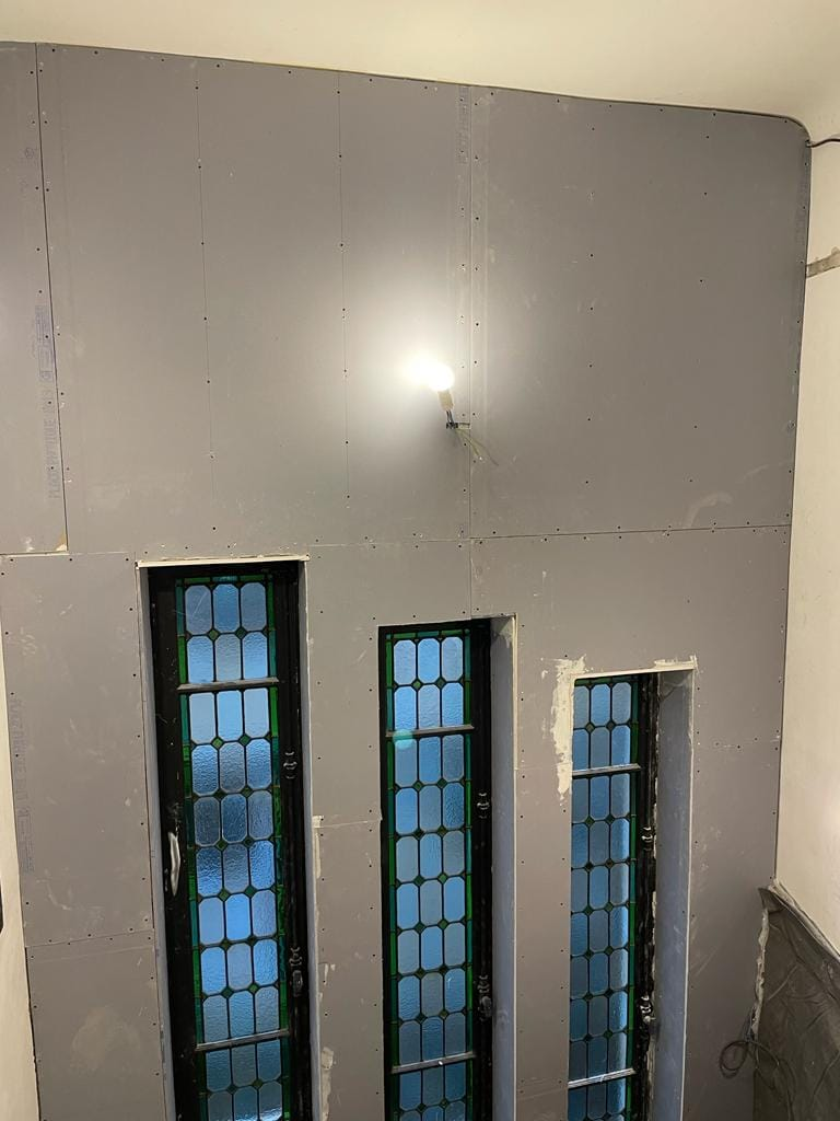

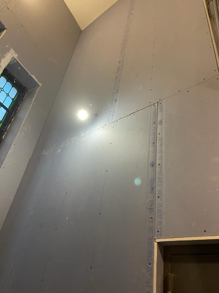

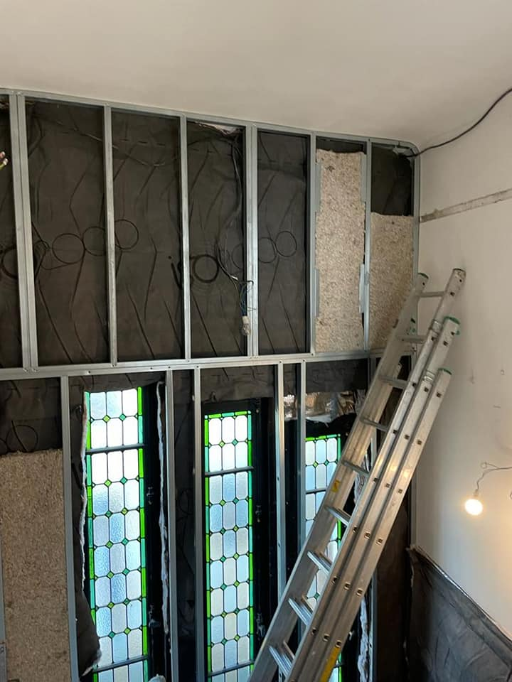

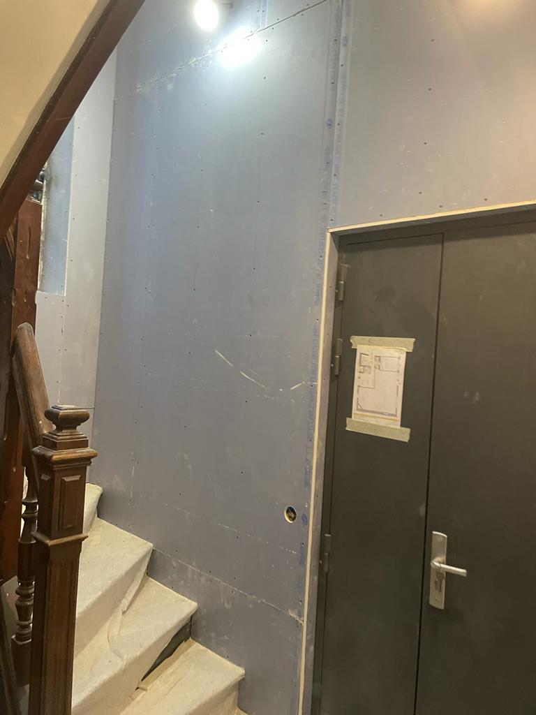

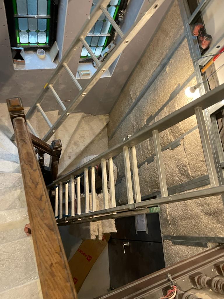

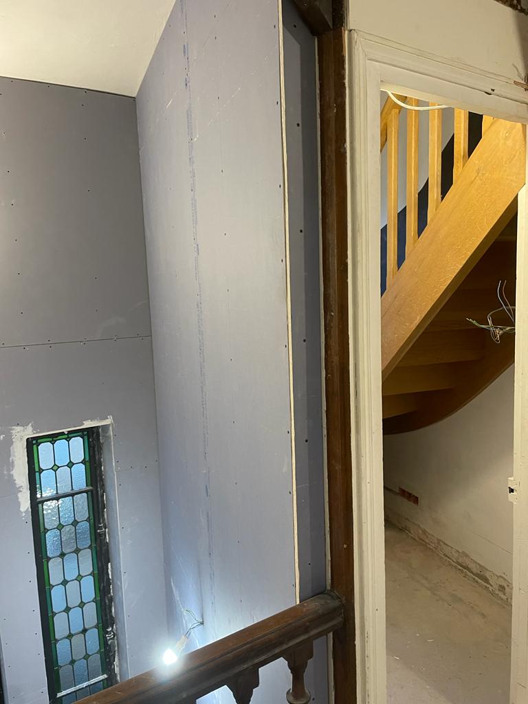

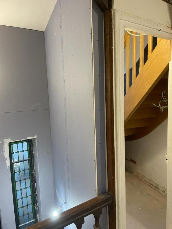

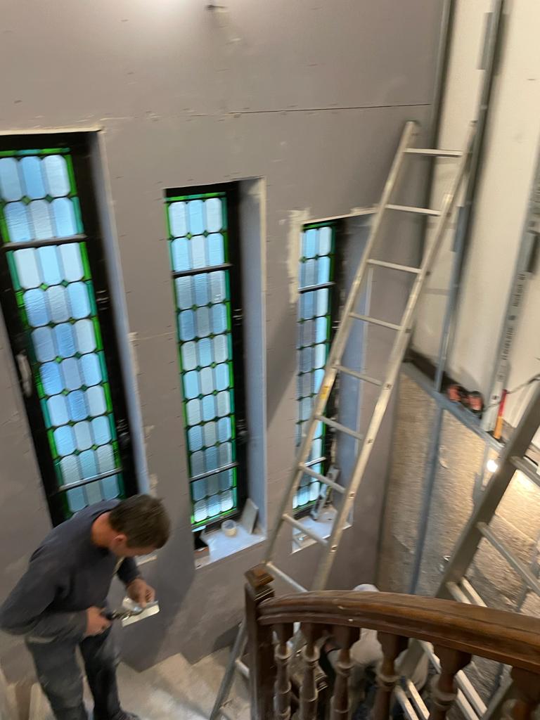

Insulating a big staircase (pictures/just for fun)
ISOLIN HPV  (reflective insulation) + 45mm Biofib Trio + hygrovariable vapor barrier (Proclima) + 13mm fireproof plaster
