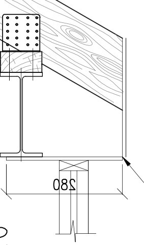

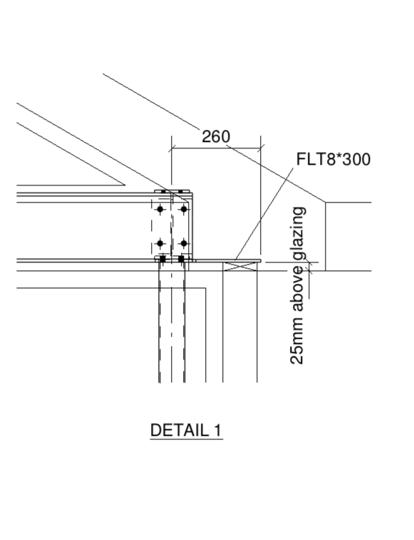

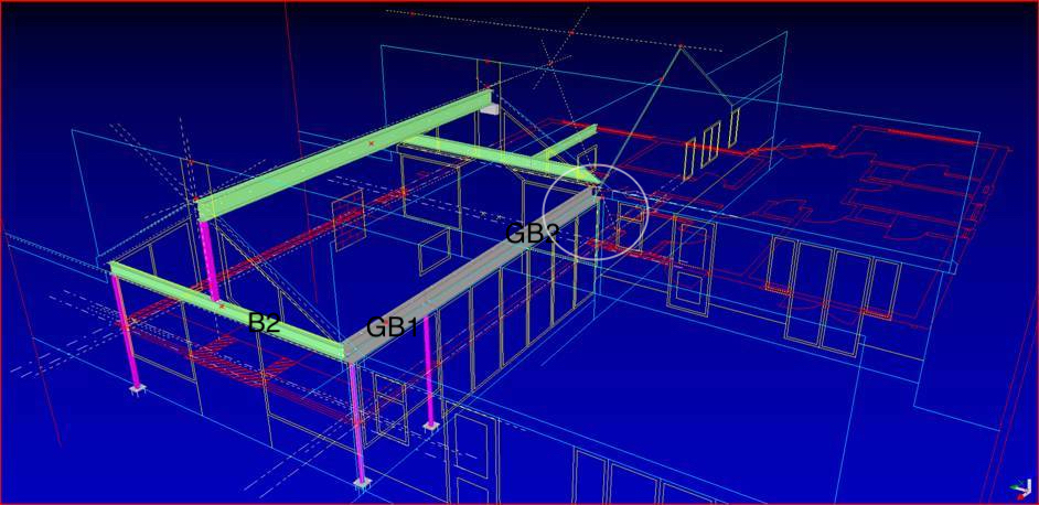

Steel Beam 8mm bottom plate alignment with soffit allowing for (packing/insulation- how to fix?)
mixermike
Steel Beam bottom plate alignment.
Fabricators draftsman has allowed 25mm above adjoining soffit for packing/insulation.
My question is how is insulation or packing fixed to steel plate???? to level up with existing soffit.
Any comments welcome, Thanks
